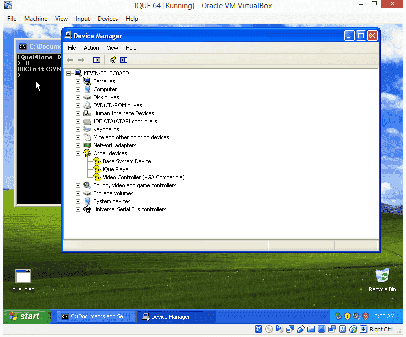

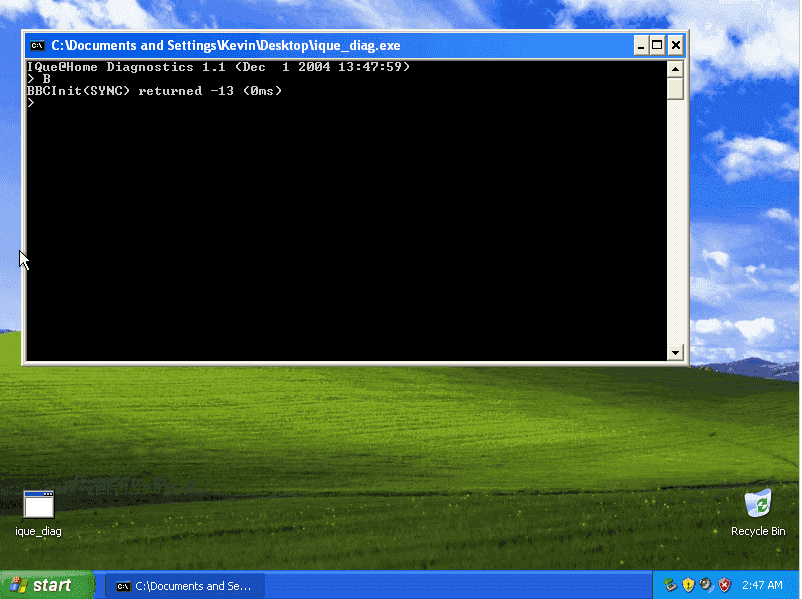

Im on a 32bit vm and this happens when attempting to read the ique in the iquediag.exe
the ique shows up on plugged in devices
not sure what to do now
View attachment 109302View attachment 109303
Did you try installing the iQue@Home from the CD? That should install drivers for it I think (but not 100% on that)
Not sure if the I@H from the net has those drivers, didn't seem to install them for me anyway, you can get the CD iso from https://archive.org/details/iQuehomeCDROM
