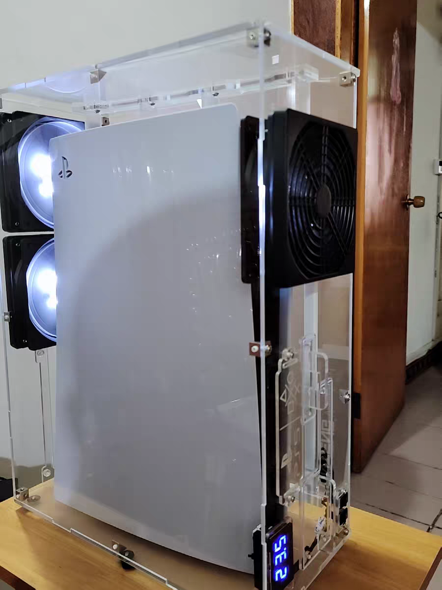

FYI, I saw the ultimate airflow solution A DIYer build a Acrylic case with intake fan and exhaust fans from China

Indeed this ideal works, but forget about those tiny fan blade product hanging on the back. They are small and no benefit to the airflow. Go for the PC build style 120mm/140mm quiet fan with adjustable speed control for the best performance.
