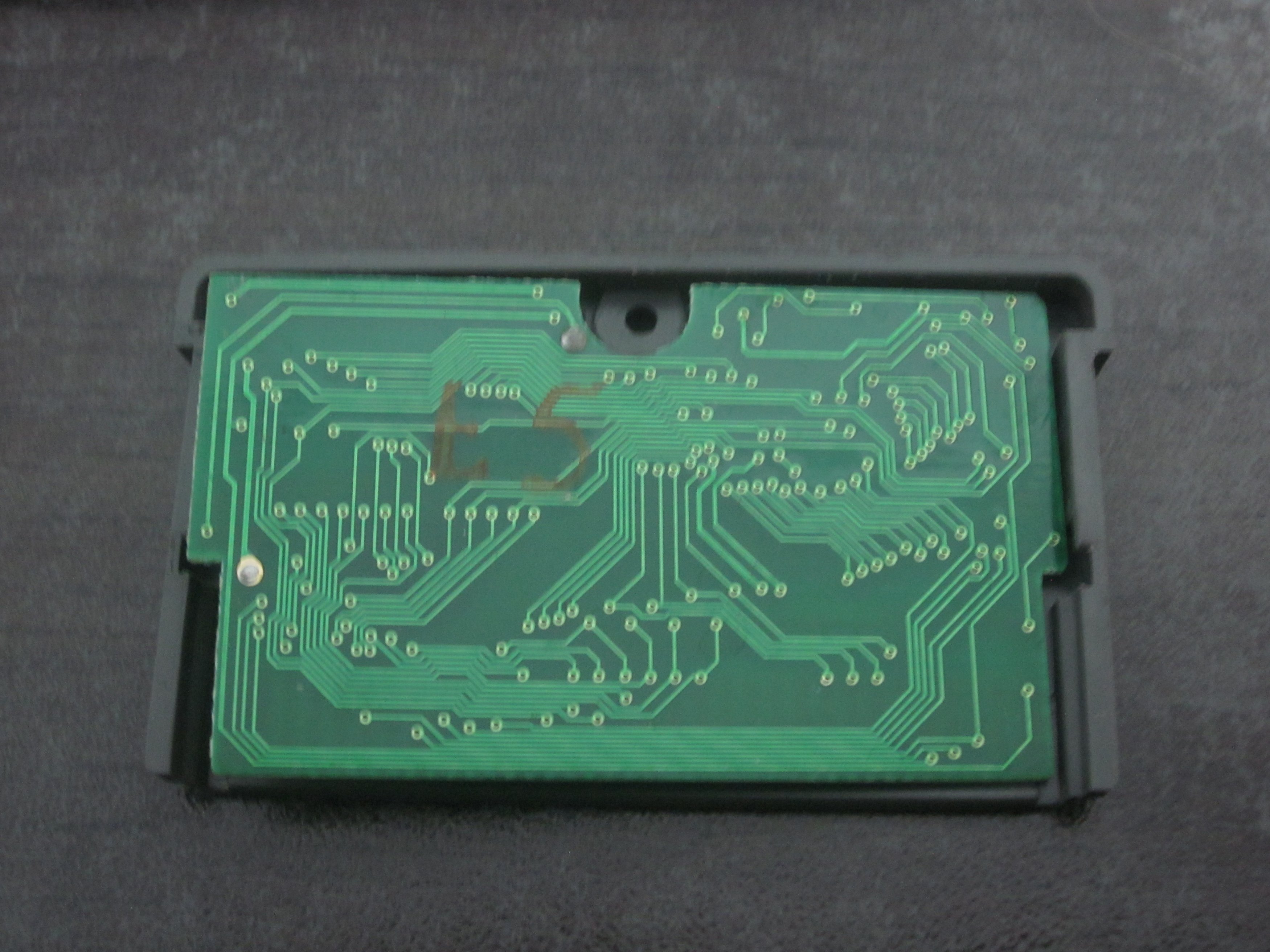

There's photos of the 227E board.
By the way, I have a problem with the 22FC, some ROMs write but some doesn't work when booted with a blank screen, but I think that's normal. But there's an specific ROM that either clean or patched for SRAM doesn't finish writing it and gets stuck at 50%, the only difference it's that's 16 MB instead of 8 MB, but it shouldn't be a problem with the cart because the original ROM that was in it is 32 MB and it rewrites fine. What could be causing that problem?

it could be possible that it has to write the full amount of the cart
try opening it in a hex editor and doubling its size with 0's and see if it works
this is just a guess tho
MarioMasta64
hi. i make batch stuff and portable shiz
Dec 21, 2016
2,297
26
github.com
2,106
It gets stuck at 25% instead, which is kind of the same I guess.
that seems to suggest its writing it half and half and changing which half it stores in, making 8mb go in one half and 8mb in another and so on(?)
just my guess tho based on how you say it
try an 8mb rom and see what happens
MarioMasta64
Dec 21, 2016
2,297
26
github.com
2,106
8MB ones work fine.
so if its indeed 32mb then yea it seems like something switches between 8mb memory sections during the writing process
idk how youd be able to tell how to make it do that but maybe markings on the chips might have clues :unsure: at the very least you can write 8mb roms at the moment

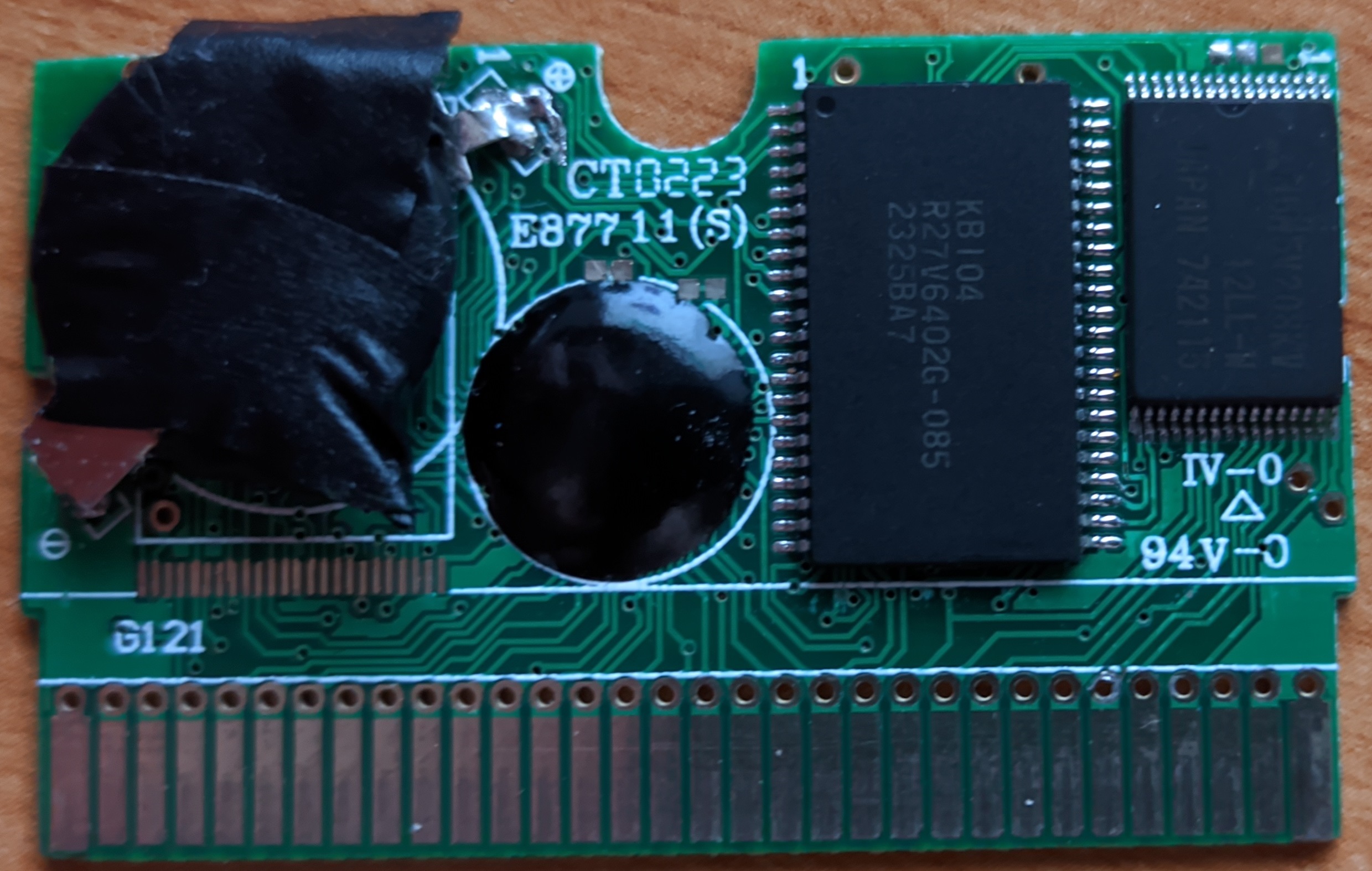

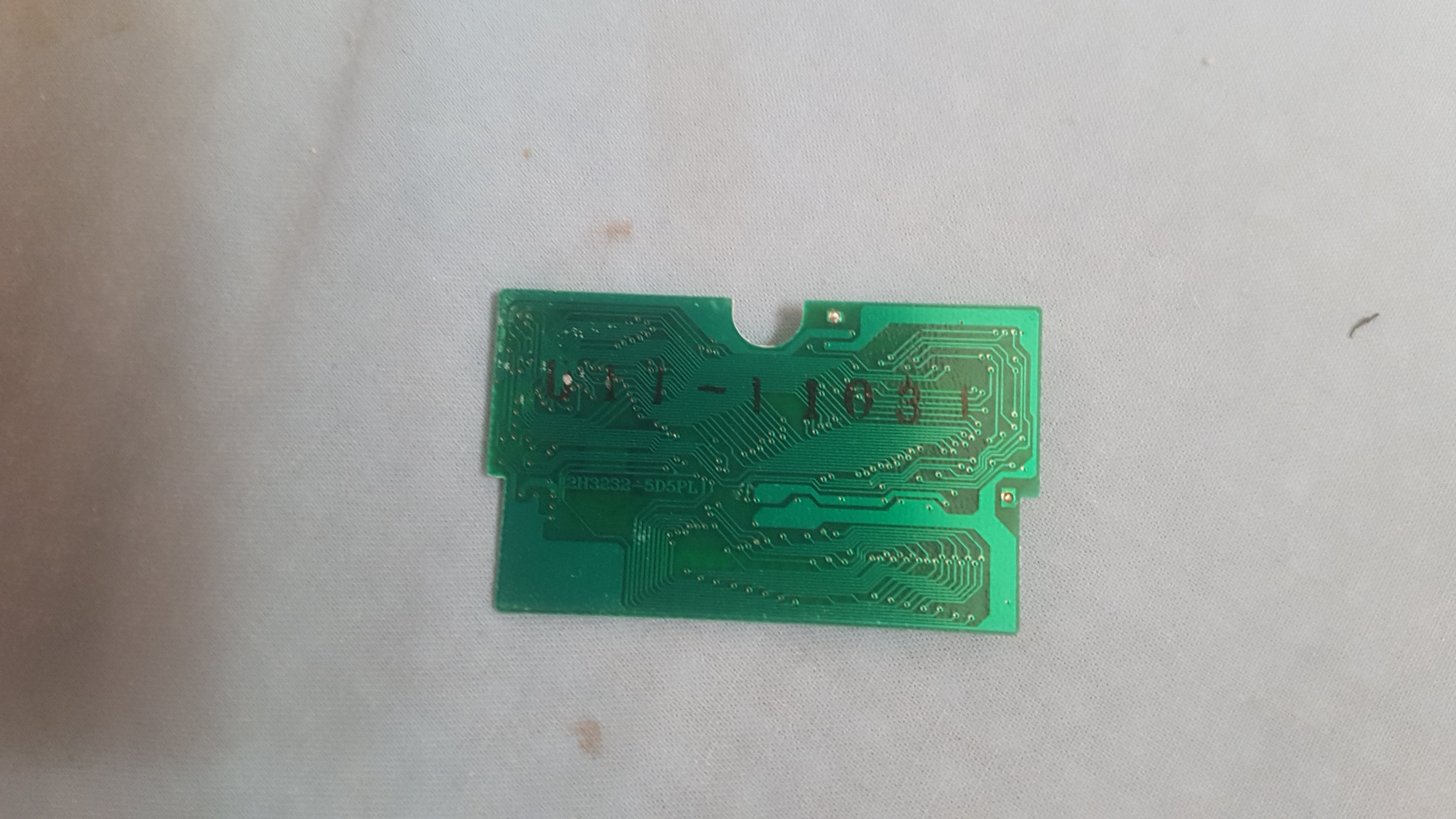

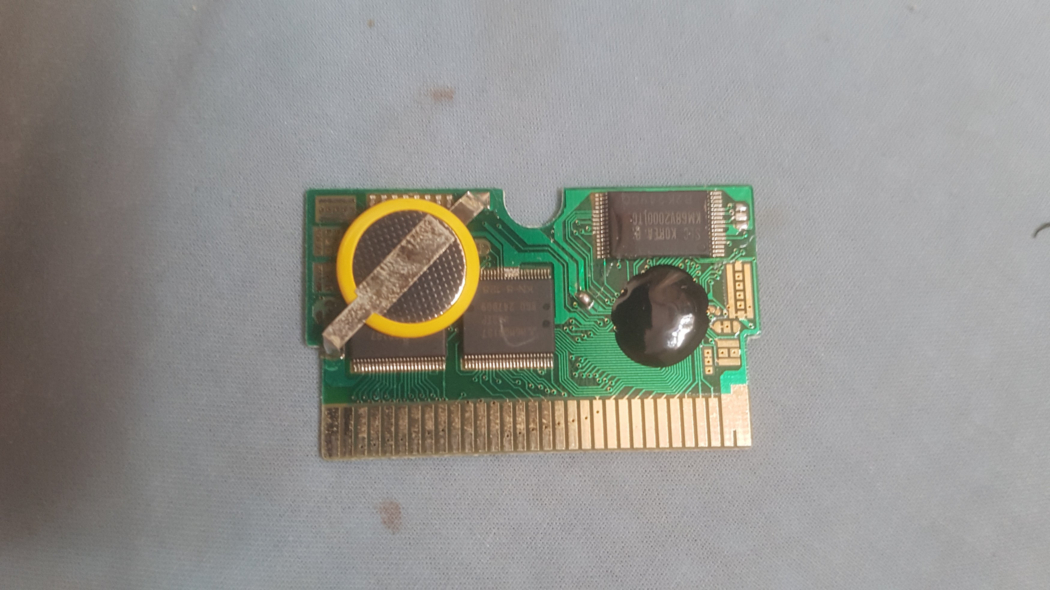

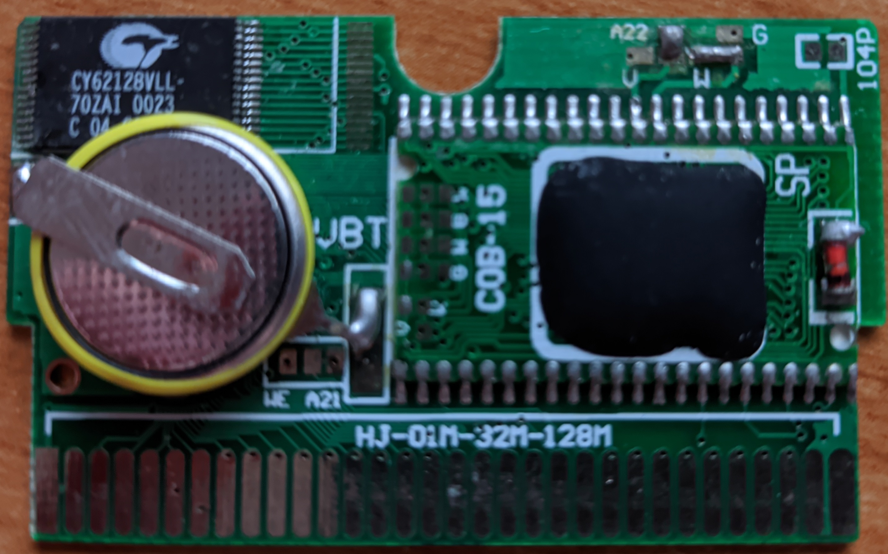

I have 4 working boards that are not recognized by the tool (Error Unknown Flash ID 0000). Can they be supported in future?
I'm not sure can be 2, 4 add support yet, may be it can be modded with solder points for rewrite activation.
Reactions: banjo2
geo-kun
Jul 27, 2012
40
476
Thanks for your answer! Any idea what do I need to modify to test this? I can see that "W" solder point on second board is bridged, should I try to unbridge it?
And what about boards 1 and 3?
Reactions: banjo2

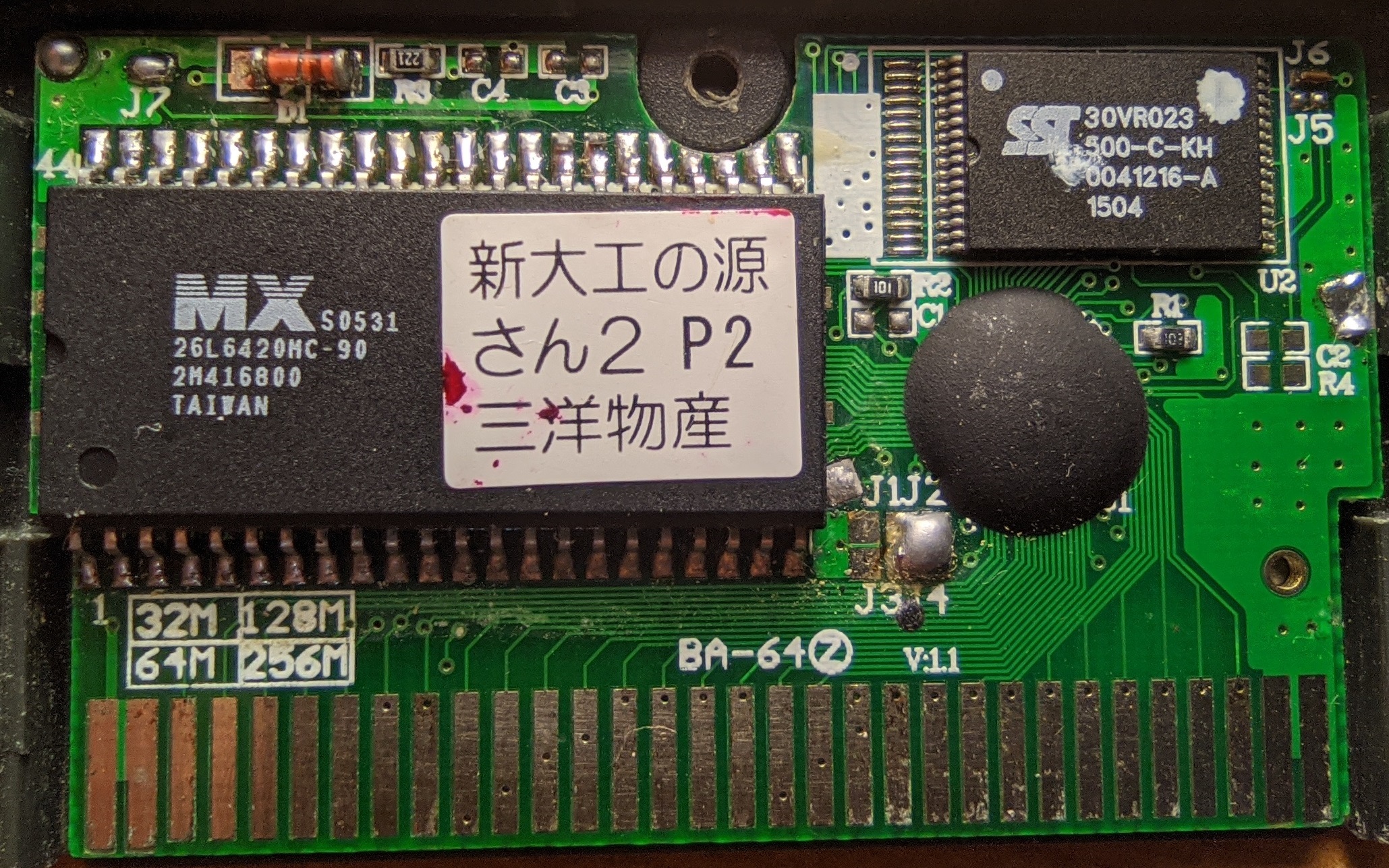

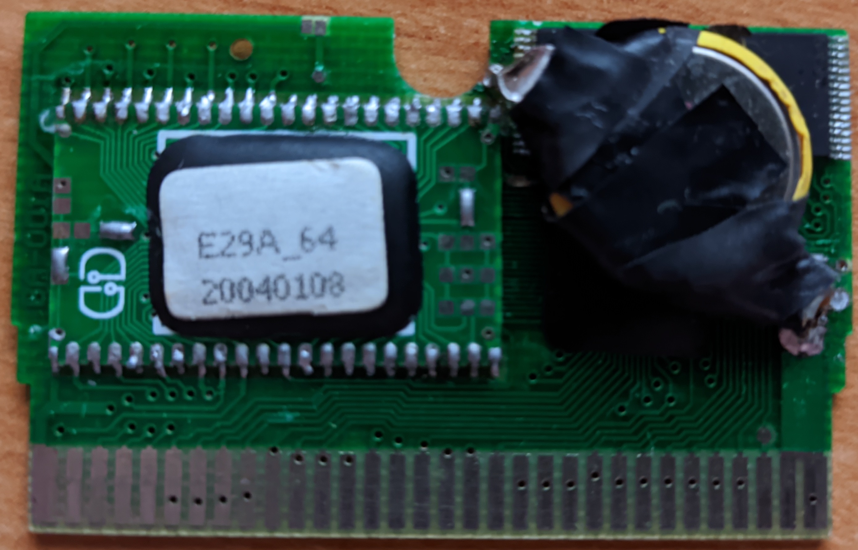

Just found this GBA bootleg cart for less than a buck, tested It with your app and it failed with an unknown ID 0000. Do you think it could work? Thanks!
yes it's work on test build, release it soon
first should work, may be it work on next build that will be soon

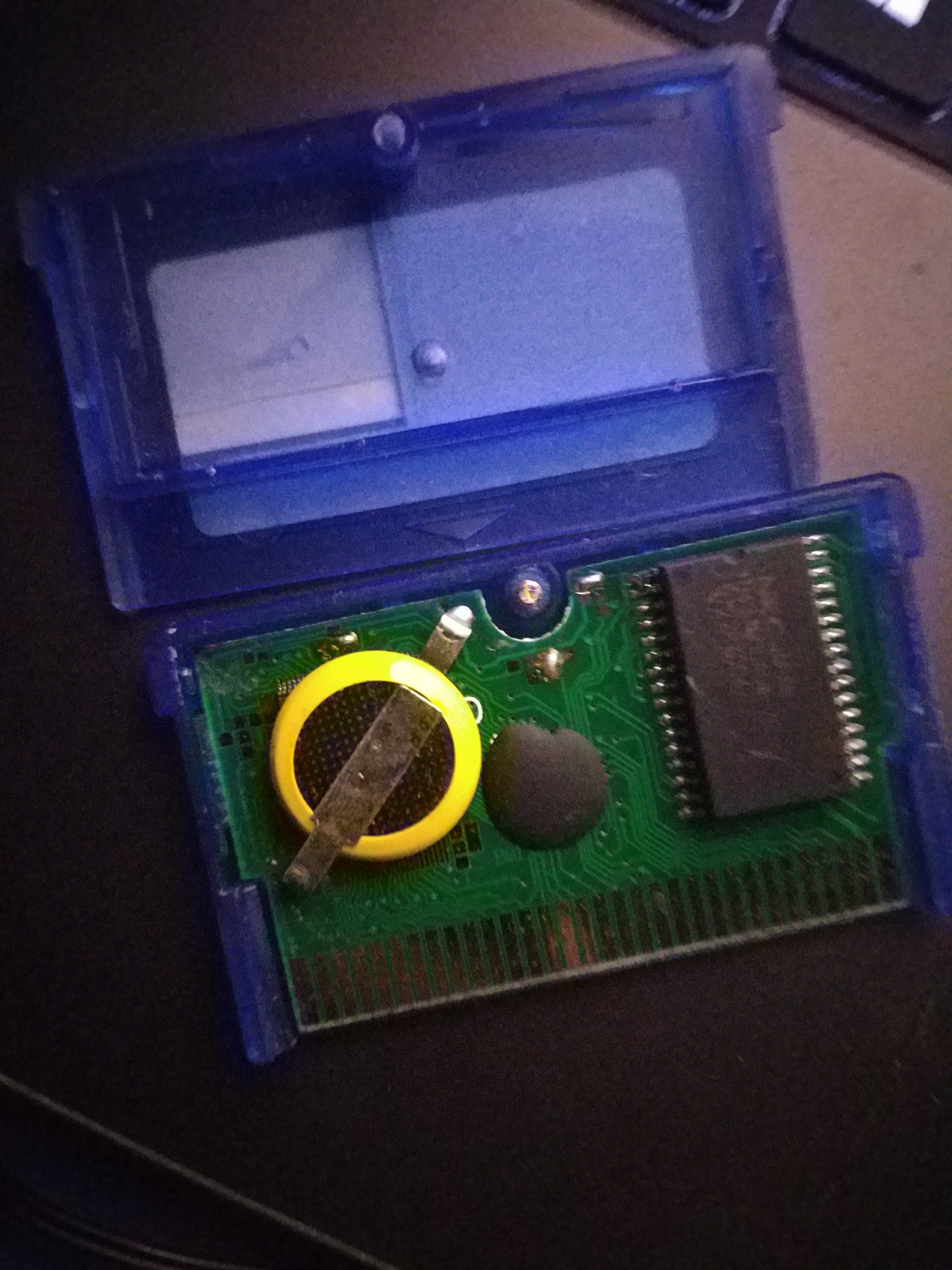

I'm no expert in spotting bootleg carts, but I know that this one gives a 0000 error on the latest build. No idea if it's familiar.
