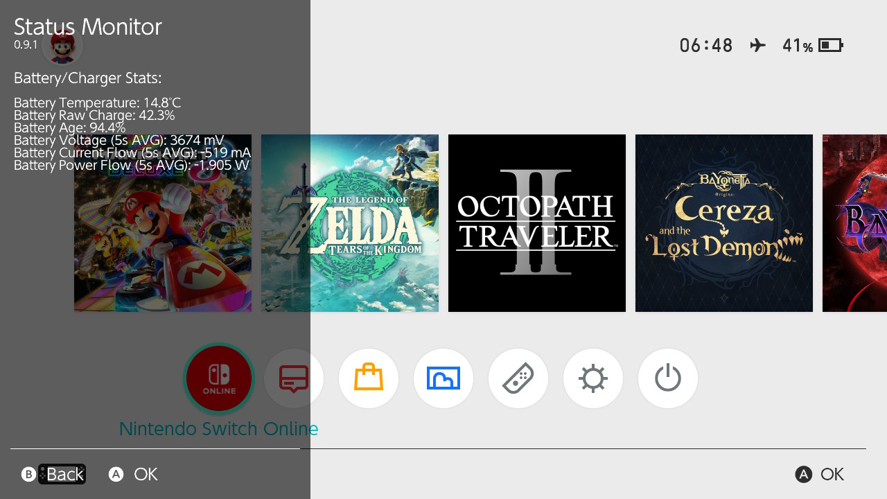

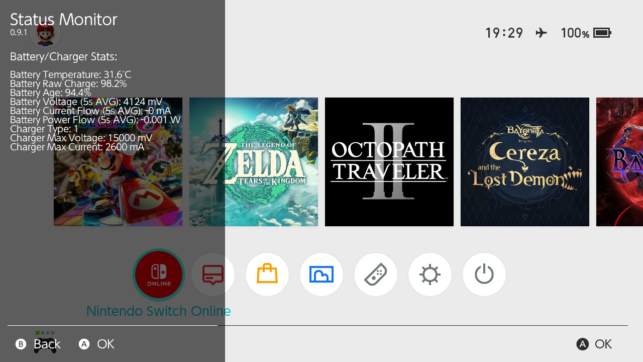

So that means that the battery charges to 94% of the maximum capacity before charging stops and the Switch battery gauge displays 100%. To my understanding you want to battery to remain between 60-80% to maximise its lifespan so 94% is still too high.
2023090506485700-57B4628D2267231D57E0FC1078C0596D.jpg2023090519295000-57B4628D2267231D57E0FC1078C0596D.jpg

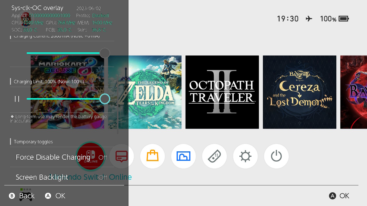

sys-clk-oc overlay has this feature in Miscellaneous setting
https://github.com/rashevskyv/sys-clk-OC
Found it. Given that it says "Long-term use may render the battery gauge inaccurate!" it looks like a lose-lose situation whether I set a charge limit or not.
View attachment 392240View attachment 392241
I would rather having wrong battery gauge than replacing it in short period cycles especially when switch in dock mode for most of time.
