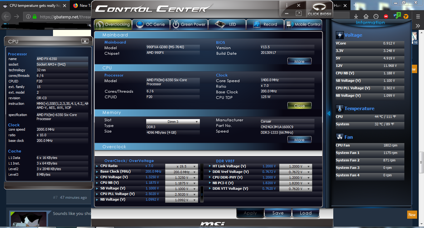

Again, problem is not high temperatures or high usage, it's that the thermometer reads high temperatures even though the case feels pretty cool to the touch (even directly touching the heatpipes is only "warm-very slightly hot" even though they supposedly should be at 55+°C when the problem happens). Anyway, here's the full breakdown to save trouble troubleshooting:
Those are the values when PC is idle with just browser open and 4 tabs. To save on power consumption the CPU ratio clocks down automatically to minimum required (x7 being lowest it can go) with the x19.5 being the max multiplier under full load before the built-in auto overclock for when at full load (which gets it up to x21.5). It's really not because of power management or usage, just the moment the CPU gets stressed even the tiniest bit temperatures shoot up for absolutely no reason! Also, like I said this has only been happening in the past two days, before that I had absolutely no issues! As for fan speeds, they go to about 3900RPM for the CPU fan and the other two go to about 1800RPM and 1180RPM respectively under full load. Also got two more MOLEX fans so they aren't shown since they aren't connected to the motherboard but they run at ~1200RPM each all the time. The CPU cooler by itself sounds like a wind turbine at full speed, add the other fans at max capacity too and it feels like my PC will take off any minute:rofl2:
