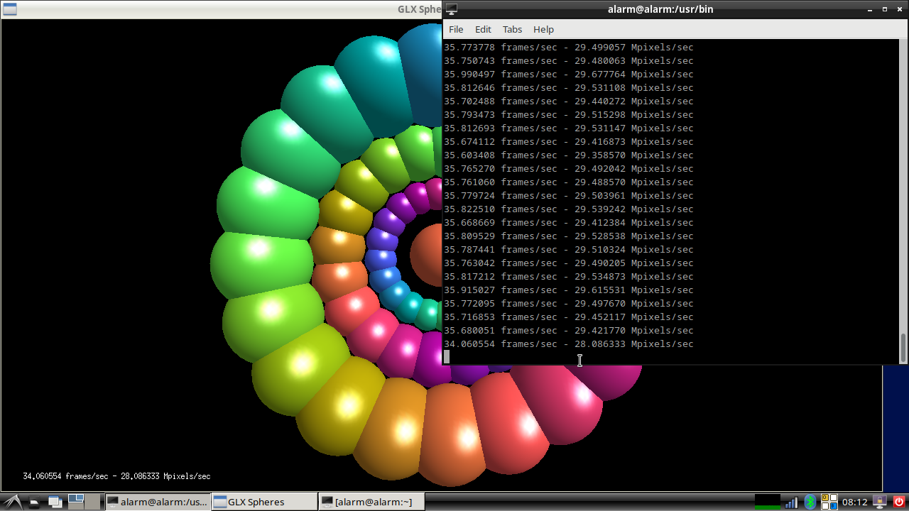

  • GPU acceleration : works (via mesa), with OpenGL (and maybe Vulkan too ?)

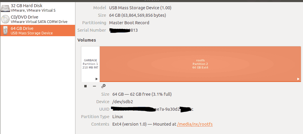

While it's downloading, you'll have to take a microSD card and, using the software of your choice (I used GParted) :
  • remove every existing partition to only have unallocated space on it (do I need to tell you that you're going to loose everything on the card ?)
  • create a tiny FAT32 partition (I chose 200mb but it doesn't matter) - that'll be mmcbkl0p1, you can label it "garbage"
  • create an ext4 partition on the remaining part of the card - that'll be mmcblk0p2, you can label it "rootfs"
  • it's important that the FAT32 partition comes first and the ext4 one comes after - on the Switch, Linux will look for mmcblk0p2, the second partition, if you have scrolling boot logs and then back to RCM it means you did it wrong

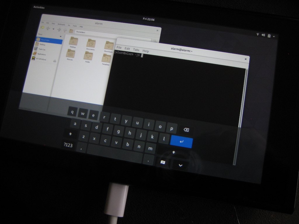

Some things I found while messing around:
* GNOME works pretty well, but you need to rotate the screen to the left otherwise it is in a vertical orientation. I did this automatically by putting "{ sleep 5; DISPLAY=:0 xrandr -o left } & gnome-shell" into the .xinitrc file. It also looks much better than LXDE and properly supports touch.
* The battery is correctly detected with percentages under GNOME, but LXDE didn't show anything (?).
* Using LXDE, to connect to a Wi-Fi network I had to connect to the network, then use nmtui to set the password, and then connect again.
* Some GNOME apps (such as gnome-terminal) do not work, and they crash with a timeout when run from the terminal.
* My Switch tends to randomly crash even when I'm not using bluetooth, and it seems it's more common when the battery is more drained and when I'm doing multiple things at once. Maybe it's like what Apple tried to prevent with the performance drops? Underclocking the processor could potentially fix this if this is the issue.
Here is a picture of GNOME running:
Huh funny, I am currently uploading my rootfs for gnome
