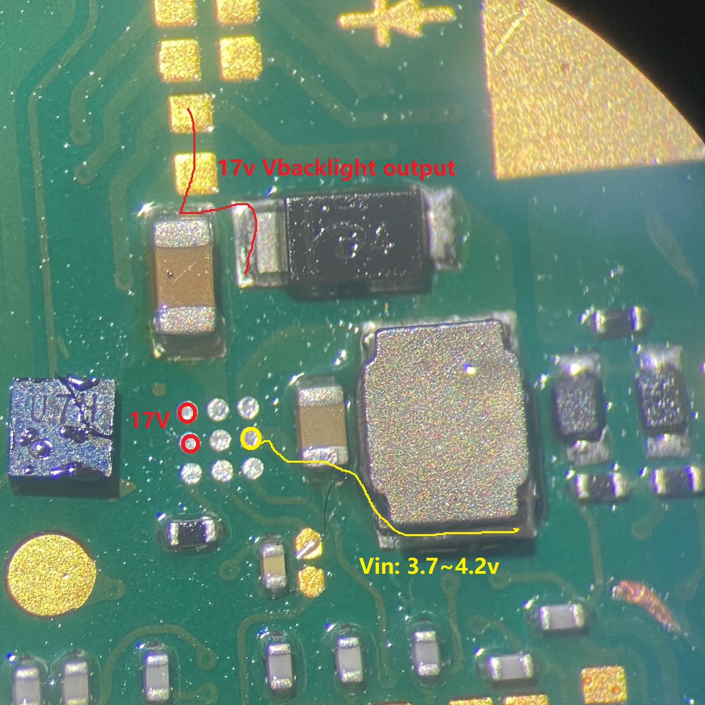

Hello everyone. I ran into a problem with the backlight on the Switch Lite-no 17 volts. The components are all in order - I moved them from working to non-working and vice versa. Now I am interested in a specific question - where is the 17 V that should go from the inductor. I measured on the working one, they are only already on the capacitor that is next to the diode. In the photo, I marked everything. I read all the topics on problems with the backlight , I did not find an answer to my question

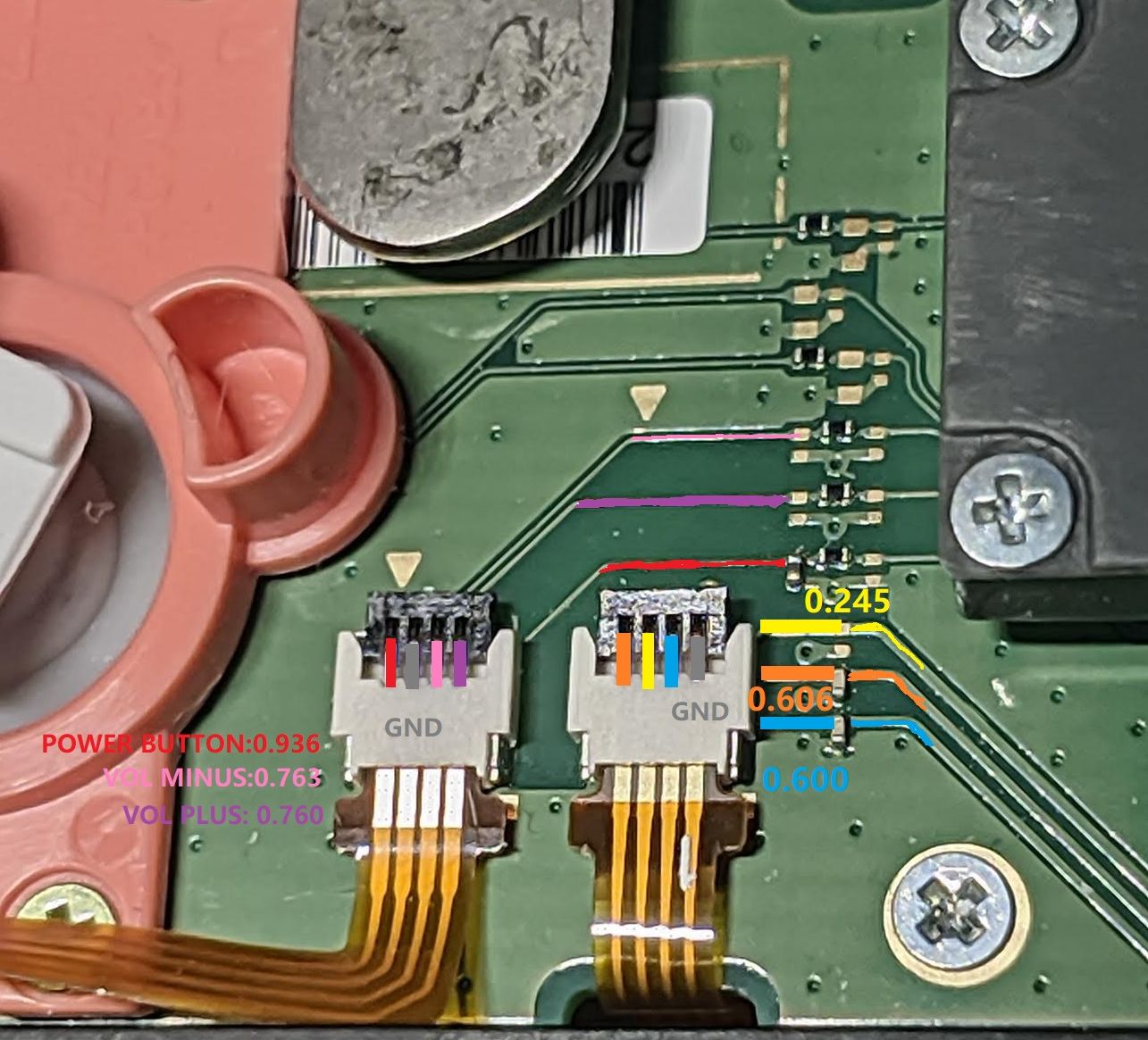

check backlight pins diode measure with both side daughter board extension cable connect.(NO battery or charger of course)
Often time if no connection to backlight socket, 17v will not generate

check the backlight ic datasheet.
the inductor has 3.7~4.2v vin at bottom pin. Top pin is SW pin
17v goes to the cap next to the diode as well as the test pad from the top(red lines)

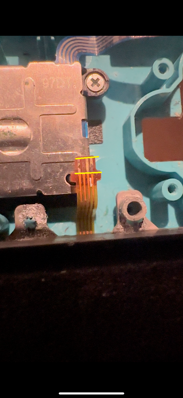

Thanks for your fast reply! First of all i would let you know that i am not a professional in this field and bought the defect switch as a kind of hobby :D
I measured the voltage with one pin on metal as gnd and the other one in the field (above them) and its smoked a bit :D but the switch is working as well... just the backlight has the fault.
Regarding the measurement on the daughter board i think it is necessary to have an microsokop or?
The attached pictures shows the cleaned backlight cable.. all of the conductor path works
clearly water damage and this backlight cable is bad
If you have a giant round prob lead, avoiding short-out the pins next to each other around any connector, i.e backlight connector. You may end up leading high voltage(17v) short through the pwm or signal pin burn out the backlight driver chip(since you mentioned smoke).
You could measure the backlight reading from the trace I marked on each color.

Thanks for ur reply! That means the backlight cable is totally damaged and can’t be use anymore?
Let me check the traces later
That's correct, unless you are capable to repair the broken traces on the cable.
I would just replace the entire LCD,because from experience you might end up having water mark left between LCD& backlight panel after you manage to repair the cable and everything.
