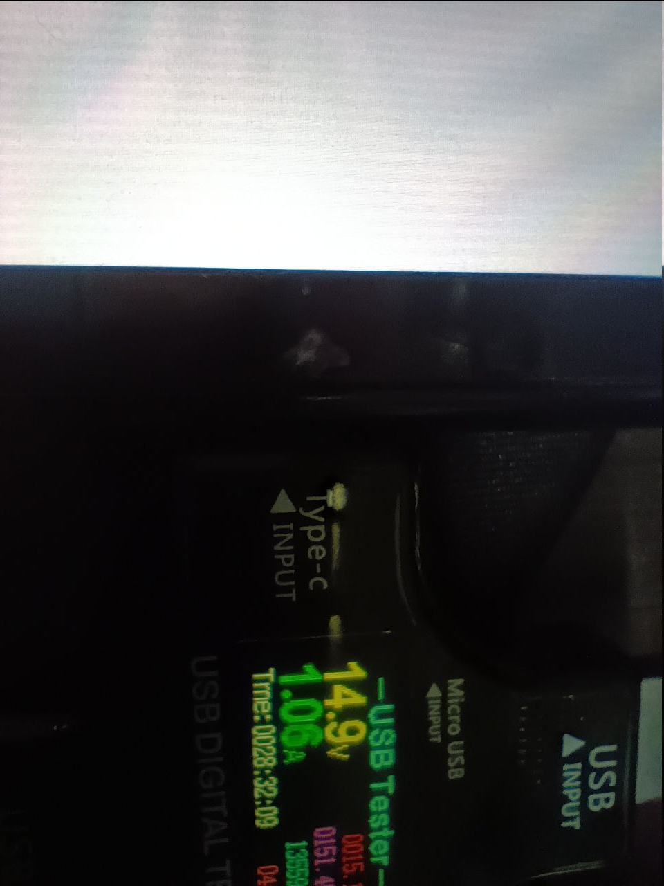

Hello, there, if battery is not full, on handheld mode the console can ask for 15V too:
