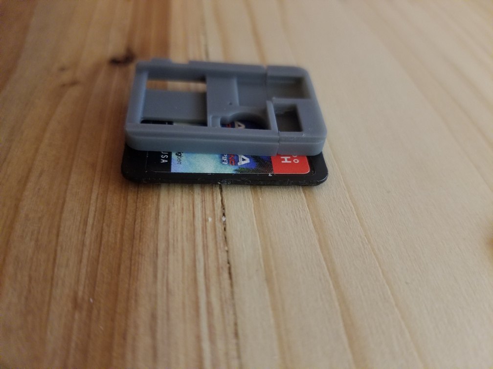

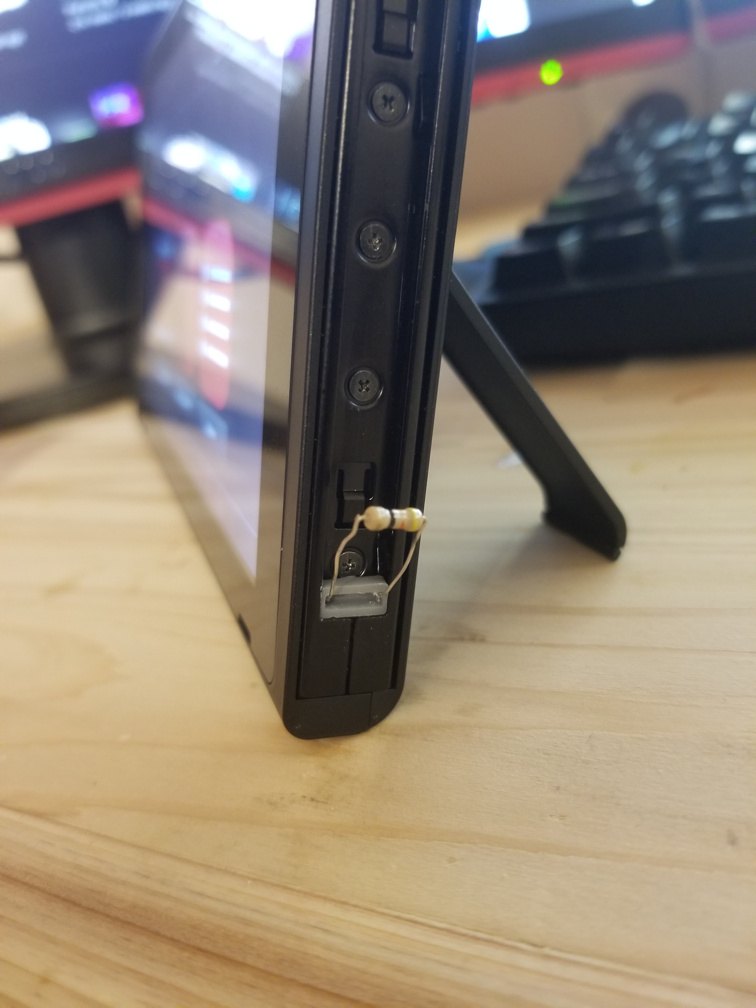

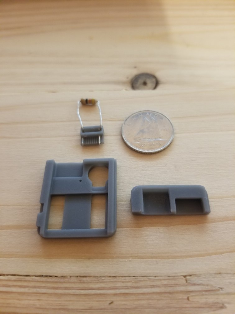

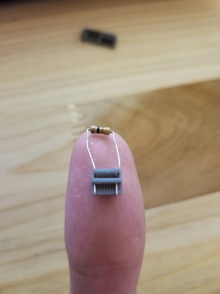

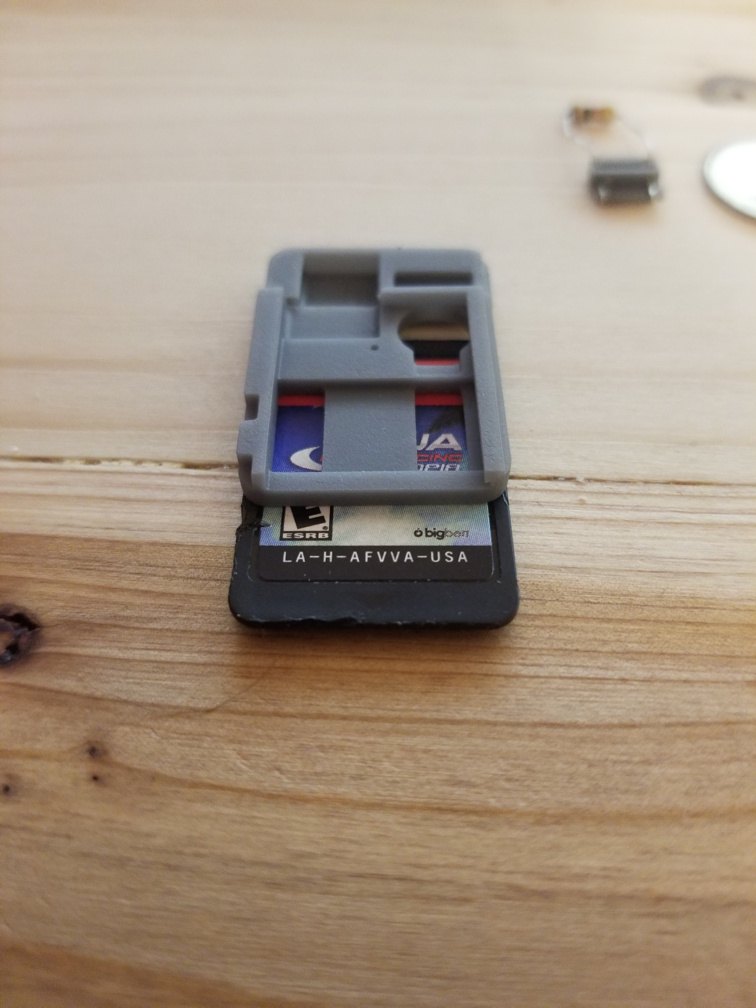

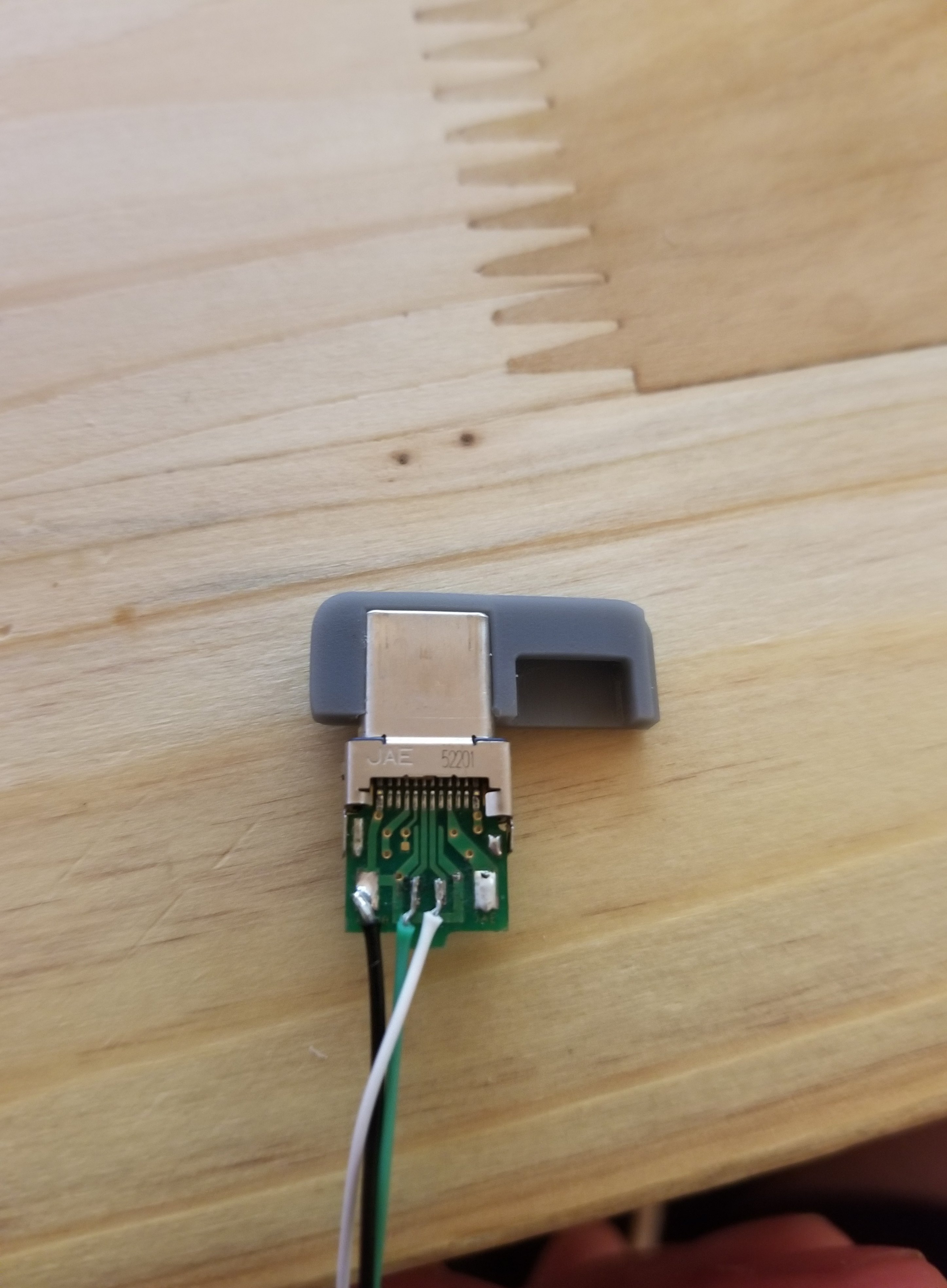

So, the nice mail lady arrived about an hour ago and dropped off a package - the prototype case! I have to say, despite modelling the thing, doing comparisons, wearing out my calipers and triple-checking all my measurements, I was not prepared to see it in person. This thing is tiny. I'm not one for grandiose claims, but I think this might just be the smallest RCM jig in existence. I couldn't help but laugh out loud when I saw it.
Anyways, the case looks fantastic. I've attached some photos below. I tested the jig as best I could since the 1/8W resistors it was designed for haven't come in yet. I took a 1/4W 43 ohm I had lying around and bent the leads to the correct shape through the holes, let it hang out so it wasn't in the way and made sure AutoRCM was off. Then I tried to get into RCM with the jig.
And... it worked great! Tried it a bunch of times (probably a good 15) with 100% success rate. Mixed it with a bunch of tries with the jig removed to be sure and got 100% failure rate. So I'm pretty happy with that. Made sure the joycon pins still looked the same and my joycon was detected etc. and all is good. Despite being miniscule, it's actually pretty easy to insert and remove and has a good feel when it bottoms out. So I'd say that's a success. I will be adding two little grooves into the cap where the jig goes for the final design as it doesn't fit when the resistor is installed (oops) but other than that it looks like no changes are needed. I even tested a USB Type C jack in the lid and it's super snug but fits nice. Shouldn't be any issues getting the cart out. Woo!
Also, for those who wanted to see if this really is the size of a Switch cart, I took some pictures of the case on top of (what's left of) an actual cart. Don't mind the thickness - I had to cut it open for some tests and it wouldn't go back together so it's just the lid in the photos.
EDIT: It's a little hard to tell from the photos, but that's a dime.
