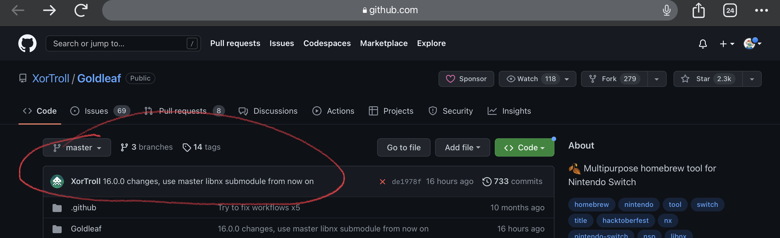

Looks like there is an update for Goldleaf and FW 16.0.0 in the works
https://github.com/XorTroll/Goldleaf
No new release yet though, so prolly need to compile yourself for now…
e: I just read through the change and it’s adding libnx and addressing the new changes in fs module, so yeah, those breaking changes from 16.0.0 strike again (but are actively being fixed very quickly by the Devs)
Ah ok, thanks very much!
Then this was basically my whole problem that Goldleaf is just not 16.0.0 ready yet :-)

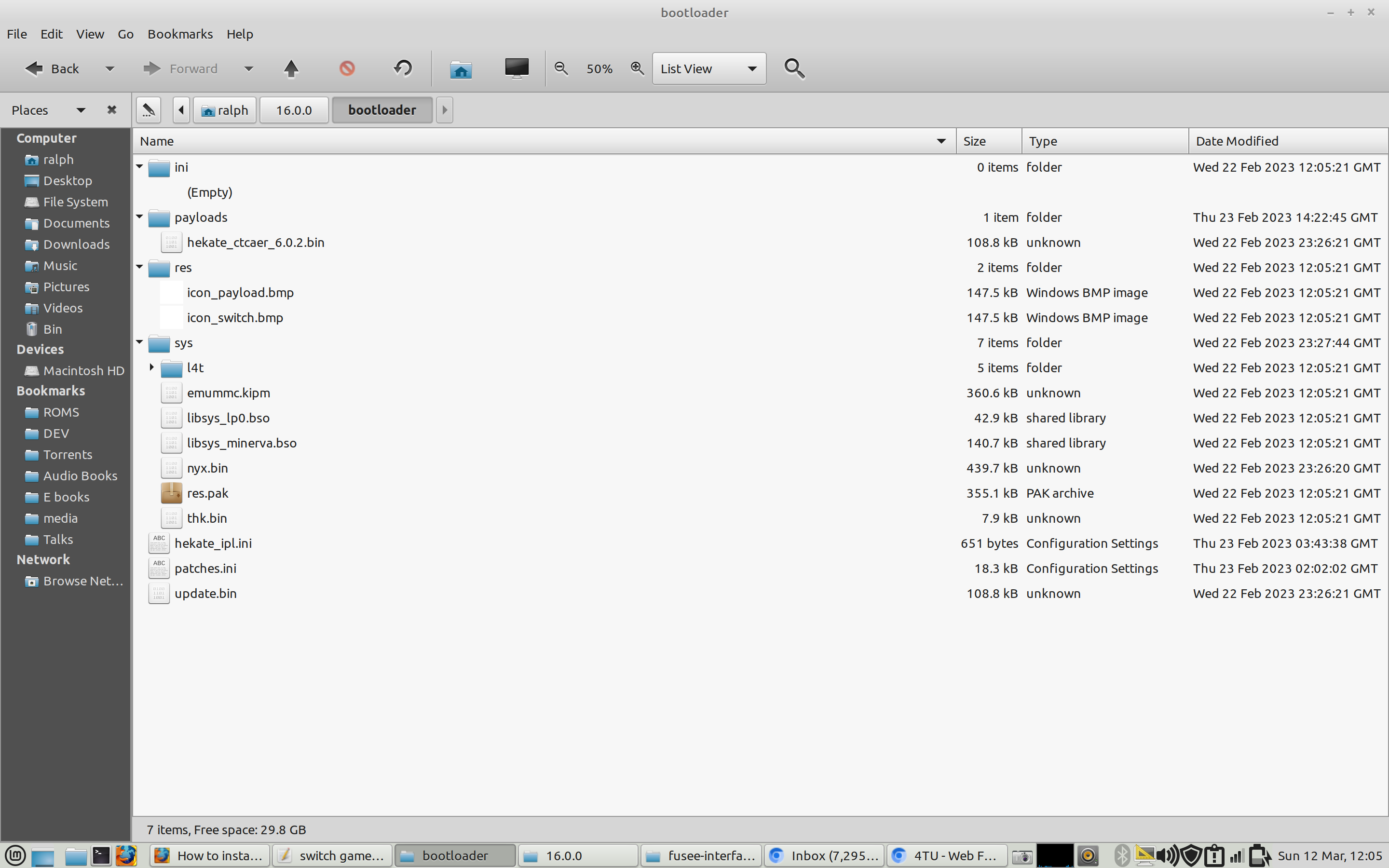

So I got a Sandisk 512GB SD card which I formatted to FAT32 using GParted.
I placed this lot on it;

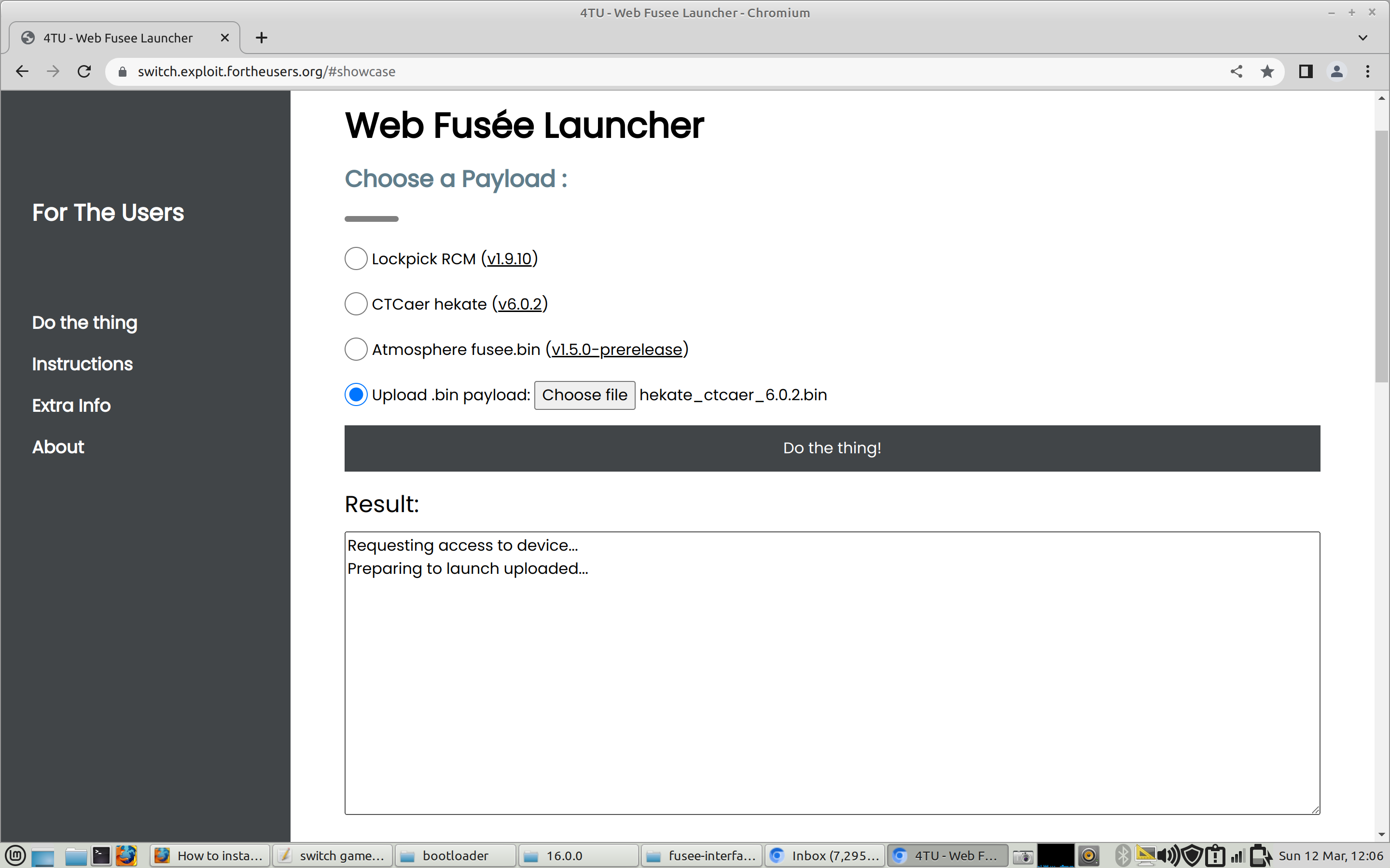

SD card went back in the Switch. I put it into RCM and connected it to my laptop via USB.
Now I'm running Mint 20.1 so I've tried both Web Fusée Launcher on Chromium and fusee-interfacee-tk-linux but although both acknowledge APX is there when I try to inject "hekate_ctcaer_6.0.2.bin" the Switch won't boot into Hekate as I'm led to believe it should.
I've tried two different USB cables but it makes no difference.

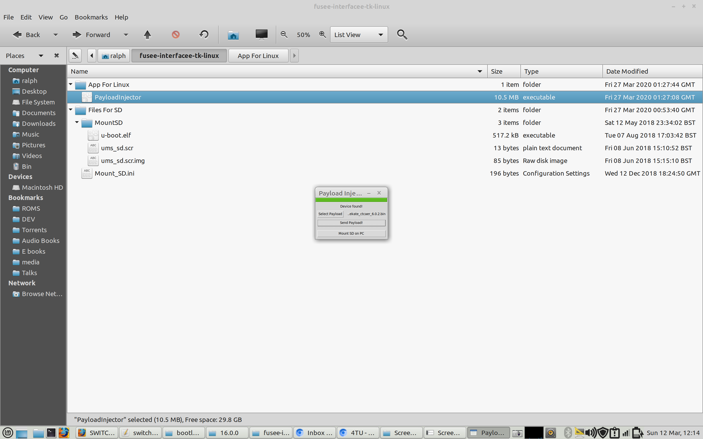

This is what I get with each programme. Both just sit there doing nothing.
fusee-interfacee-tk-linux;
Web Fusée Launcher;
I must be doing something wrong but I don't know what?

I feel your pain. I never could manage to inject a payload with Linux. On Windows 7, tegraRCMGUI works flawlessly on the same PC (dual boot PC). I always wondered what's the secret to succeed with Linux. I don't actually depend on it, since I have a few RCMLoader One injectors, but I would still like to know what's the problem. Can you link the two methods you listed? Maybe they're different from what I tried before.

I've just been playing with ns-usbloader and, having written a new udev/rule in accordance with the recommendation within the programme, it works!
This rule may well enable the previous two methods I tried to work too.
You can find ns-usbloader at https://github.com/developersu/ns-usbloader/releases/tag/v7.0
The ns-usbloader-7.0.jar version worked for me.
So my Switch is now booted into hekate! I'll be back when I'm struggling again, won't be long at this rate...
