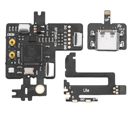

I just bought a Switch Lite V2 from eBay and a HWFLY RP2040 Lite chip from AliExpress. Today, the Switch Lite arrived and is currently at 16.0.3. I'm not sure whether I should update or not, before installing the mod. Any ideas, folks?
Hayato213
Dec 26, 2015
20,096
21,300
Firmware doesn't matter if you are using Modchip, after you install the Hwfly RP2040 Lite , do a NAND backup.
Alright, thank you @Hayato213. So should I start updating now or after installing the chip? Does it even matter which order I put this in?
