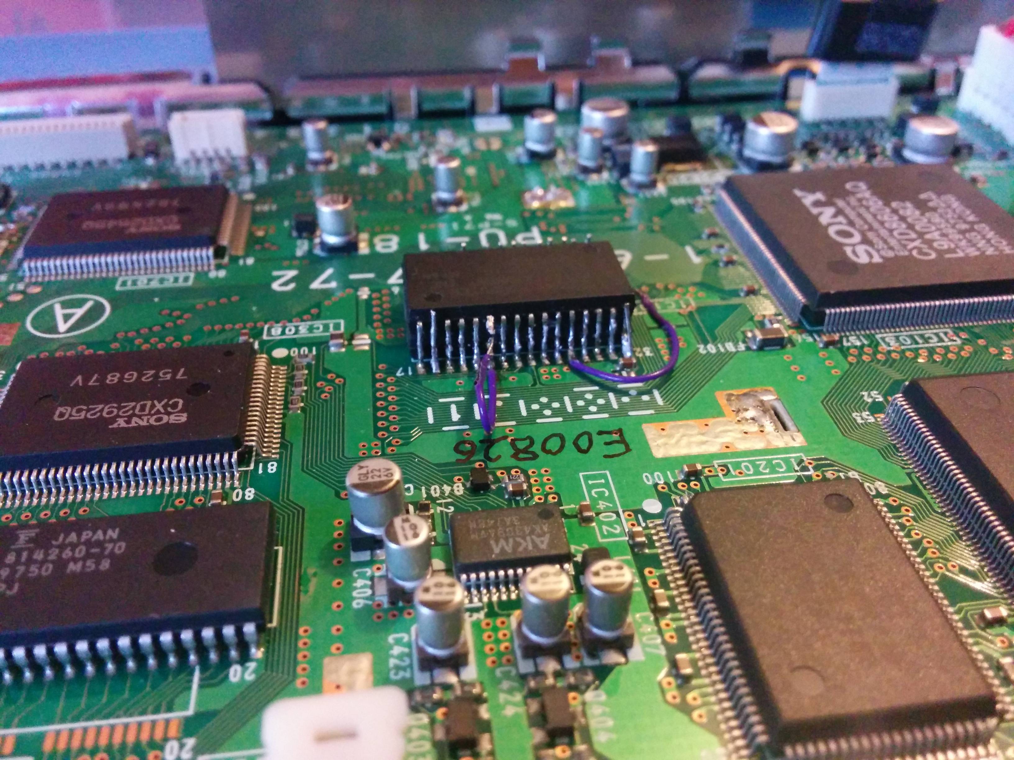

This is amazing but both of my PS1 are chipped. Is that printer port some Playstations have on the back useful for anything?

Exploit the cd player, to load code from the memory card
Or create a modded bios, that ignores copy protection
Kind of shocked nobody has attacked the bootrom yet, tbh...
I was thinking the same, either a bootrom exploit,or a custom bios replacement
You can swap bios between ps1 revisions, and will work, you can run a launch model ps1 bios on a psone slim, though with some simple patches (io port init)
I don't think the ps1 checks the bios, so you can just replace it with a flash chip,with a bios with no copy protection, using a flash chip, it can also be updated if need be
The only other way is to use in game exploits, since this is still the generation of consoles where game code is completely trusted,and can access and run anything
Plus with psnee I can just use a $3usd arduino
