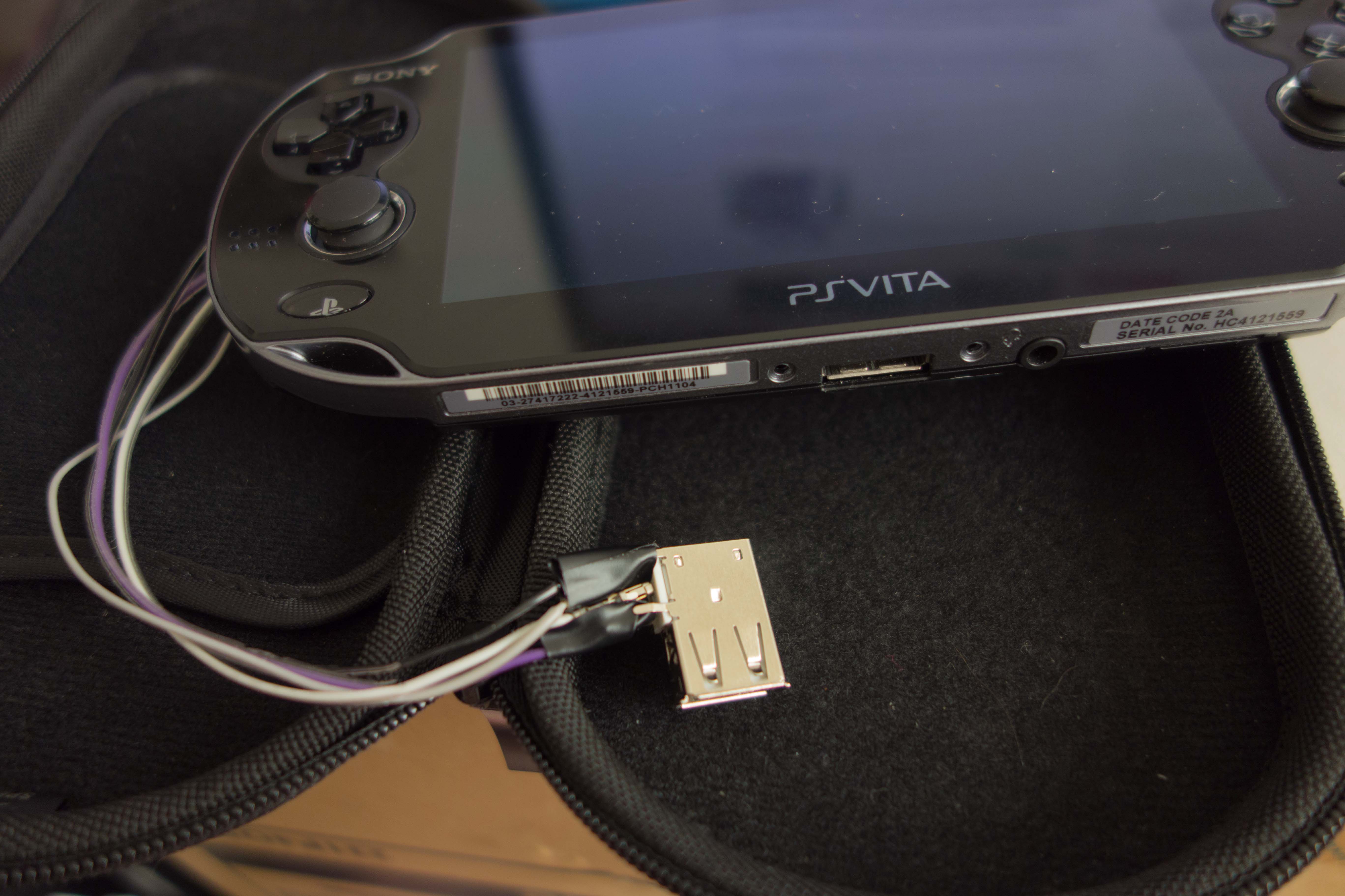

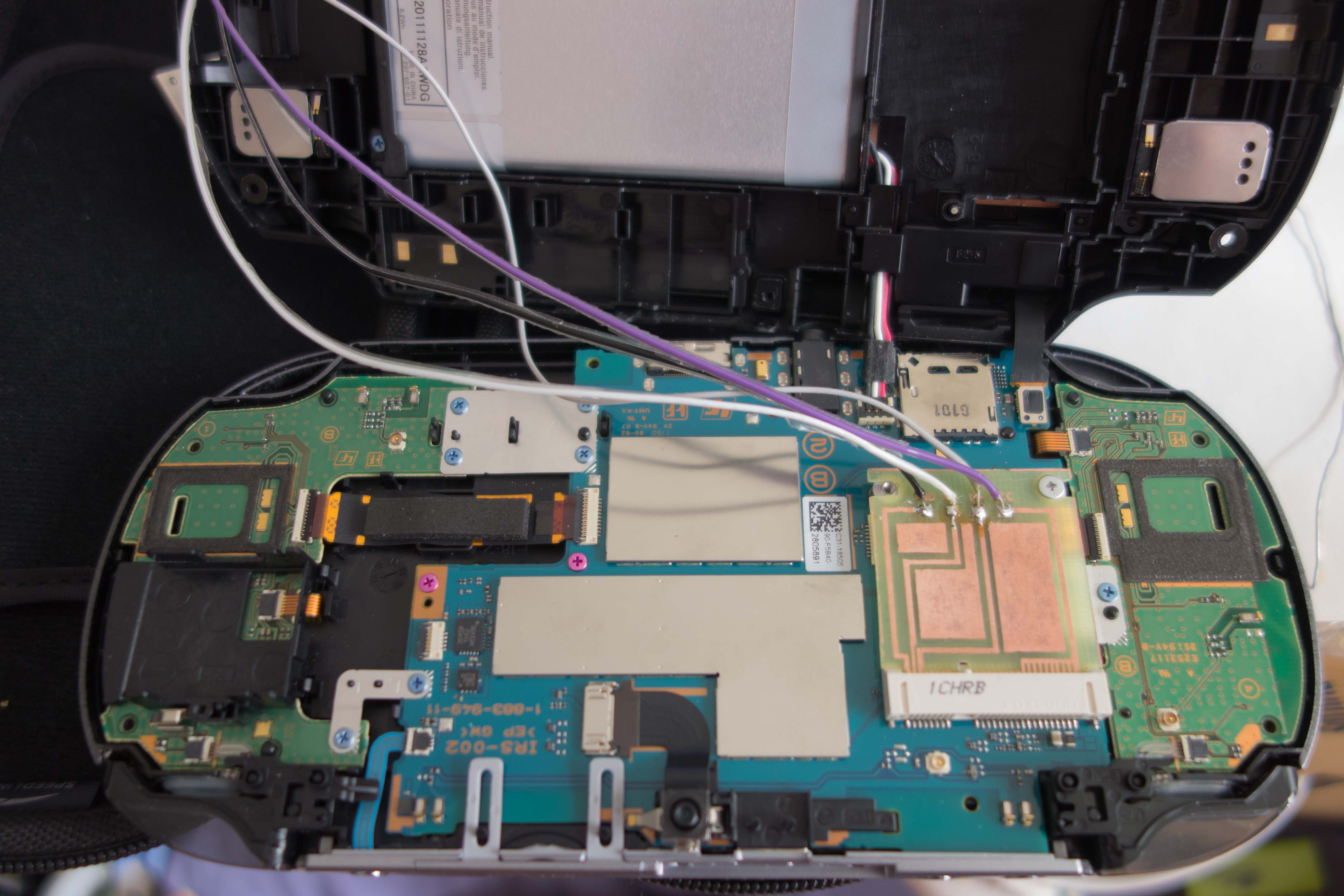

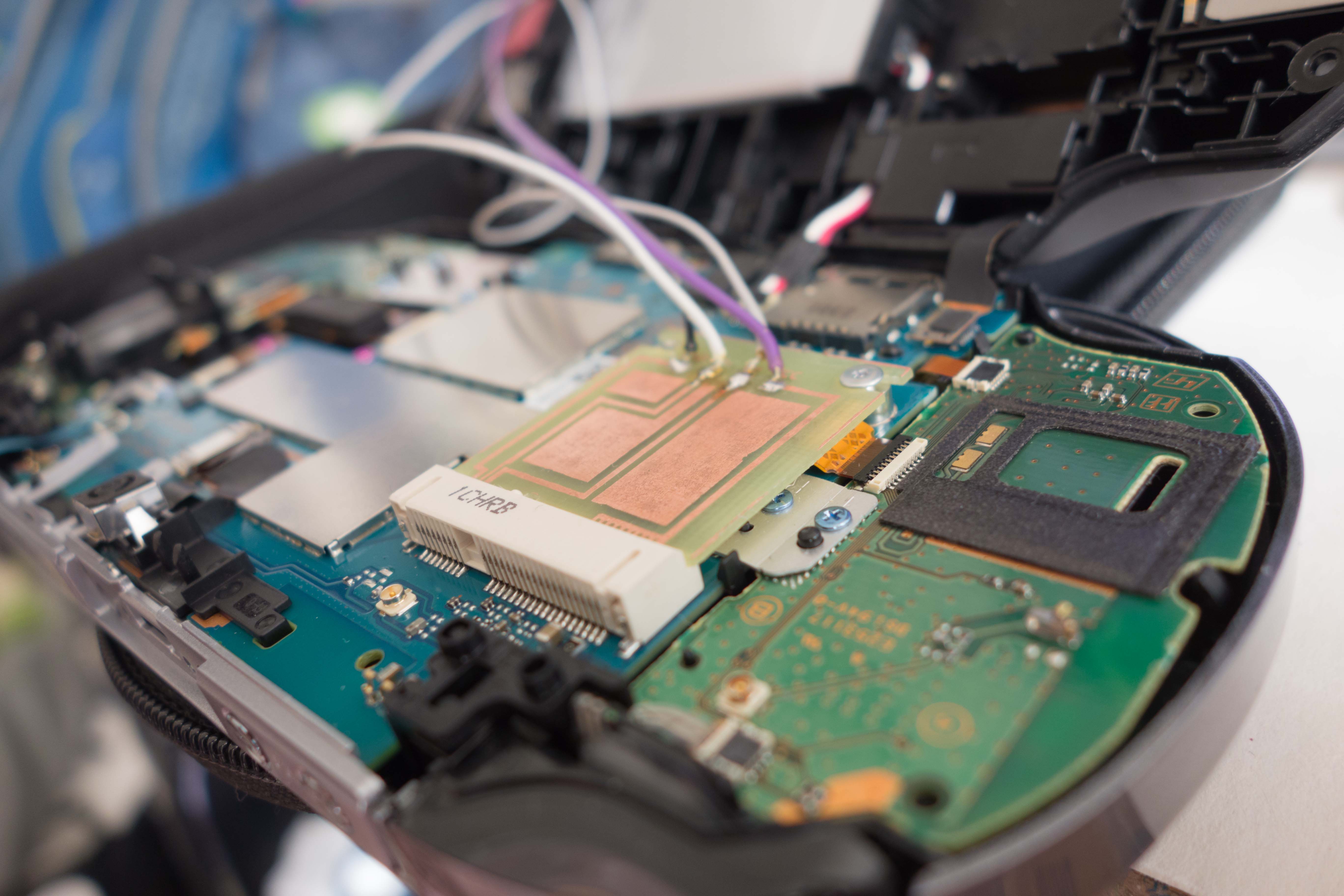

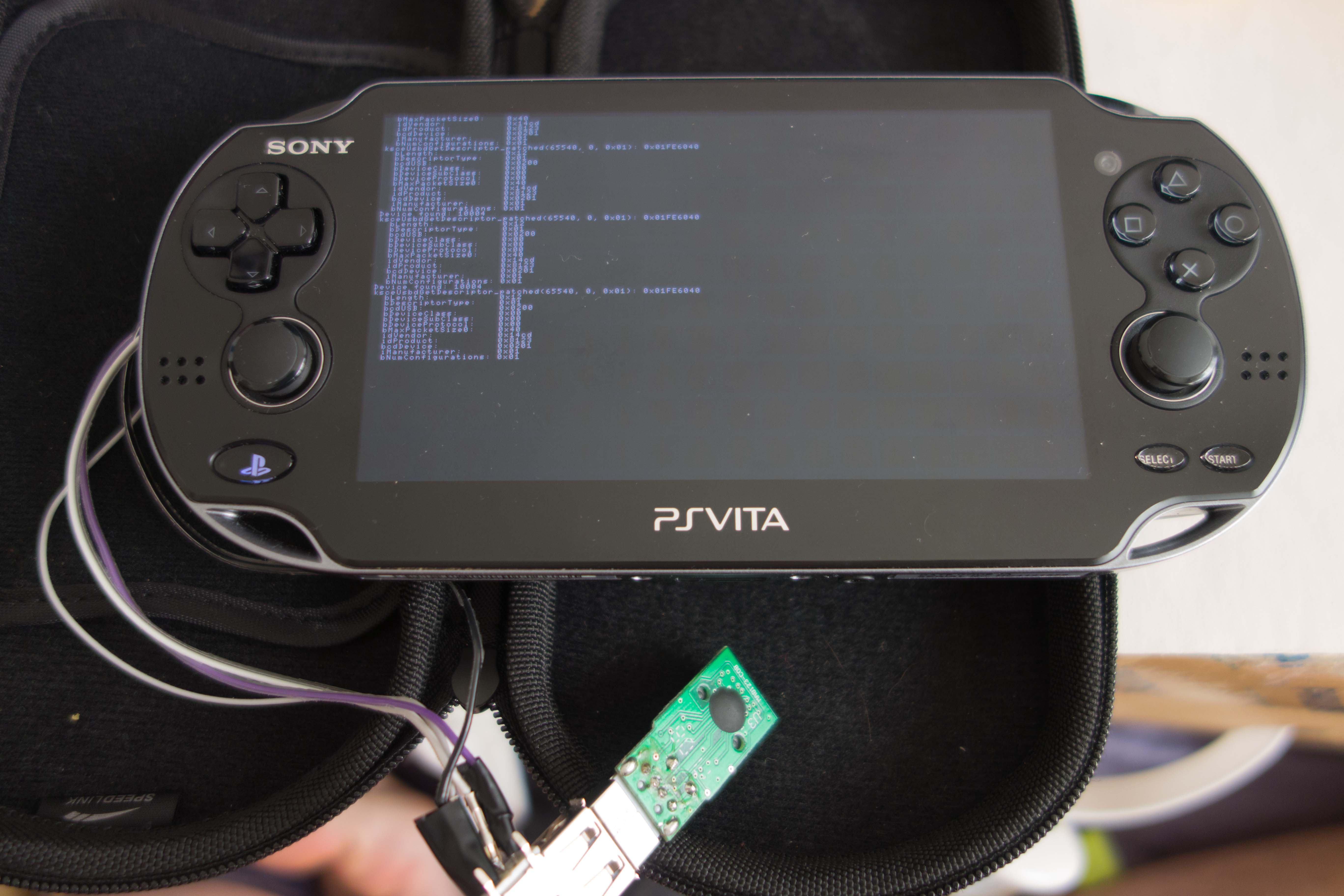

because i dont want to soldering to vita board i create simple pins out board for USB, if come to work in future i build in sd card reader to vita SIM slot. in last photo is yifan_lu usb_detect.vpk i dont no if is right result :)
View attachment 88845 View attachment 88846 View attachment 88847 View attachment 88848

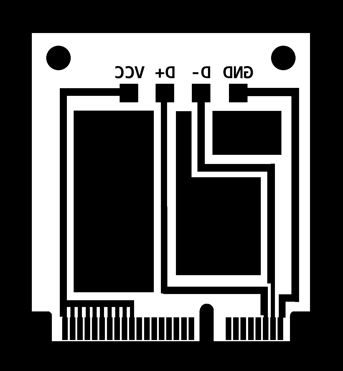

That looks really nice if I be honest, did you make the PCB yourself?

yeah i made it, it base on yifan_lu board, but create my own paths then print on laser printer on glossy paper and then transfer to blank copper clad circuit board with iron and etched in ferric chloride thats all magic :) i think if you have these 5 things its very easy.
this i print
this i print
Yeah I know the process of PCB etching , I was gonna ask if you'd be interested in making me a specific PCB board, of course you'll get paid for it.

So... Before I do dumb stuff. If I remember correctly the Wifi Version also has those pins just not with a PCIe connector soldered to it. Anyone know if this would theoretically be possible on a Wifi Vita and can you please make a better picture of the Fixed version. I can't really see which Pins you soldered to. Thanks a lot :)
There's only a few things you need to do. First bridge the VDD pin. The 3G vita has a 0ohm bridge. You can just use solder. Next under the shield to the right, there are the two USB differential signals, they both go to an unfilled pad. The 3G vita has a pair of ferrite beads but I think you can just bridge the two signals (separately, two bridges) with solder. The big question though is if sw will see it. You should use my usb_detect to find out.
Also, OP, I read that for VitaShell USB mounting to work, you have to enable uma0: and THEN plug in the USB. Can you try it that way?
Okay Gonna take a look at this then. Is there a picture or something which could help me find the correct pins that I need to solder to and bridge?
