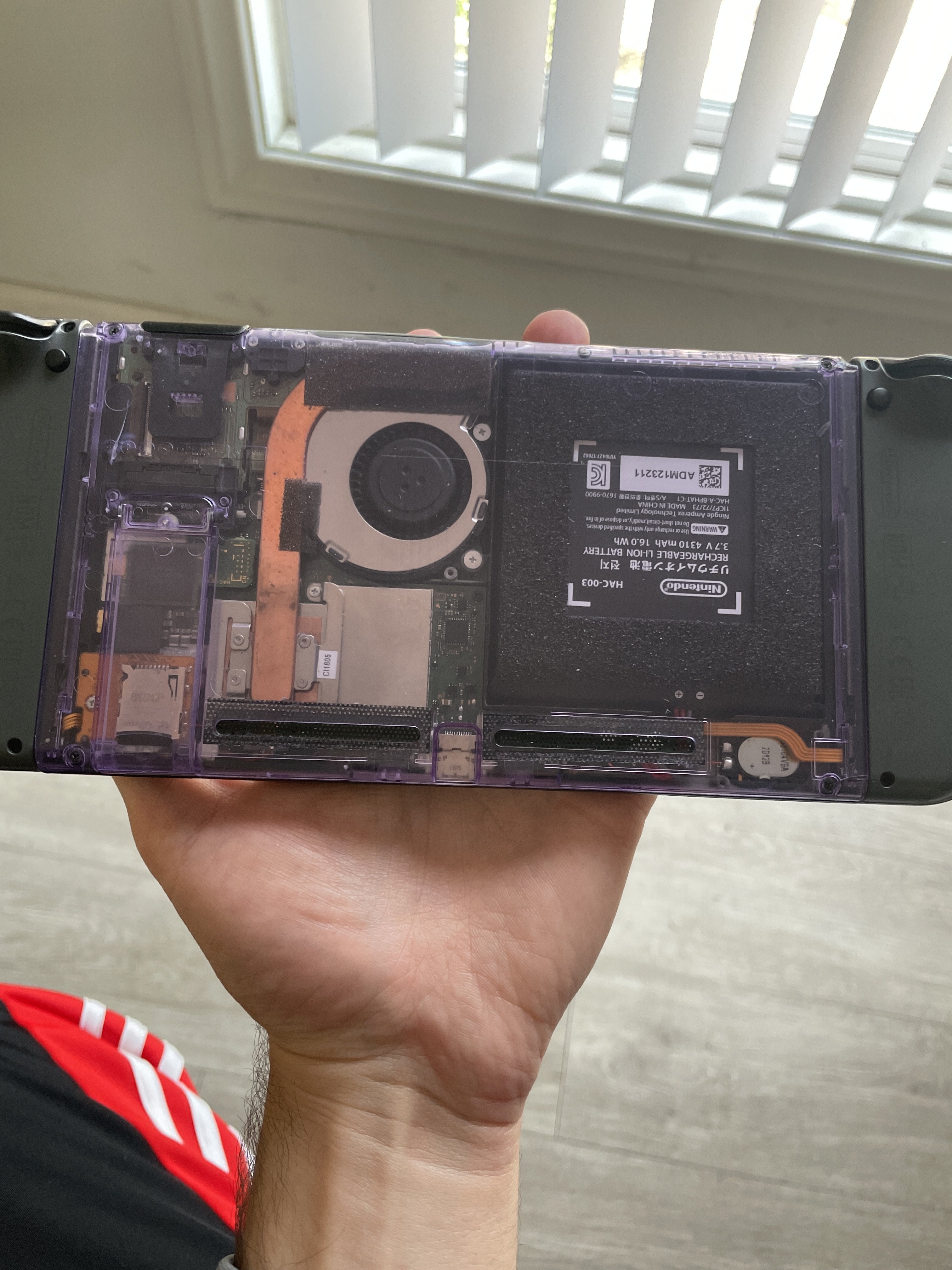

Okay. There’s definitely no modchip in there. I’m just curious why somebody would just install a different backplate and remove the sticker for the serial. It’s weird
Here are the pics
