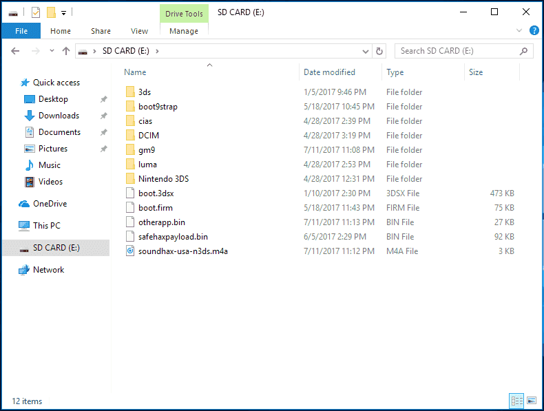

Which files do i get rid of and keep, just so i don't screw it up
https://3ds.guide/finalizing-setup the files you need are in section I step 11 to 16, the section you follow for the ctr luma is section VI.

Netherlands
Make your sd card look like it is in the file, start your 3ds normaly to see if the error persists. the luma and boot need to be the newest stable releases.
Edit: only the soundhax isnt needed
I did all that, did the ctr thing, same error BUT my 3ds can boot without the sd card now
