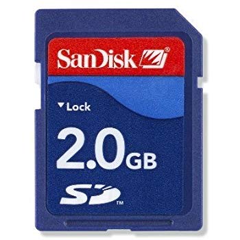

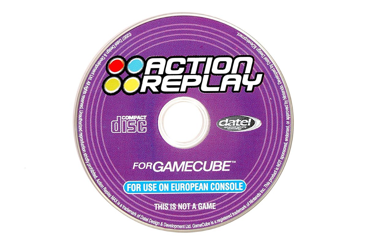

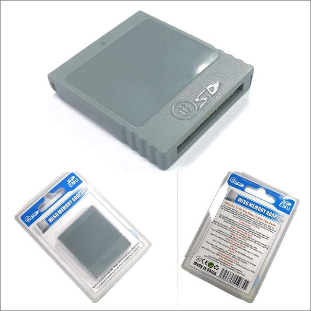

"WiSD" + Action Replay (2007?) + non-SDHC SD card.

There's some stuff you can do, but a lot of it requires either the action replay disc with a wiikey adapter (which is just a memory card adapter for gamecube you can plug an SD card into) or a copy of smash bros and a modded savefile with the same adapter. Getting backups to run correctly is a royal pain in the ass, the few launcher apps available like swiss or gcos are picky about SD cards over 2GB, so if you're running a 1.2gb gc backup, it's one at a time and the down-ported apps from the wii homeberew versions like vbagx, hugo, fceux, and genplusgx run ok, but again you need a specific directory structure, and depending on how many roms you want to throw on there you run out of that 2gb upper limit pretty quick again.
You can swap in a larger SD card once you boot to your homebrew launcher, but you're pretty much swapping stuff back and forth whereas with a wii you can run from ~32GB SD or ~500GB usb disk or a wiiu, with a ~128GB SD card without needing to boot something off a 2 gb SD card first.

Swiss has become very good at using SD cards connected to the EXI-bus (either Memory Card slots or SD2SP2). Depending on the method you choose to load Swiss this can be tedious or easy. [GC-Forever] Booting Homebrew. I've had no issues with latest Swiss versions – currently using an exFAT formatted 64GB SD. Loading times are comparable to the disc drive and cutscenes seem to be working now. The 2GB limitation comes from the Datel software; the switching back and forth between SD and SD(HC|XC) is not needed when using other easily/cheaply available entrypoints (Save exploits, XenoGC and Swiss on DVD-R)
