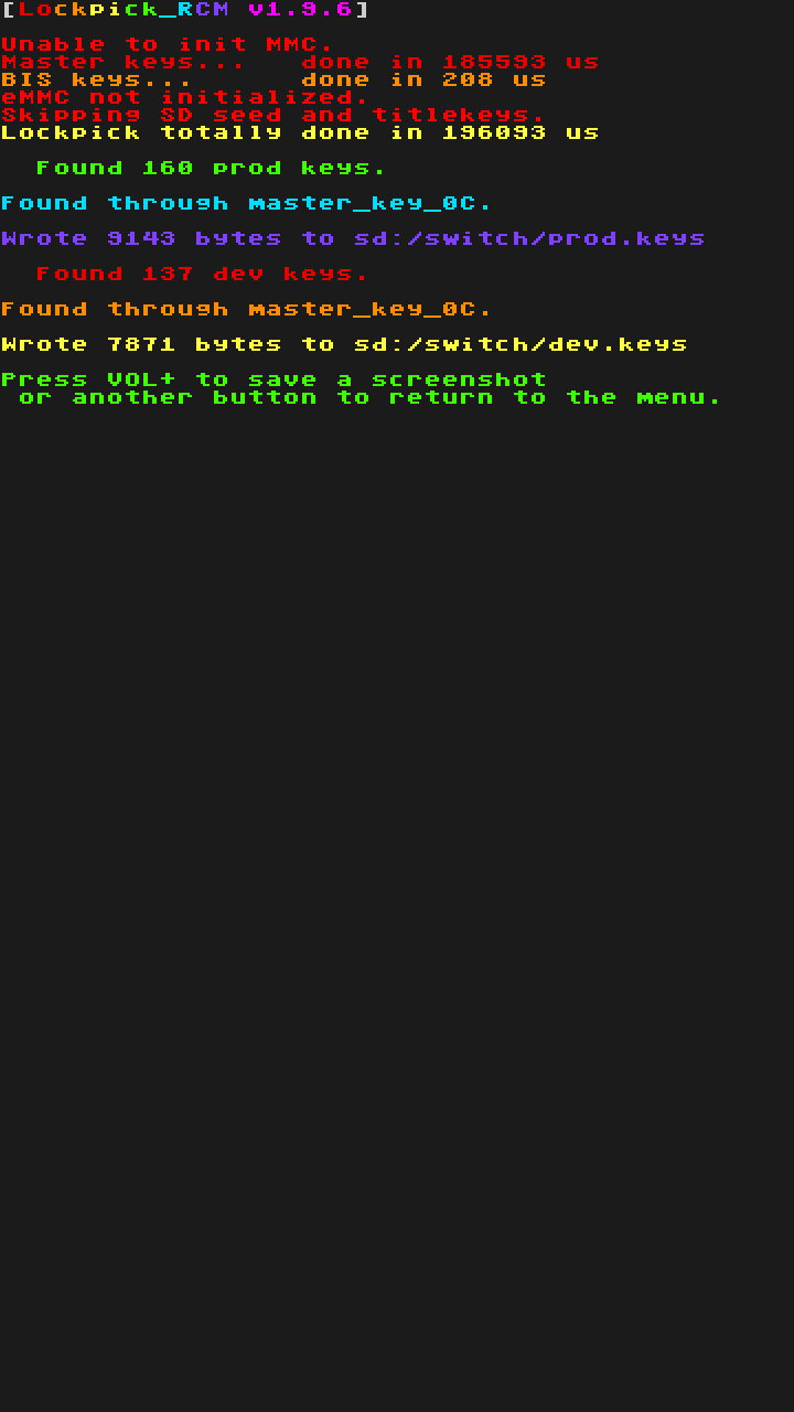

Wow okay so I decided to try a couple things and was able to use LockPick_RCM to dump my keys, I have them on my SD card and on my PC now. With these would I be able to get online again? Or replace the eMMC entirely if I have to, because I can rebuild the NAND on a new one? Or no
Maybe even the eMMC isn't completely broken and the NAND can be rebuilt

Wow okay so I decided to try a couple things and was able to use LockPick_RCM to dump my keys, I have them on my SD card and on my PC now. With these would I be able to get online again? Or replace the eMMC entirely? Or no
No, you will be able to rebuild a new nand for your console but without your existing 'PRODINFO' NAND partition you won't be able to go online again.
The paratition contain a console unique certificate.
