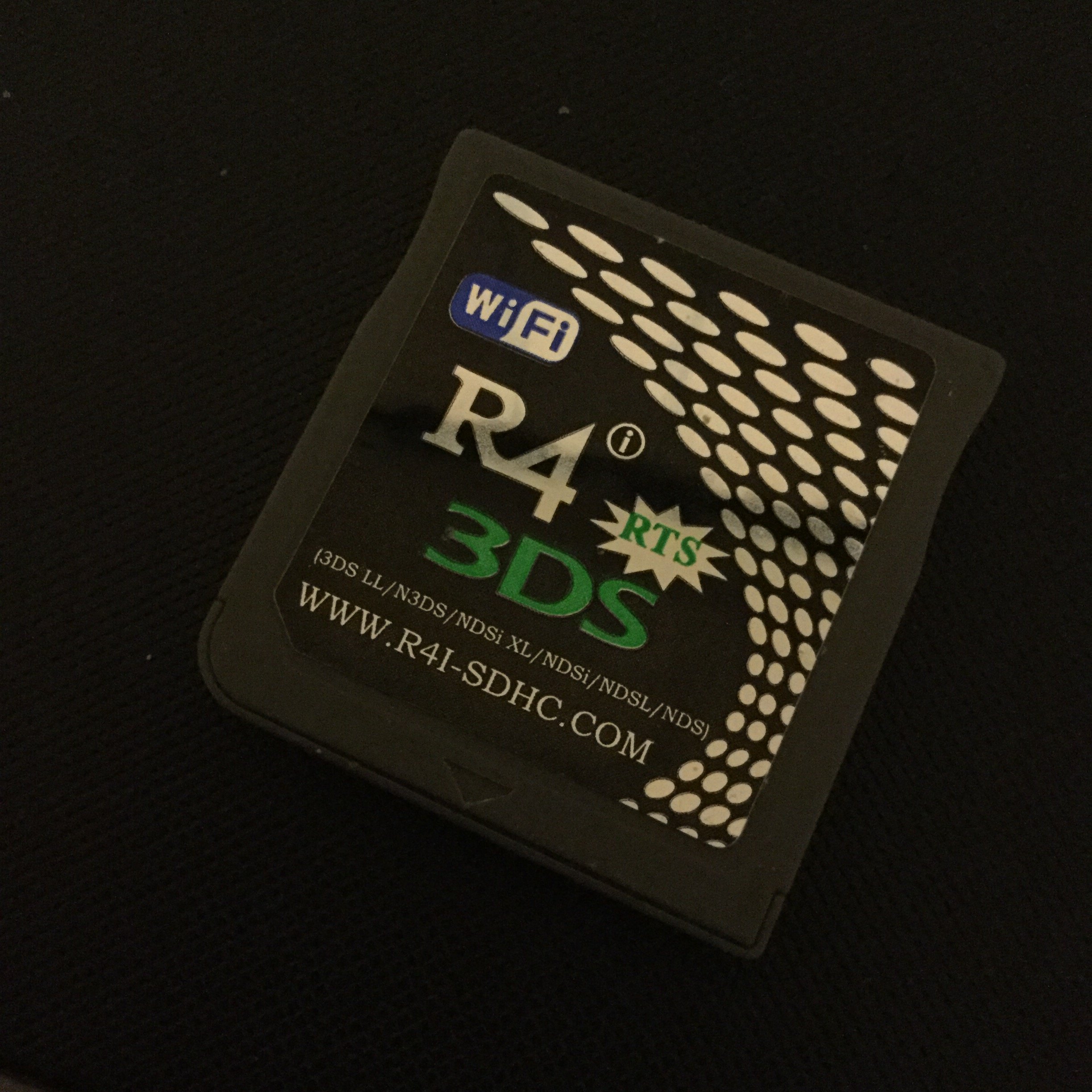

I have a R4 rebranded "Revolution for DS" and in the back it says "R4i-SDHC", does it works ?
[offtopic] seems like it's a joke, but nah, i really have this card [/offtopic]

nvm, that r4 isn't recognised anymore by my 3DS, so it isn't bootable anymore.
