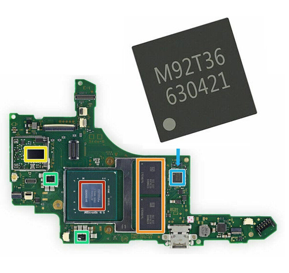

After you try to boot does your CPU get warm to the touch? Do you have a USB tester to see if your system enters the second stage boot?

Your other chip that could be responsible is the BQ chip next to the USB. If that one is also alright I'm going to take a hunch and say your port could be the issue.
Does your USB gives the same reading from front and back?

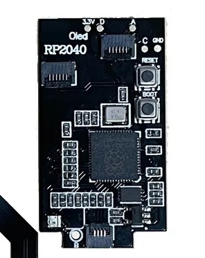

I have a problem, I installed the RP2040 which is very similar to the HWFly model, but it always boots in emunand and sometimes I can boot in OFW, but sometimes it hangs on the Nintendo Switch logo when I try to boot in OFW, or it gives an error 2002-3539 /3540, does anyone know how to solve this problem?
I also get slower mode messages when I try to create an emunand, backup and sometimes when doing a benchmark in emmc, but sometimes everything passes normally.
Has anyone already solved this problem and would know an effective way?
I have the exact same problem with me, would you say the problem was withchip , the cables , the installation or the resistors that you mention?
Pretty sure its not a bad emmc as the switch has been literally used only a handful times.
I have a v2 switch though and not an oled.
It did. I reinstalled the chip and changed the postfix, it was great. also check the other installations as well as cleaning after installation. Another item to be observed is the resistor, I changed them all to 47ohms.

So, my case was a bad installation in the postfix of Dat0, although it was signaling well in the multimeter measurement.
Anyway, if I were you, I would try to reinstall such postfix, as it can cause damage to your nand in the future.
Ideal is always to boot without problems, both Nand Original(OFW) and Emunand(CFW).
Always do Benchmark tests on OFW to ensure that the error is not slow anymore.

Hello everyone,
Bought a pre-modded OLED switch which apparently uses HWFly OLED RP2040 board from China, everything works fine except that restart and power off almost always result in black screen and no blue light on modchip and rp2040 lockup (as even after few minutes nothing happens) and I need to either press reset button on modchip itself (which is not always working) if I have switch disassembled or hold power for 15-20 seconds and press again to do hard reset which also not always results in blue light appearing. Sometimes reboot works fine tho so I can't understand what's going on. Haven't extensively tested OFW as I'm more interested in CFW and not a big fan of online gaming
What I've tried so far
1) different CFW (so it's definitely not something related to either Hekate or Atmosphere)
2) Upgrading picofly firmware via toolbox from v2.67 to 2.73, it's mostly works but sometimes after hard reset it rolls back to 2.67, also tried resetting training session data, nothing changes

When it's working it's around 1.7v
When it's black screen it's 0.540v
I have basic understand of electronics so would like some suggestions of what might be wrong
Modchip is exactly like in picture attached except that it has HWFLY OLED written on first line and RP2040 on next line
P.S. person who did installation and sold me this Switch doesn't want to fix this as quote 'you messed something up with CFW so it's not a modchip's fault' which is obviously a bullshit reason not to take a responsibility of fucked up job
P.S.S. rebooting also works fine if I shorten the reset contacts by placing red probe on one of reset contacts and black probe on gnd on PCB itself

Hello everyone,
3) Measured voltages on installation via diode probing points
A 0.474v
B 0.389v
C 0.632v
D 0.644v
4) Measured voltage B point with battery on and switch running
Using wires or fpcb? That flex sometimes comes defective. If you want to rule out the possibility of a faulty chip you have to get rid of that ribbon first.
flex cable connection, apparently, my understanding is that when switch reboots it should send high voltage over the B wire to signal modchip reset, and if the wire is too long or too thick it has higher resistance than it should and modchip doesn't interprets it as high enough to do a reset, correct me if I am wrong and this is not the case
You can try wiring to the pads instead.

Hi, I've been sent here from another thread so I'll report my question:
I purchased a few hwfly Rp2040 which are compatible with PicoFly but there's something odd happening on an OLED. I get this LED pattern and black screen (no response whatsoever from the console)
*=* No eMMC block 0 read (eMMC init failure?)
Now I've tripple checked all my solder work. I've verified the values with the multimeter and this is what I get in diode mode:
A: 0.53
B: 1.0
C: 0.867
D: 0.909
I didn't check 3v since the chip is getting current. The strange thing there is that if I detach the chip the console boots fine. Any ideas on where to check? The one I'm baffled on is CLK/B which reads 1 but the error doesn't reflect on it whatsoever.
Something that I need to mention that could probably affect it (which I don't see how) but the console was recently freshly factory reset and no new profile has been created.
Also ease note that I updated it to.the latest version of picofly 2.73 but I was told in the picofly thread that the board isn't compatible but the problem happened from before I updated it.
A: 0.53
B: 1.0
C: 0.867
D: 0.909
What do tou mean with clk being 1.. thats is not conected.. also its 1 from ground ?
Try to replace wire on clk then.

I installed PicoFly (or how they call it, HwFly RP2040) with FW2.73 using flex cables in my Switch Lite. It works, but the time to glitch it varies a lot - from 3 seconds up to 90 seconds. It glitches every time and boots without any issues, the only issue is the time to do it.
A: 0.712
B: My multimeter can't measure it, should be good
C: 0.712
D: 0.712
CPU: 0.14 on both sides
This is the second Switch Lite I installed a PicoFly modchip in and it was the same case with the first one. I tried 3 PicoFly modchips, tried reworking the CPU solder joints, but nothing changed.
Any ideas what to try next or what to check? Or I should consider this normal behavior for this Switch and use it as is?
