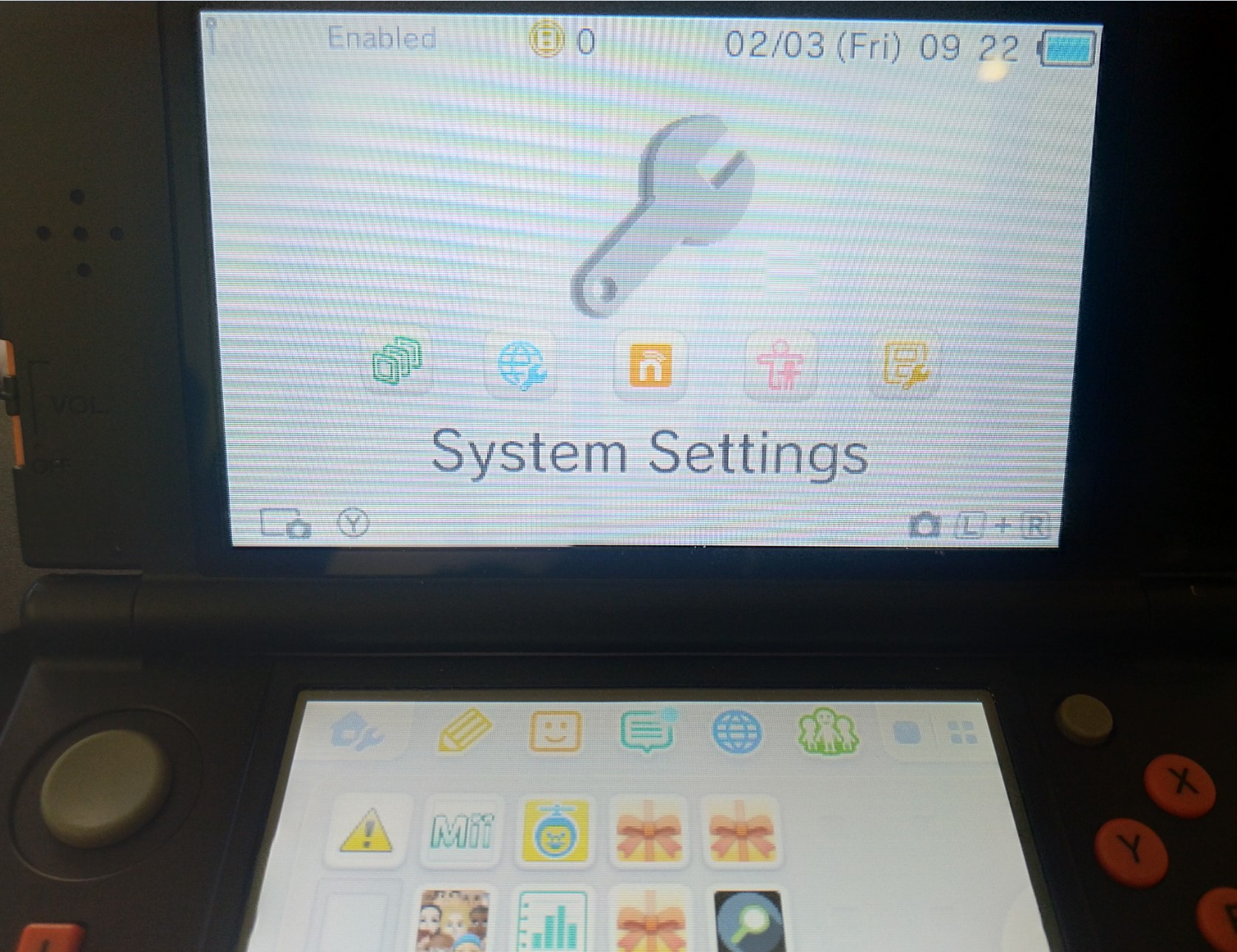

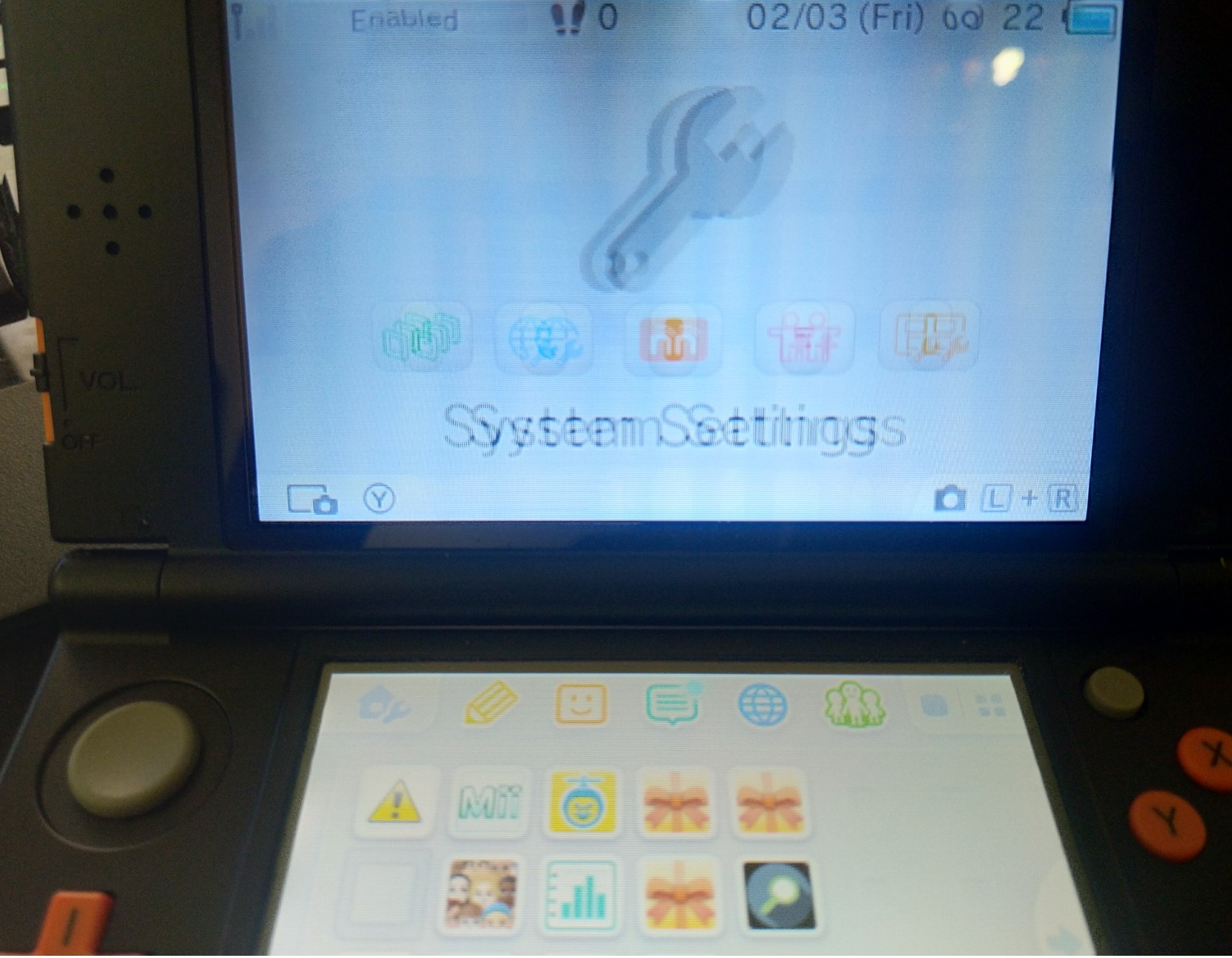

I did a motherboard swap with a new 3ds xl i purchased online that was not working.
The donor motherboard was Top IPS and Bottom TN.
After the motherboard swap, the 3ds turned on, but the top screen was dim and blurry (like both left and right images are displayed) when the 3ds slider is activated.
When the 3ds slider is fully down, the screen looks good.
3D activated
3D Deactivated
I found the HWCAL0.dat and HWCAL1.dat files for the dual TN.
And followed the steps above.
However, there is no change to the top screen.
Not too sure what else to do.
Any other suggestions?
Thanks!
