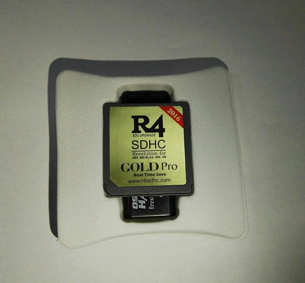

Unfortunately not yet. I have the same type of card as you & I tried it, but it says it's not supported. I thought I had the correct card when initially thinking about it, but there were a few minor differences in the logo of the card. Idk if I should wait until my flashcard is supported in the future or buy the compatible flashcart before prices skyrocket.
Update: My card and his card is a R4i SDHC 3DS RTS.
Well rip I guess

I hope so... That would save me the worrying about buying a currently supported flashcart or not. I have the R4i SDHC 3DS RTS with the wifi logo. The gold 3ds rts's logo doesnt have the wifi logo on it, plus the official website on it is different.
Well shit... I have the exact same card as well. But mine is 2015. :/
Yep... Only time will tell to see if my card will be supported or not. xD
Just buy an acekard or a r4i gold 3ds rts, i would buy an acekard because it still works after flash, cause i have both a lite and a 3ds. $20 ain't that much.

For the people asking R4 SDHC isn't supported yet. It'll be coming eventually but right now the development team doesn't any of the SDHC cards or the firmware last I heard.
