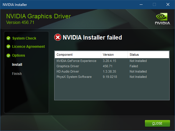

Okay sweet good news. Next take this file and put it in Display.Driver folder and replace the exisiting one and try the setup again and let me know how you go.
http://www.mediafire.com/file/iyji9z9gqeuvvz9/nvcvi.inf/file
Now, I get this.

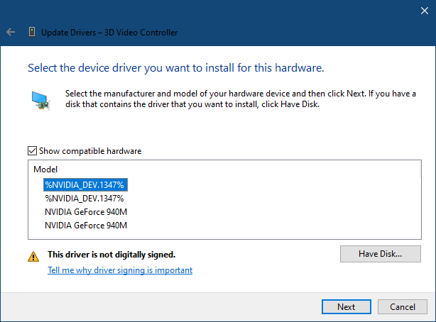

Cool, Follow the guide for option two
https://www.howtogeek.com/167723/how-to-disable-driver-signature-verification-on-64-bit-windows-8.1-so-that-you-can-install-unsigned-drivers/#:~:text=Click the “Restart” button to,able to install unsigned drivers.
Once you have restarted the system with 'Disable driver signature enforcement', go to device manager, right click the 940m and update driver.
Browse my computer
Let me pick
Have disk
Locate the nvcvi.inf file and select it. Then show me the options of drivers you have available.
These are my options.

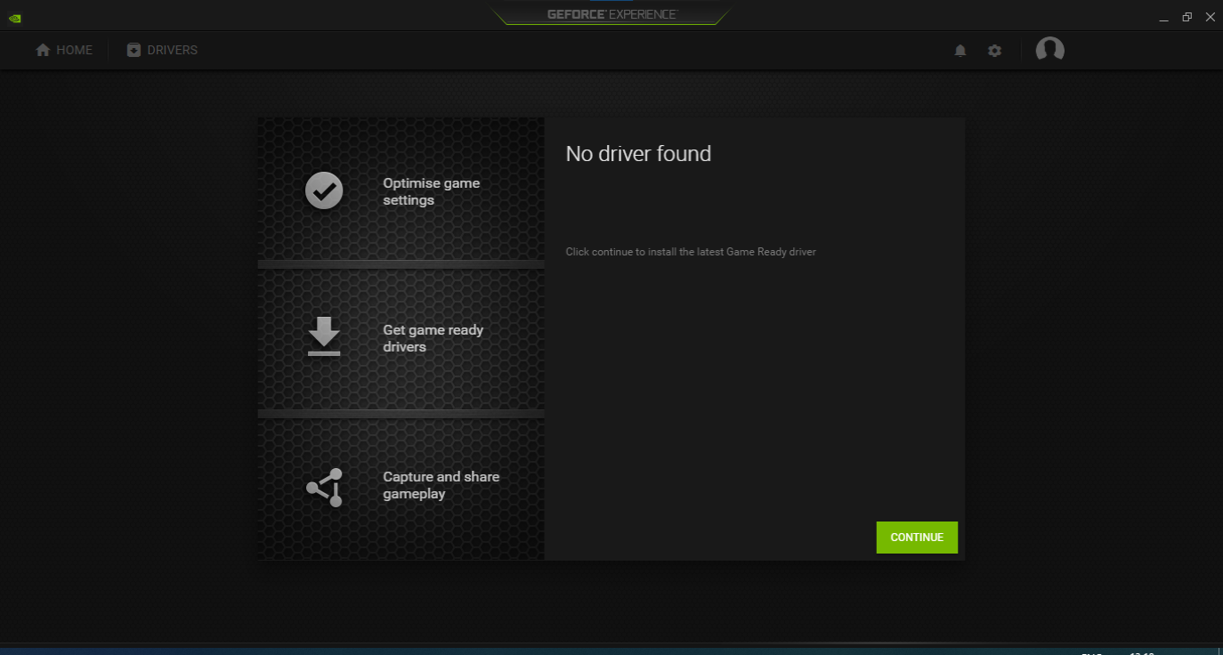

The install finished successfully. The card shows up in device manager, and GeForce Experience launched and gave me this.

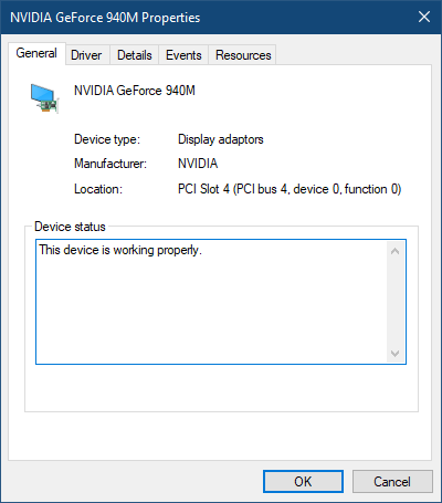

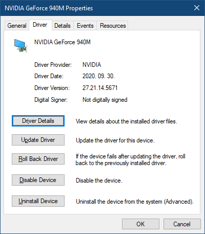

What is the driver name displayed in device manager? And did the red unassigned driver screen come up?
It shows up as NVIDIA GeForce 940M. And yeah, the red screen did come up, but I clicked ‘install anyway.’
View attachment 231676 View attachment 231677
A restart may help after everything.
Then what I would say at this if it does't work, is to reinstall the drivers again with custom install, then clean install.
Or use DDU to completely uninstall, and install again, keep in mind that if you use DDU, you will need to restart in “Disable driver signature enforcement” option again. But I will say that just do a clean install first and see how you go. Also before that you could try an application that uses the Nvidia card to atleast see if other applications work with it. Then you will know atleast it does work. Your super close at this point.

After a restart, I'm back to error 43...
Sorry, I'm not sure I understand correctly. Should I uninstall the driver, reinstall it from the installer with custom options (which ones?), then run the installer again, with the recommended settings?

Same as last time. GeForce Experience opens and says ‘No driver found. Click continue to install the latest Game Ready driver.’
