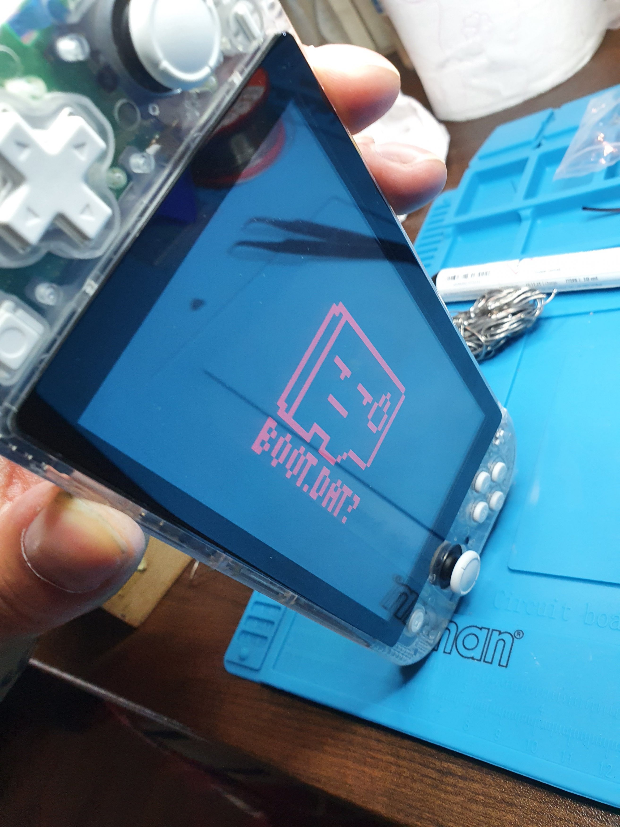

Received my sx core yesterday :).
I'm gonna try the install this weekend, wish me luck :yay:.
The last vidéo shared is really good. Best i've seen so far.

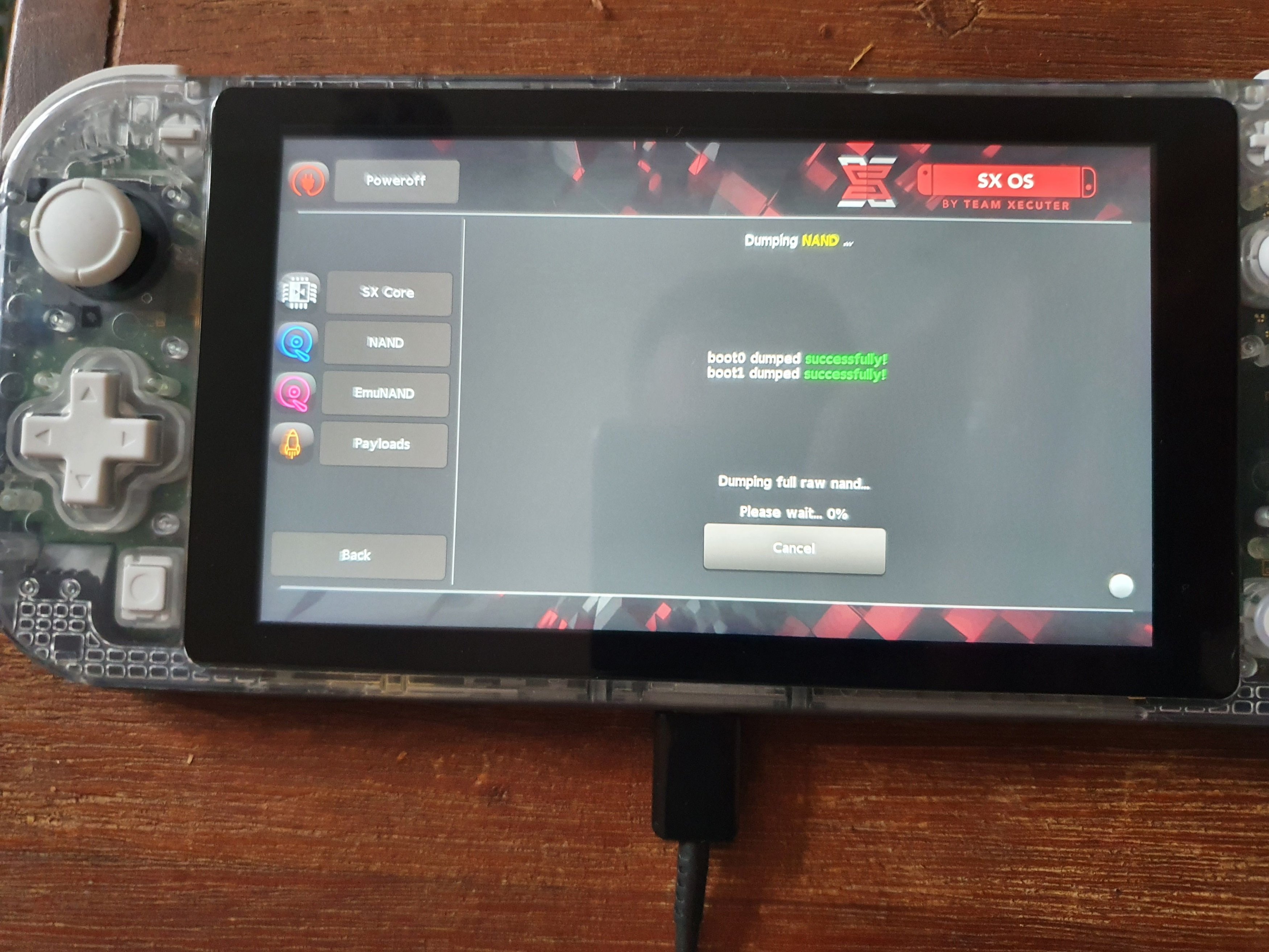

You can skip the fat32 requirement if you’ve put in an exfat microsd card in ofw. That would have prompted you to update to support exfat . Then sx will support it too. But you need to have downloaded the update first. Still might be possible if you boot ofw through sx menu and update. If it can read without updating then it’s been done already
As per my understanding if your switch is in a lower firmware. Its better to use the exfat memory card then proceed updating to 10.0.4, on the other hand if the unit is in 10.0.4 already there is no way to use the exfat memory card. So we are stuck using fatt32 I guess, and if we succeasfully booted sx core boot.dat then backed up our nand we can proceed now to cfw. By then can we use exfats already? Im very new to SX operating system, so I reallt have so many questions lingering in my mind. Been with atmos since the start.

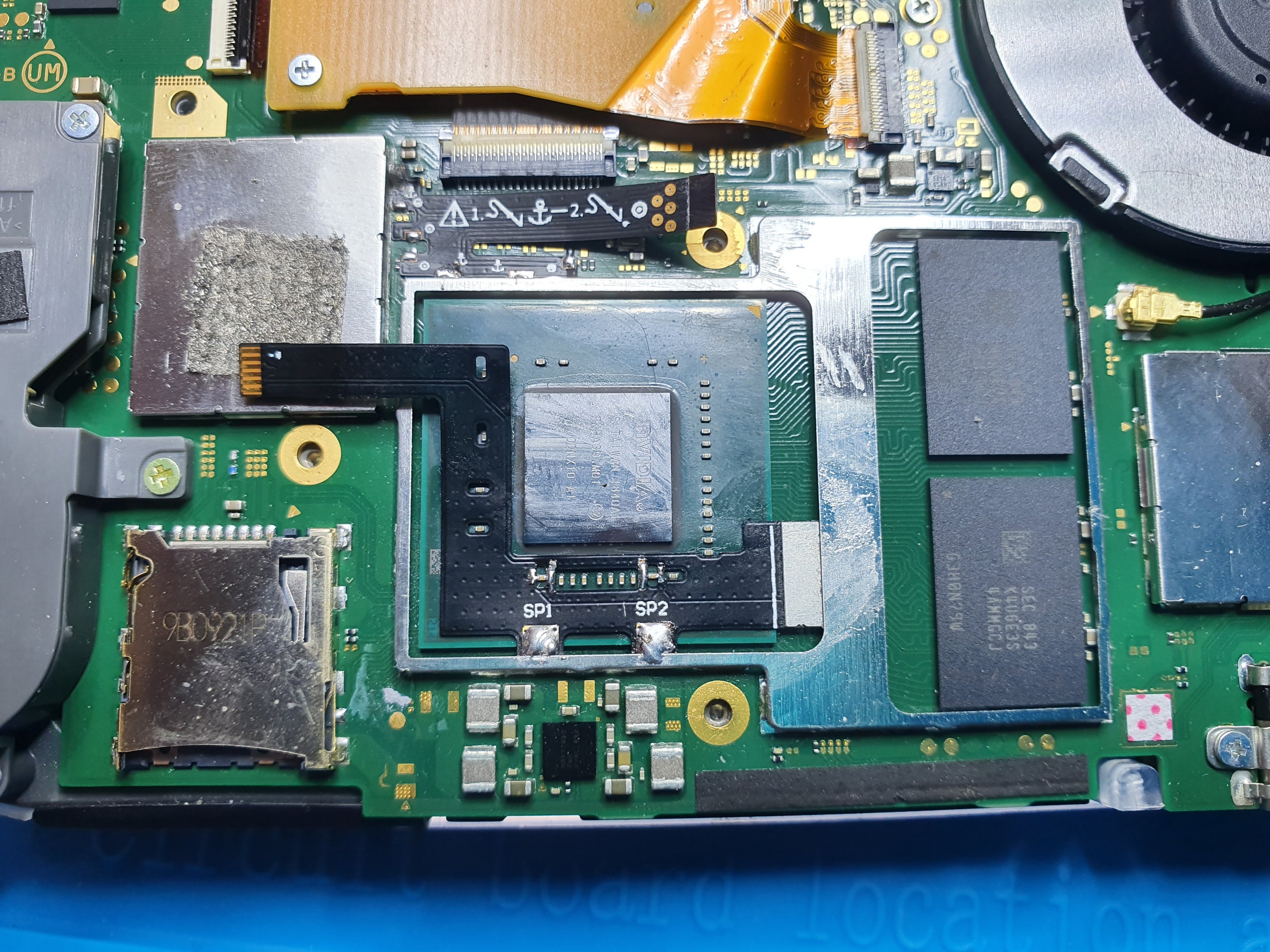

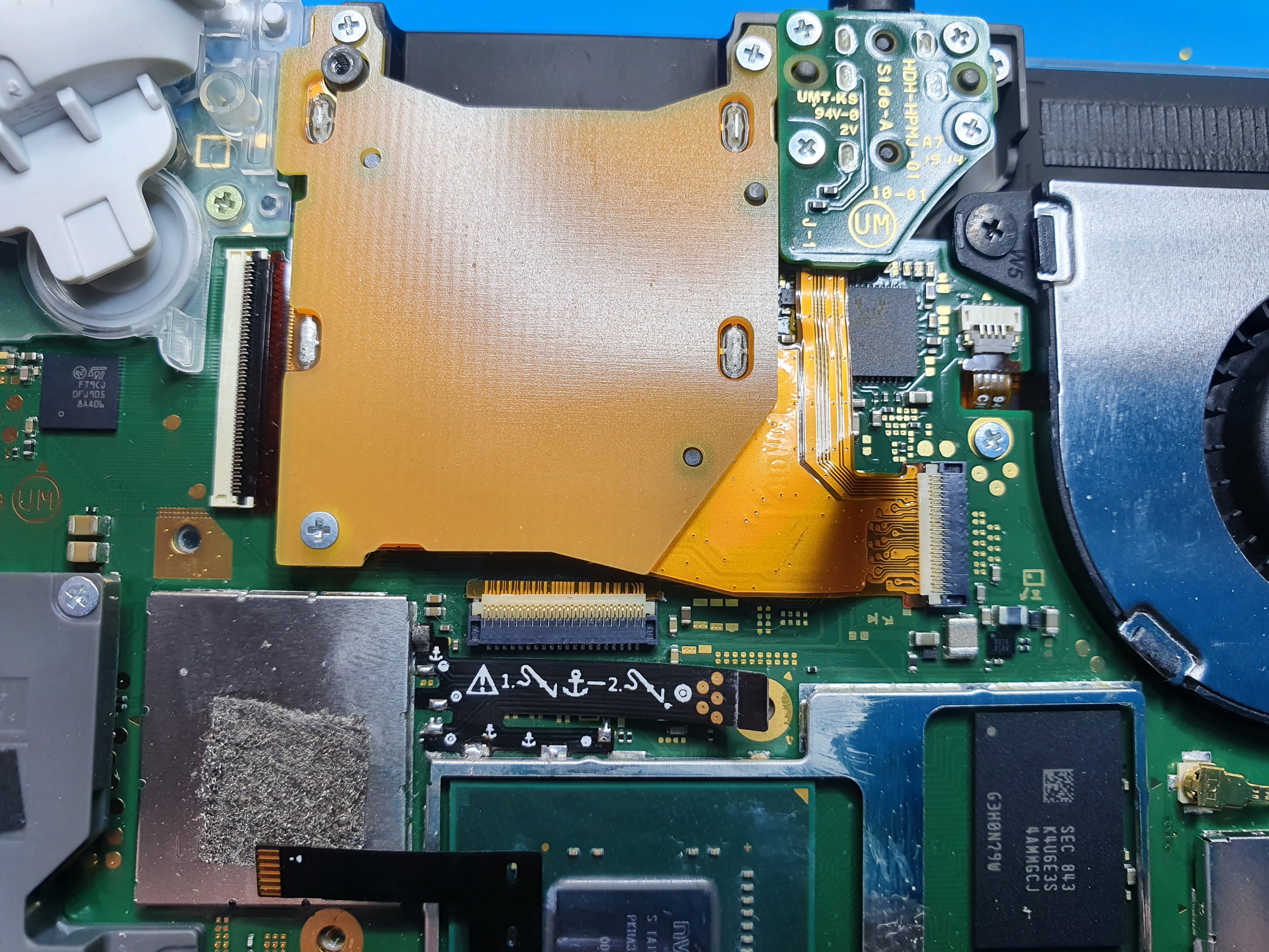

I applied flux paste with a needle to all the solder points including caps then tinned all solder points except the anchors.
Then positioned the ribbon with double sided sticky tape, this also keeps the ribbon flat and stuck down close to the caps.
Added tiny amounts of solder to the solder points several times by adding small amounts of solder to the solder tip and then touching it to the joint allowing it to reflow to the pretinned contact on the ribbon and dragging over to the cap.
Add more flux paste each time. Apply small amounts with a needle, if you add too much you can't see whats going on.
Let the solder point cool in between additions in order to avoid damaging the caps.
It's hard to wrong if you do it this way. People seem to get themselves in trouble by adding too much solder at once.
Solder the pads last to secure in position
Test by connecting the rest of modchip accessories and turning on. There is no need to attach the heatsink as the device will only be on for 10-15 seconds.
If it hasn't worked add more solder and retest.
