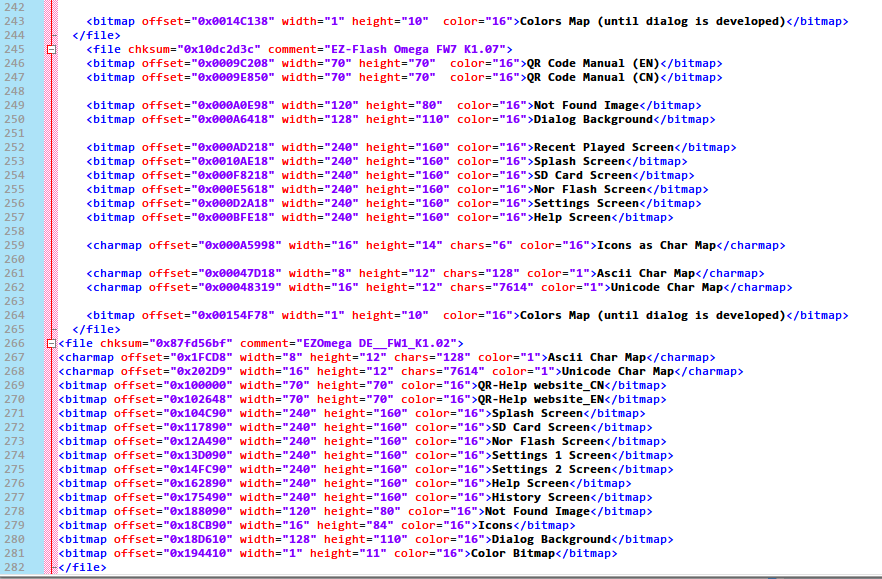

The DE kernel contains extra assets for the extra settings menu.
means update offsets with one official posted.
<file chksum="0x87fd56bf" comment="EZOmega DE__FW1_K1.02">
<charmap offset="0x1FCD8" width="8" height="12" chars="128" color="1">Ascii Char Map</charmap>
<charmap offset="0x202D9" width="16" height="12" chars="7614" color="1">Unicode Char Map</charmap>
<bitmap offset="0x100000" width="70" height="70" color="16">QR-Help website_CN</bitmap>
<bitmap offset="0x102648" width="70" height="70" color="16">QR-Help website_EN</bitmap>
<bitmap offset="0x104C90" width="240" height="160" color="16">Splash Screen</bitmap>
<bitmap offset="0x117890" width="240" height="160" color="16">SD Card Screen</bitmap>
<bitmap offset="0x12A490" width="240" height="160" color="16">Nor Flash Screen</bitmap>
<bitmap offset="0x13D090" width="240" height="160" color="16">Settings 1 Screen</bitmap>
<bitmap offset="0x14FC90" width="240" height="160" color="16">Settings 2 Screen</bitmap>
<bitmap offset="0x162890" width="240" height="160" color="16">Help Screen</bitmap>
<bitmap offset="0x175490" width="240" height="160" color="16">History Screen</bitmap>
<bitmap offset="0x188090" width="120" height="80" color="16">Not Found Image</bitmap>
<bitmap offset="0x18CB90" width="16" height="84" color="16">Icons</bitmap>
<bitmap offset="0x18D610" width="128" height="110" color="16">Dialog Background</bitmap>
<bitmap offset="0x194410" width="1" height="11" color="16">Color Bitmap</bitmap>
</file>
compatible with K1.03

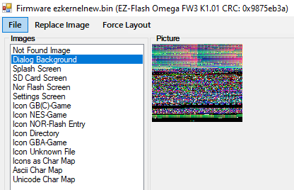

Hmm thanks for this although when I add this to my definitions.xml I still get an error about Universal Skinner not being able to read the file correctly :(
That's the ezkernelnew.bin I tried: Kernel 1.03 and firmware 4.0
for DE all firmwares share a same bitmap offset, and of cuz they have different checksums. so just ignore the warning and choose forcing layout is ok.

Hmm alright but even if I do this it doesn't load correctly:

1 click force layout
2 choose EZOmega DE__FW1_K1.02
or just clear all the other offset
the offset you load is an omega one
Okay thank you, deleting every other offset block worked! So if I modify the firmware with this now I can safely flash it afterwards?
EDIT: That worked like a charm :)
