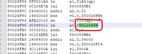

Same problem testing with the SCPH-101, it does red screen on the PS2.
Same issue with Brunswick pro. Bowling 2 on scph 101 freezes at load from memory card with music playing or sometimes a black screen, no red screen without the tonyhax file though.
Now that's odd. Those two exploits worked fine on an emulator, and my SCPH-102 also ran the Brunswick 2 PAL-E version exploit just fine. But you are right that the console chokes with the very same exploit on NTSC-U.
This is going to be hard to fix, since there's nothing I can do other than blindly run stuff on the console until it works, given no$psx works fine with the exploit.

Could the problem be they're running it on a ps2?
I don't think so, they said it worked fine on a PS2, but failed on a PS1.
The interesting bit is that the buffer allocated for the memory card is a static one. This means it's a fixed address, not something that will vary from between consoles as a dynamically allocated one could do between BIOS revisions. Yet still it's failing to work on a real machine. Hm.
