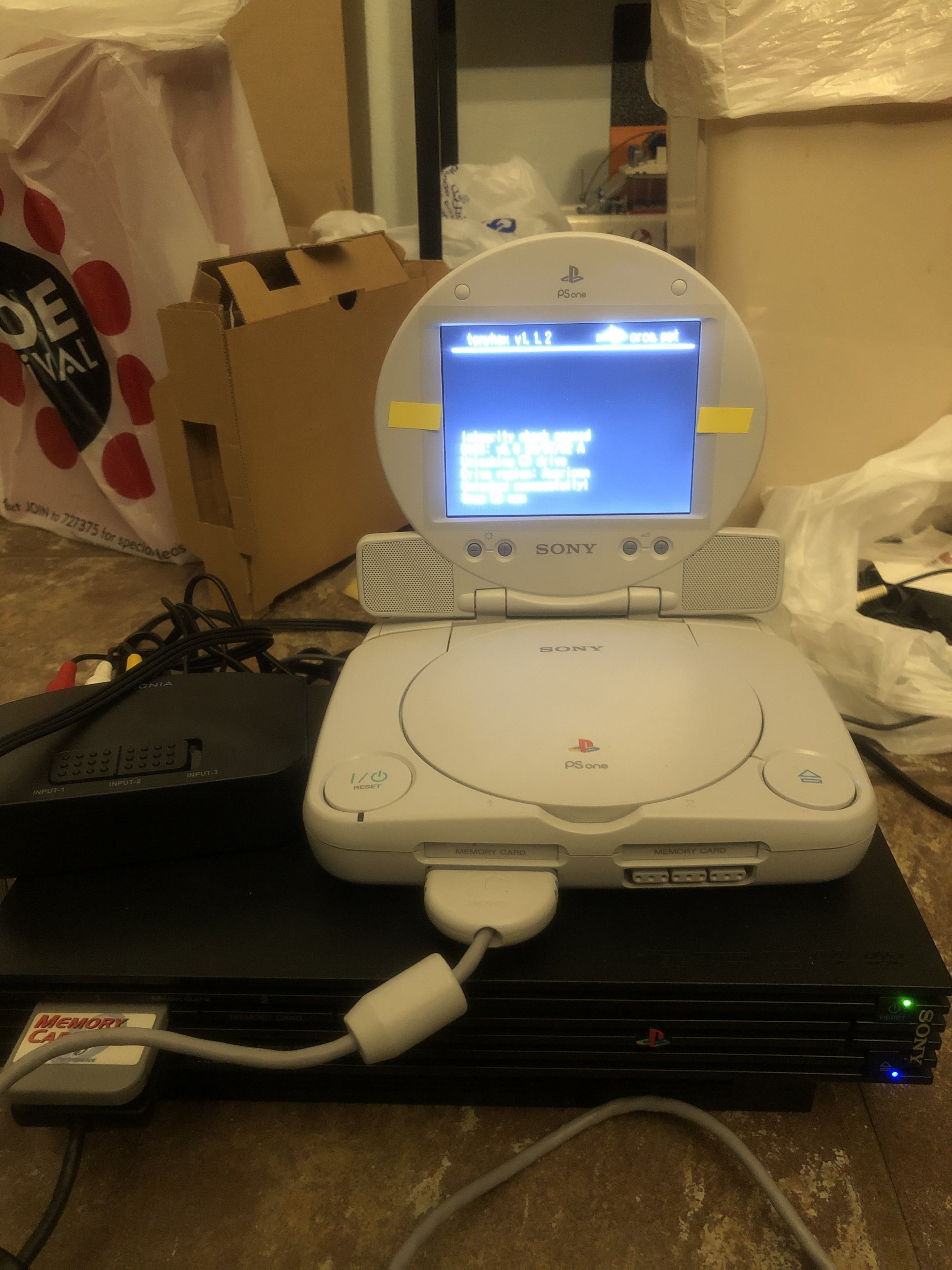

Thanks to @DarthMotzkus and @Shardnax for the debugging on their machines, I have just released v1.1.2. If you were trying to use Brunswick Pro Circuit 2 NTSC-U and couldn't get it to work, this release is for you.
Changes since v1.1.1
  • Fixed Brunswick Pro Circuit 2 (NTSC-U) (SLUS-00571) entry point, which was causing the SPL to fail loading.
  • Loading steps in the entry points are now color coded for easier debugging:
    • Purple (Brunswick only) indicates the memory cards are being reinitialized.
    • Blue indicates the SPL is being read from the memory card into memory.
    • Green indicates that the SPL is about to launch. This shouldn flash very very briefly.
    • Red indicates the SPL couldn't be found or loaded.
    The console should spend no more than a couple seconds with each color. If it spends more time, it's probably crashed. Please report it.
  • Added an integrity. Shall the SPL load in a corrupted state into the main memory (for instance, if the memory card is damaged, the file is corrupted, or some other process caused the load process to fail), it'll now report so during the boot on the screen.
  • The SPL will now report your system BIOS. If you are experiencing any issue, please remember to tell me the BIOS version.
Essentially this version has just been released to fix the Brunswick 2 bug, which was causing me a serious headache as the payload was booting just fine on the emulator, but failing on real hardware during the phase in which the SPL was loading into main memory, with all the previous steps (card initialization, file open...) executing just fine.
The FileRead call was executing instantaneously, as if it wasn't reading anything, despite me explicitelly checking the return value. Instead of getting to the red screen of dead, it was just turning black, something I don't have implemented anywhere on the code.
After adding all those logging features, it turned out that the issue was simply that the save file had a wrong address, and it was causing the stack pointer to never get reinitialized. FileRead apparently has enough nested functions to cause the call stack to grow larger than what the fast RAM - where Brunswick helds the stack - could hold and it just crashed into a black screen.
Just like v1.1.1, this is just a bugfix release - if previous versions were working fine for you and you don't mind missing the cool seizure-inducing loading screens, just skip it.
Available at https://github.com/socram8888/tonyhax/releases/tag/v1.1.2

PS2 SCPH-39001 Date Code 2C works
BIOS Version V5.0 02/07/02 A
my other 2 PS2 Slims (SCPH-77001) don’t work and my 3 fat SCPH-50001 systems don’t work either.
seems some earlier US NTSC models used the American firmware rather than the Japanese firmware and support the unlock command.
I did test an SCPH-70012 but it had a loose ribbon cable and literally put a circle ring on THPS 3 and ruined it so I have another from eBay on the way.
good thing I picked up Brunswick Bowling 1 and 2 as I had to test other systems with that after the incident
I find it interesting that newer consoles that can work with with the PSXLoader homebrew are the ones that don’t work with this hack since the drives are a different region.
I did try some AntiMod games including the notorious Spyro 3 NTSC and booting a real disc on a same region console via this exploit works and does not throw the console modified error. This is good as I was not sure if the unlock commands issued would mess with games checking for the license string.
I do not have a PAL or NTSC-J system to check if a legit Spyro 3 game will pass it’s check on a different region system but it should since the drive will still report the SCEA string each time it checks since the disc is legit.
booting a clean copy however will throw a hardware modified message which does not happen with stealth modchips since the modchips will inject the string each time the game requests it.
