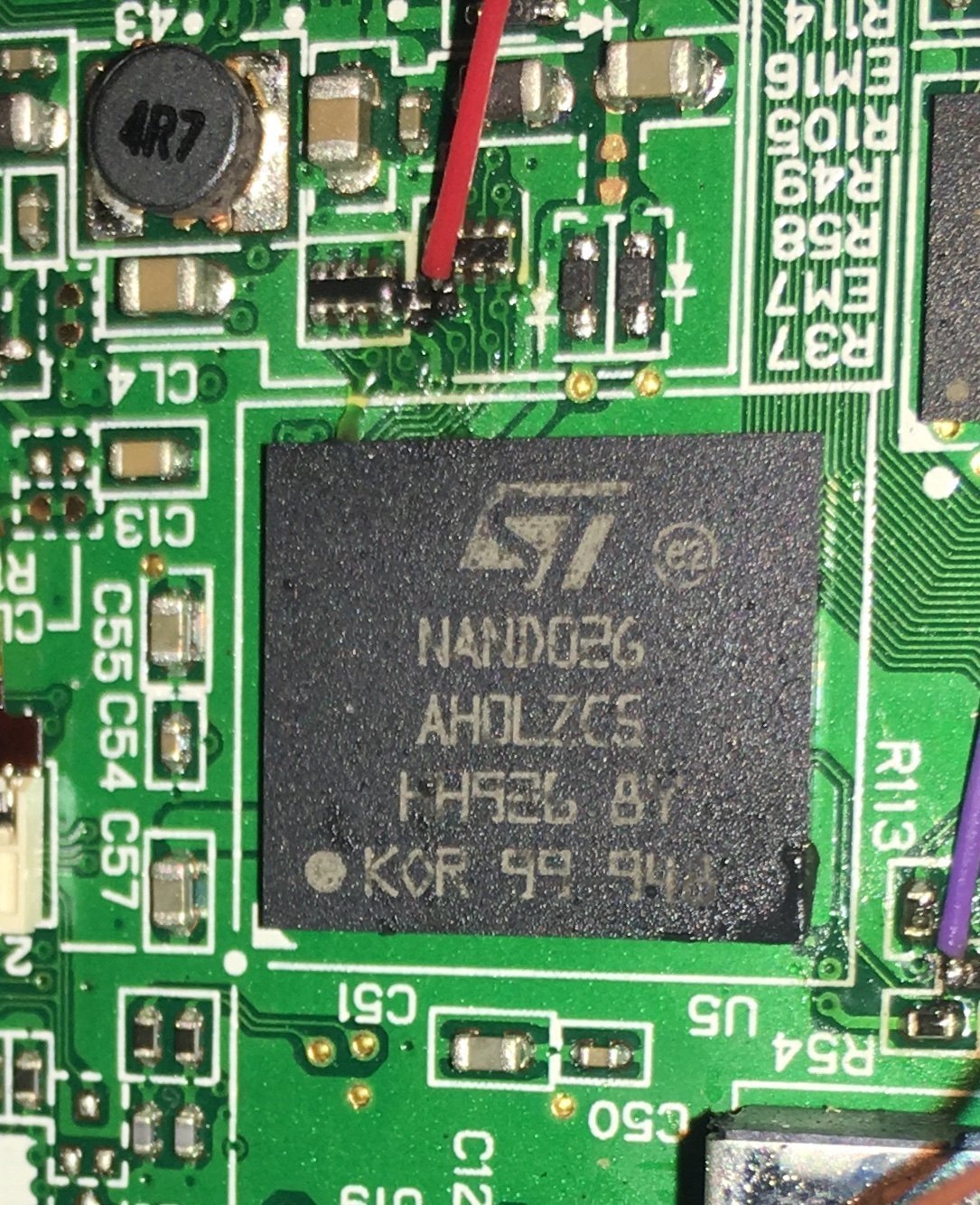

Well, that was fun. I got my Console ID bruteforced thanks to this guide, but I was utterly stuck at the EMMC CID because my NAND is not made by Samsung, but rather it's made by ST, and thus has a completely different set of digits. Ended up buying a copy of The Biggest Loser... so here we go!
Console ID: 08203********1**
EMMC CID: CC ** ** ** ** 30 36 35 32 43 4D 4D 4E 01 FE 00

Hey, just got my second DSi without Flipnote so i have to do hard mod to get HiyaCFW + TWiLight Menu++ onto it. I don't have any exploit-games like The Biggest Loser. I'm going to use SudokuHAX but thing stops at decrypting my NAND image. I don't have Console ID or CID, that's why i need to brute-force them with TWLbf. Next stumble-rock is... Yeah, how i use it? What commands i need to type in? Can somebody help total noob to use this tool, i appreciate help very much!
