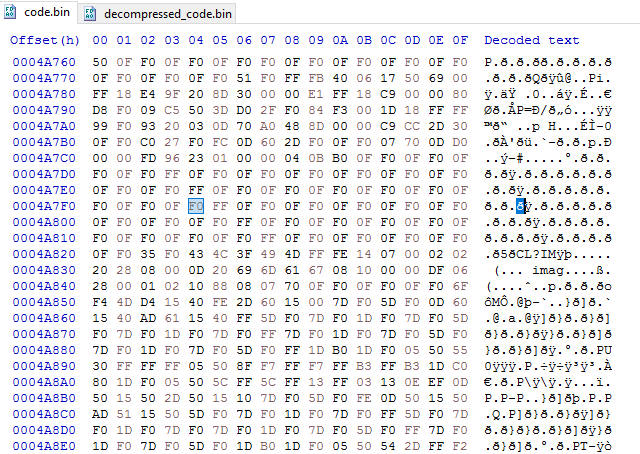

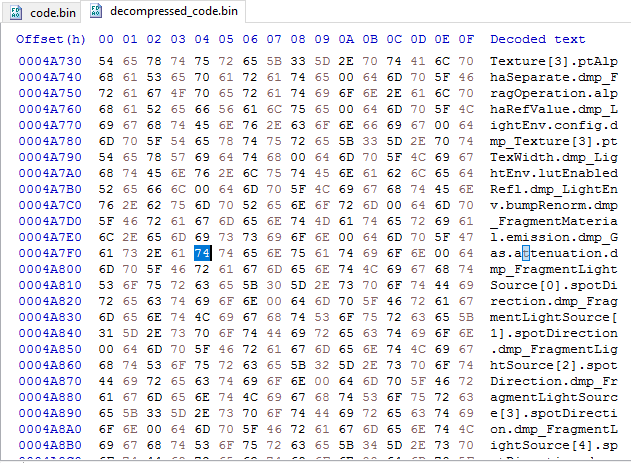

Not working on 11.10 N3DS - 4A7F4 is right in the middle of a block of strings, and there's no "004EFCA5" anywhere in TwlBG's executable (compressed or not)...
It's not in the middle of strings, but there are some strings around it. You don't search for "4A7F4" or "4EFCA5", you go to (CTRL-G in HxD) the address 0x4A7F4, and check if the bytes around the cursor are 00 00 00 00 00 00 00 40 00 00 00 00
Once you find that pattern, you select the pattern, and go to the end of the last zero, and then you overwrite the bytes there with
000000000000000000000000000000000000000000000000000000000020004000400040004000200000000000000000000000000000000000000000
Yeah, I knew 4A7F4 is supposed to be the address, but...
View attachment 172326 View attachment 172327
Oh no, they updated the binary :(
Also, how did you manage to get code.bin but compressed? If you followed my tutorial then code.bin should always be decompressed :unsure:
But anyway, try to find
00 00 00 00 00 00 00 00 00 00 00 00 00 00 00 00 00 00 00 00 00 00 00 00 00 00 00 20 00 40 00 00 00 20 00 40 00 40 00 20 00 00 00 40 00 20 00 00 00 00 00 00 00 00 00 00 00 00 00 00 00 00 00 00 00 00 00 00 00 00 00 00
instead, and count 60 (as in, 0x3C) bytes backwards from the start of this pattern. There should be only a single find for this pattern.
