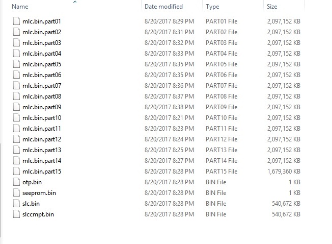

Can a hardmod restore the HYNIX MLC?
This is what I have backed up.
While is true that restoring a NAND backup can fix your problem if you have data corruption, your NAND has reached the end of its lifespan as far as I can see. Gary pointed to a line in the log that says
00:00:30:623: FSA: ### MEDIA ERROR ###, dev:mlc01, err:-2228230, cmd:11, path:(null)
If I understand correctly, "MEDIA ERROR" means that your chip is damaged and can't retain the integrity of data anymore, so I don't think restoring the NAND will help.
This seems further implied when random data like amiibo settings or the fonts of Cafe OS became corrupted with no apparent reason.
Robotron2000
Apr 30, 2007
17
95
So the only real solution is a new base unit or chip replacement which is not happening. It doesn't even make sense to buy a replacement unit because who knows how long that will last.
Thanks for the feedback.

i have a very big problem some time ago i went in the mlc folder and deleted the font files i dont have any autoboot cfw i only have mocha i dont know if wupserver can fix the wiiu i will attach the logs (i dont have any nand backup)
You can grab a WUP for the fonts using JNUSTool (Title ID: 0005001B10042400), place the files into the install folder, and use the "Install WUP" option to reinstall them.
I suggested before to have a homebrew loader throught UDPIH. If it work, we could probably use RedNAND to have a MLC-bricked Wii U to sort of work again.
If we ever have a method to properly coldboot redNAND, that would be an option for MLC-bricked Wii Us.
