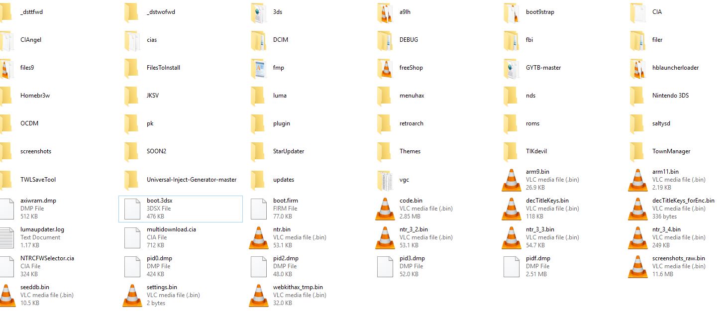

i tried to update mine from a9lh to boot9 and now it wont even turn on
Remember: The 3DS turning off right away is a clear sign that it is NOT bricked. A bricked unit would stay in blackscreen or show the feared bluescreen. You did something wrong, @godden18, and I guess everyone who voted for a brick here is similar to your case.

yeah thats what mine does. already got the boot.frim on the root but still doing the same.
this is what the root of my SD CARD look like
Looks good to me, maybe try a different SD card? Also, the 3DS card reader is not the best quality and sometimes wonky, maybe because it was never intended for regular SD inserts / ejects.
ah ok it was working fine and has been for the last year untill i tried to update to boot9

ok ive got it to boot up again since putting the old arm9loaderhax.bin back on the sd card. whats would cause this to of happened?
The cause is you not installing boot9strap properly and on top of that ignoring red error messages... Want to take your vote back now :P? (hint: you can't)

The cause is you not installing boot9strap properly and on top of that ignoring error messages... Want to take your vote back now :P? (hint: you can't)
i have not voted anyway, and no errored appeared on the screen. I followed the guide word for word
