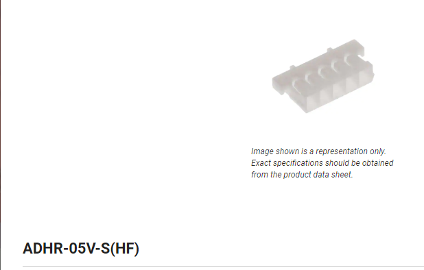

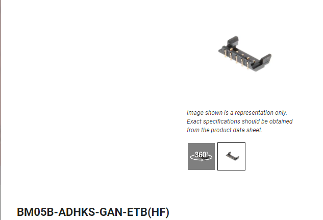

Not sure the black piece or the white piece you saying is broken, but both of them can be replaced.

Yeah, I figured it's probably not worth risking. I never micro-soldered and don't have any tools (I do have access to hot glue), so altough learning to solder could be a fun and mostly risk-free experience (since it's essentially a brick now), it's probably smarter to take it to a repair shop or get a new one. Thanks for the help.
And I did use ISA for the battery, but it was still difficult to take out :/
The part that broke is the one in the second picture. The pins are still intact, it's just the plastic.

The hot glue solution will in fact work as a last resort. As long as you can line everything up it will be fine.

This. If the pins are all in tact, you just need to keep them together. They should have some level of retention even without the side latches on the black part. I'd suspect even some kapton tape and perhaps a thermal pad on top would be enough to wedge it against the backplate and keep it stable. You won't get a house destroying fire out of the Switch battery but you could get some nice fireworks and burned carpet/countertop if dead shorted. I'm not sure how you would do that so long as the pins on the black connector are still in good shape and you don't mangle the white connector.
