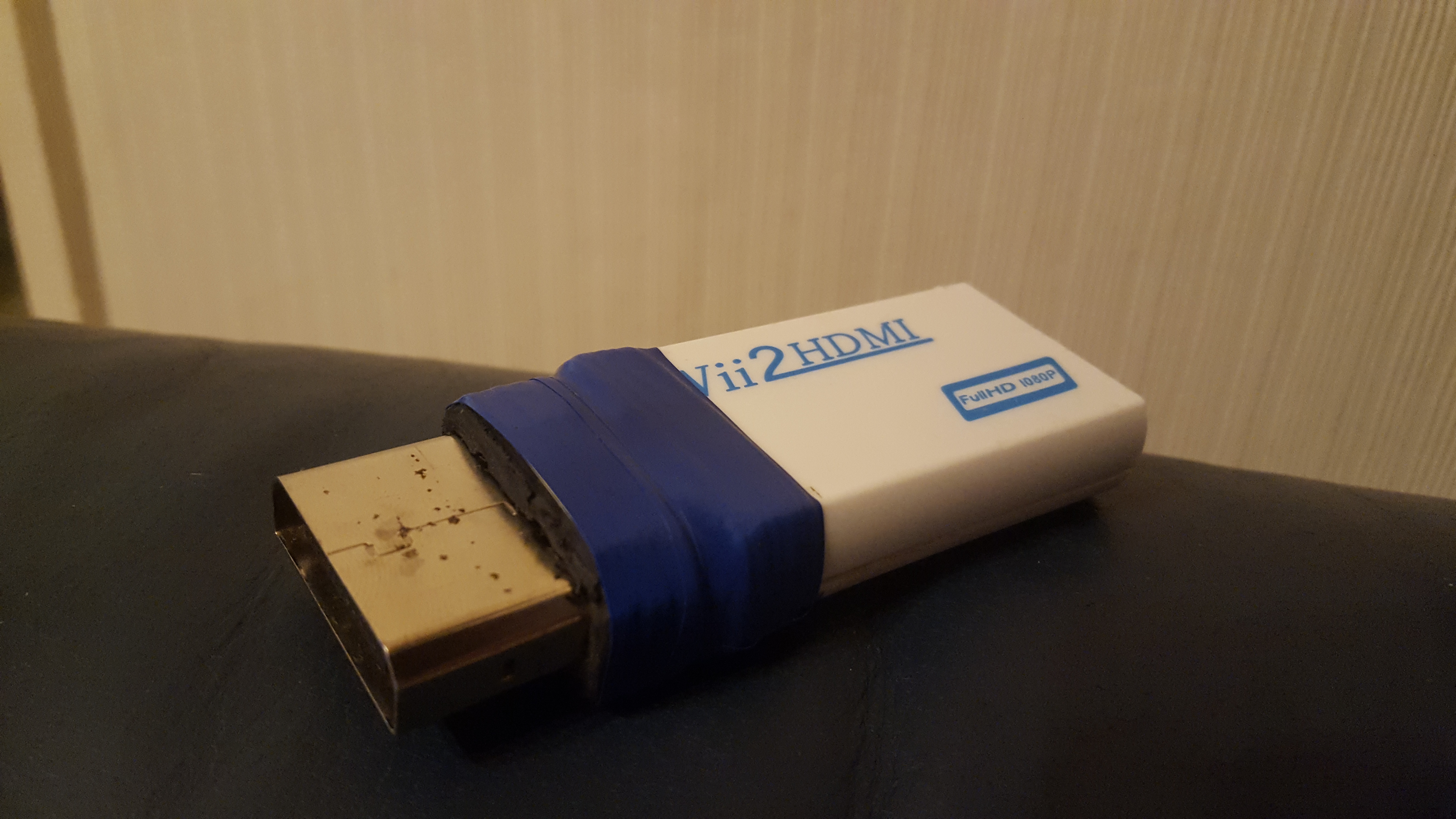

I made one of these adapters and it seems it cant do more than 480p and looks quite a lot worse than component. I followed the wiring diagram from this page https://www.ogxbox.com/forums/index...i-diagram-wiring-schematic-component-to-hdmi/
I guess theyre good if your display only has hdmi input but if you can use component theres no point in making one
Bit of a bump :P I just did this mod and I'm seeing an improvement over my (admittedly cheapo) Component Cable :)
Still very impressed with the quality, definitely worth the £3.50 for the Wii2HDMI :)
20210924_192532.jpg :D :D :D :D :D :D :D
