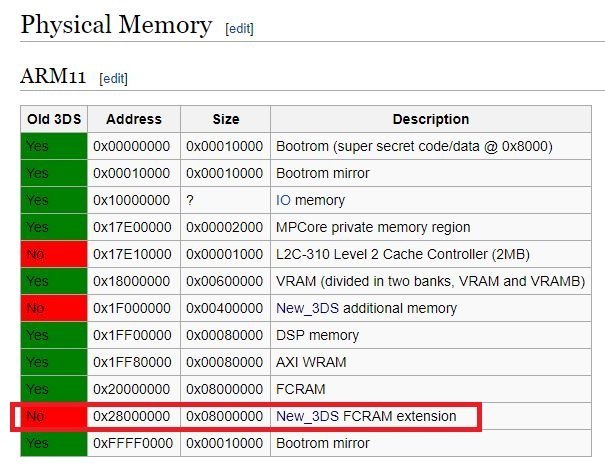

You are dealing with hexadecimal here, and 2x 0x08000000 = 0X10000000
And your change to FCRAM_PADDR sutff doesn't even change anything because they will compute to the same result.
Hang on use caluclator, number seems bigger then that
0X10000000
0x100000000
Compiling, will post test.
Basicy it is the same result.
