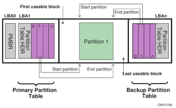

The MBR and GPT are co-existent on the drive. But the MBR is only stored in the first sector of a drive. GPT is stored in the second sector and has a backup in the last sector of the drive.
If you want to restore the data. On Linux exist dd or dd_rescue to create 1:1 raw images of the drive, it will copy it bit by bit independent of the used filesystem. Then you might try restore the MBR and have a backup in case it goes wrong.
In case the MBR is corrupted Testdisk on Linux can be used to resore it.

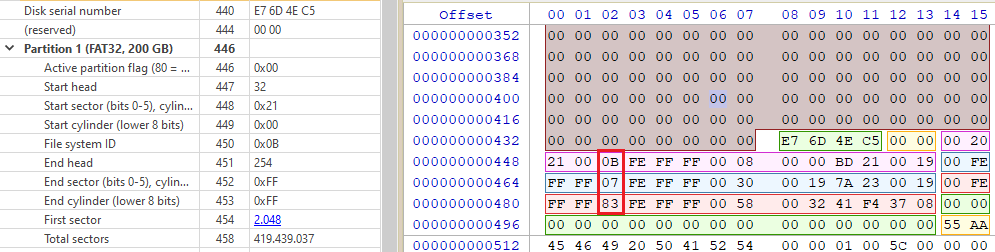

Manual methodes to hide/unhide a drive for WiiU beside Ustealth/USBHide :
Check the Signature value of the MBR :
  1. First you may use on Windows fsutils, on Linux (WSL?) blockdev or fdisk to verify the used secor size (512 or 4096).
  2. Then run on Linux : # dd if=/dev/sdX of=mbr.dmp bs=512 count=1
    • (if=/dev/hdX) = your drive, (of=mbr.dmp) = output file, (bs=512) = sectorsize, (count=1) = 1 Block to read
  3. View the hole file : # od -t x1 mbr.dmp | less
  4. Or view only the last six lines : # od -t x1 mbr.dmp | tail -6 55AA tells the system its a MBR.
  5. A hex editor can be used to edit the data and finally writing it back with dd.
Hide/unhide the drive under Linux:
Verify you choose the correct drive by using # df command. The driveletter is displayed as /dev/sdX (use without number, instead of /dev/sdx1 /dev/sdx2 etc...). /dev/sda is most likely your boot disk, so NEVER use that one!
  1. First creae a lokal backup of the MBR by running as root (sudo) :
    dd if=/dev/sdX of=/home/username/mbr.bin bs=512 count=1
  2. Next edit the mbr.bin with an hex editor, eg. use ghex. And change the last byte at the end of the file in offset 0x1FF from 55 AA to 55 AB and save it as mbrhidden.bin .
    Run # ghex mbr.bin -> go Edit Option -> Substitute -> Find string (AA 55) / Substitue (55 AB) -> Verify the red marker is at correct position, else klick "keep search" - > Subsitute and save the file as mbrhidden.bin
  3. Write it back to the drive again to make it hidden, be absolutely sure you are using the correct drive or you will end up with an unbootable system.
    dd if=/home/username/mbrhidden.bin of=/dev/sdX bs=512 count=1
    And unplug the drive.
  4. If you want to unhide it again simply write the original mbr.bin:
    dd if=/home/username/mbr.bin of=/dev/sdX bs=512 count=1
    And unplug/plug the drive
Hide/unhide the drive under Windows:
Active drive editor is tool with GUI to view and edit the bootsector, is available under Windows and Linux and edits the MBR directly on the drive without creating a local backup.
Change the last value (yellow value in offset line ..00496) to 55 AA to unhide it, or to 55 AB to hide it
  • Open the tool -> open the CORRECT disk -> Right Klick -> Allow edit content -> mark the value with mouse -> right klick -> Fill block -> Enter HEX value 55 AA or 55 AB and hit OK -> Save, it will write the changes to the drive -> unplug and replug it.

there is also the GPT table in the other sector.
No, most likely there isn't. Drives < 2 TB generally get an MBR but no GPT. In other words: Having an MBR on a GPT disc is part of the GPT standart: This is a fallback for devices not understanding GPT... But having a GPT on a MBR drive? That would be an exotic case you won't find in real live.
Also you're still mixing up MBR and Superblock: Restoring the MBR from the superblock might be possible but to find the superblock you need the MBR, so it would be pretty hard to go this route (esp. when there's more than one partition on the drive).
//EDIT: Then again the simplest way to restore an MBR is to, well, not restore it but recreate it from scratch. When there's just one partition on the drive this is plain stupid, when there are multiple you should remember the exact size of each partition... So restoring the MBR of a multi-patition disc is way more hard but on a single parition disc, like the one for vWii, it is damn simple. Again: Just use a low-level tool like fdisk which creates partitions without formatting them (or touching the data inside of the partitions in any other way). All the MBR is is a map, it maps the starting and ending point of the partitions on the drive... In 99% of cases a one partition drive has this single partition spanned from the beginning (ofc. after the MBR + some offset defined by the drives blocksize) of the drive until the end, so really, really simple to recreate.
//EDIT²: But even if the partition wouldn't span over the whole drive this is no problem as long as it begins where expected: A partition is allowed to be larger than the filesystem it holds. ;)
//EDIT³: And even if the beginning of the partiton isn't where expected recreating the MBR with fdisk won't hurt, it will just put you into the exact same state you where before: Having a MBR which missmatches with the real partition layout... So a corrupted MBR... ;)

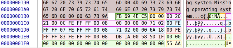

//EDIT: You might try this first :
Make the drive appear :
Use this tool Activ Disk Editor below to view the MBR details of the drive, if the last value is 55 AB (yellow value in offset line ..00496) it can be edit to 55 AA and maybe the drive will work again if there is not another issue.
Open the tool -> open the CORRECT disk -> Right Klick -> Allow edit content ->mark the value with mouse -> right klick -> Fill block -> Enter HEX value 55 AA and hit OK -> Save, it will write the changes to the drive -> unplug and replug it, the drive and its partition should appear as normal. If issues persist, NOW a repair of the MBR e.g. by Windows can be tryed.
Restoring the drive for new use (data loss) :
If its just that using your drive again and the data dont cares you. You can use every available tool/application to reformat it. You might run on Windows in Powershell bootsect /nt60 X: /mbr (X = driveletter) to restore the MBR, but every data will be gone. If you dont have a driveletter just go to Windows drivemanagement, choose the drive, choose MBR and format it. Then run chkdsk X: /r to check for filesystem and sectors for errors which will be corrected. Additonal you might run h2testw (write + verify) to verify the drive is not corrupted. The checks will take some time. There exist multiple applications to format a drive, e.g. Windows Diskmanager, Aomei Partition Manger oder Minitool Partition Wizard, Linux Gparted or other.
55 aa is fat iirc 55 ab is stealthed
Some correction. 55AA is the identifier to tell the OS its a MBR, the filesystem type is stored in another position. In this case 0x0B is Fat32 (no LBA), 0x07 is NTFS and 0x83 is ext4. With Active Disk Editor you can shown the Details of the MBR and it has also access to it if the drive is unrecognized .
