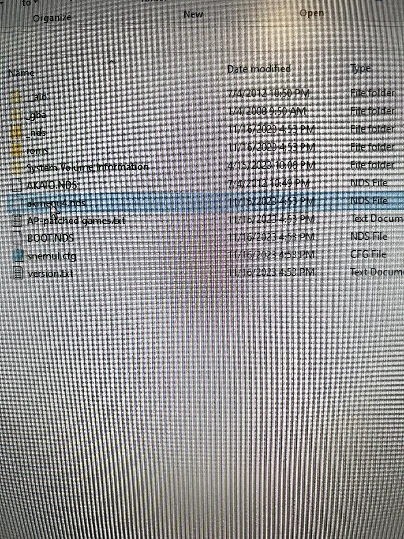

I am currently using and R4i (r4ultra) flashed as Acekard 2i to autoload TWiLight Menu. I would like to be able to toggle between the nds-bootstrap and the AKAIO loader without needing to restart the device. I can launch either AKAIO or TWiLight Menu from within each loader but when soft resetting whichever is functioning as primary loader will be the one loaded. Autobooting TWiLight Menu works as intended, however when launching into AKAIO when I exit a game it will reset to TWiLight Menu (by design). I would like to know if there is anyway to return to the whichever kernel is loaded unless loading the other kernel manually. I apologize in advance if my attempted explanation is confusing. I figured I would reach out as AKAIO (or any other flashcard loaders for that matter) is longer in active development. Thank you.
I thought it may be a longshot, but I thought maybe the reset code for TWiLight Menu could be modified to look for either BOOT.NDS (Autoboot) or DEFAULT.NDS or something to this effect when not in autoboot config.
Hopefully @lifehackerhansol can shed some light on my inquiry. Thank you for your response.
EDIT: I have found a way to use Acekard 2i or R4i (r4ultra) flashed as Acekard 2i and enable toggling between loaders. The key is to just place the base flashcard TWiLight Menu ++ files on the microSD without utilizing autoboot. This will enable the user to boot AKAIO loader (akmenu.nds) as the primary loader and launch the TWiLight Menu ++ (BOOT.NDS) file manually. Exiting games this way will allow you to remain in either loader until the associated .nds file is manually loaded. Saves are in different locations however and I have noticed save file sizes are considerably smaller for TWiLight Menu ++ as compared to standard flashcard loaders saves. Still this will enable the user to toggle between loaders to maximize compatibility without having to shut down and restart the device.
This is kind of a hack. It works because nds-bootstrap resets to BOOT.NDS, while AKAIO resets to akmenu4.nds. So it's by pure chance this actually functions right. (It probably does work for most carts, too, since pretty much no cart boots from BOOT.NDS)
The "correct" way to do it would require replacing akmenu4.nds with some custom code that automatically boots to the last menu you selected unless you hold a button. Which doesn't exactly exist.

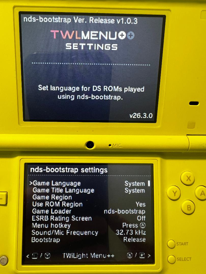

I am trying to use nds-bootstrap. I am using autoboot.
When I mentioned kernel I mean without using Twighlight Menu the standard kernel will load some games. Although the standard kernel has horrible compatability. Haha
That doesn't answer my question. I'm asking if you've used the kernel by switching the "Game Loader" setting to "Kernel" or by not using TWLMenu++'s autoboot files.
I have not tried kernel yet. Will do once I return home. Thank you.
Edit: I manually boot into TWiLight Menu set "Game Loader" to kernel and get the error for unsupported flash cart
Manually booting into TWiLight Menu with "Game Loader" set to nds-bootstrap and utilizing the release version I was able to get a rom to load. However, changing only from manual to autoboot results in rom white screen.
Edit 2: I am noticing the rom takes extremely long to load in comparison to other flash carts. I will try multiple microSD and see if anything changes. I will also retry autoboot and give it plenty of time to account for the slow rom load I experienced in manual mode.
Edit 3: Tested with multiple size and speed microSD with about 3 different games. This card is terribly slow but does indeed function with TWiLight Menu++. Thank you for your patience and support.
