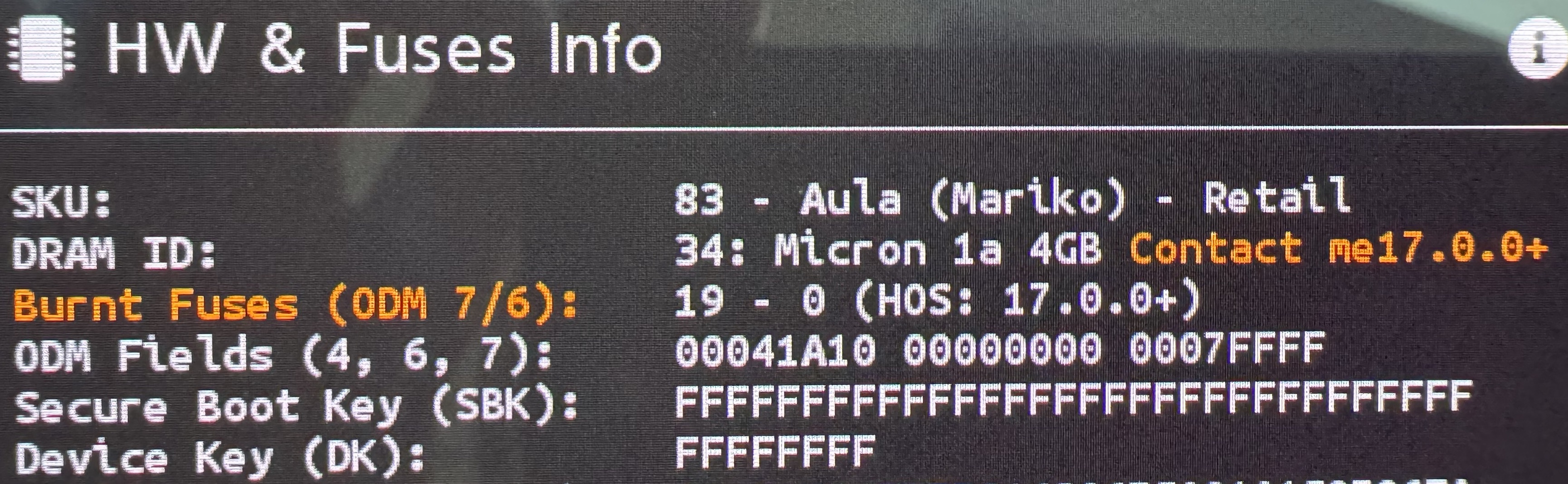

Me having the almost same symptom. Help me, Please. BTW, your invitation link has expired.
My console info is as below, brand new Mariko bought days ago.
