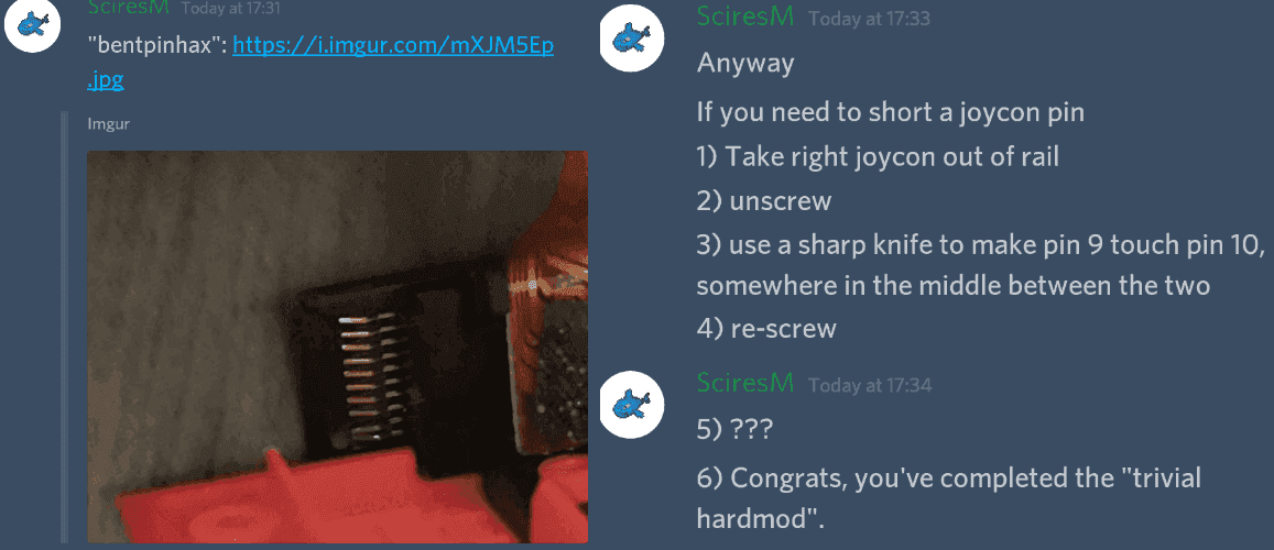

...Boot the Switch in RCM mode. There are three ways to do this, but the first- unseating its eMMC board- is likely the most straightforward:
1. Ensure the Switch cannot boot off its eMMC. The most straightforward way to to this is to open the back cover and remove the socketed eMMC board; corrupting the BCT or bootloader on the eMMC boot partition would also work.
2. Trigger the RCM straps. Hold VOL_DOWN and short pin 10 on the right JoyCon connector to ground while engaging the power button.
3. Set bit 2 of PMC scratch register zero. On modern firmwares, this requires EL3 or pre-sleep BPMP execution.

What I don't see now, do I need to open the switch? Screw something off? Or can I do this short circuit just like that?

So if the pins are shorted and no button combination is pressed, will the console simply boot as usual? Having a button combination to enter recovery mode sounds perfectly reasonable as long as we don't need to mess with the pins every time.

So going by iPhone terminology, it’s semi-tethered rather than tethered? I have no issue having to send the payload by USB every time as long as I’m not opening the Joy-Con every time.
As long as having a PC near to you to send the payload every time you power cycle is not a problem for you, then you are good to go, I guess.
