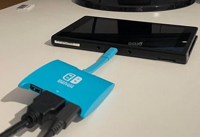

If I knew how to make the circuitry (or at least wire the trinket into an external case for this) I'd do it, honestly.
Same, haha, I feel like its a good alternative to opening up and voiding warranty. Also easier and probably(?) cheaper.
Imagine a device like this, lower profile, ideally smaller, with only 1 USB-C port that can both charge and inject where necessary. Since the cable is flexable I could bend it and stick the device to the back of the switch, and voila.
Only problem is say goodbye to tabletop mode.
