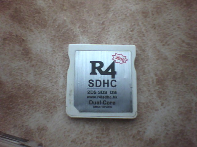

hello guys i was trying to update the firmware of this r4 in the picture from wood v1.72 to a newer one but now i get a wight screen with and without an sd card in it can you please help me to fix it?

Are you sure the firmware you were applying is for the right cart? There is also a difference between r4isdhc.hk and r4isdhc.com
Anyways, the card is probably bricked, there is potentially a way to unbrick it using a 3DS with ntrboot_flasher, if you can find a backup/dump of a working firmware for the same cart (ntrboot_flasher won't accept the firmware update files from the manufacturer)
Another potential fix, is if you have a second flashcart, put the firmware update file on it and launch it then swap to the bricked cart. But that will only work on a DS Phat or Lite (cart hotswapping will just reboot a DSI or 3DS), and if the firmware update is not a .3ds that can be launched, that's obviously not possible.

thank you so much for your help, and i think i use a wrong firmware this is the information on it :2016 R4 SDHC 2DS 3DS DSi www.r4isdhc.hk DUAL-CORE SMART UPDATE and the firmware files are:( _ gba folder and _ds_menu.dat file ) i have a rom folder and app one, yes i think i break it , i have a light ds and an o3ds , can you please guide me to fix it, that you again

Those are not firmware files, that's just the kernel, it shouldn't brick the cart since they're not flashed to the cart, they just get loaded from the SD at boot.
Was that all you installed? The firmware is usually a separate download, in the form of a single file (a .nds that you put on the cart and load, or a .bin file you put on the cart which gets detected by the kernel automatically and it will ask you to update when you boot the cart)
Edit: This is the latest version of the official page I could find:
https://web.archive.org/web/20170509112145/http://www.r4isdhc.hk/download_white_new2014/index.htm
But it says it's for the 2015 version, and the website went down after this so there is no newer version that's been scraped by Wayback Machine. Presumably the 2016 version uses the same firmware (the 2014 version also uses the same one)
Anyway, as you can see, the kernel and firmware are separate downloads. You can try the latest kernel version from there, and see if it gets rid of the white screen. The firmware download won't be any use unless you can actually get the cart to boot (or you get a second flashcart to use to flash the bricked one)
You may also be able to use TWLmenu++ to load the firmware update on the 3DS without the need for a second flashcart. I'm not sure how/if that works exactly. If your 3DS is hacked, it's easy to install, look at the instructions in this thread: https://gbatemp.net/threads/ds-i-3d...-ds-i-games-and-ds-i-menu-replacement.472200/
If your 3DS is not hacked, start here first: https://3ds.hacks.guide/
But I don't know if it will work through TWLmenu++ like that, it can't hurt to try though.
The ntrboot_flasher method will only be useful if somebody with the same cart has backed up their firmware with that tool and are willing to share their files. For now, there's not much you can do with that.

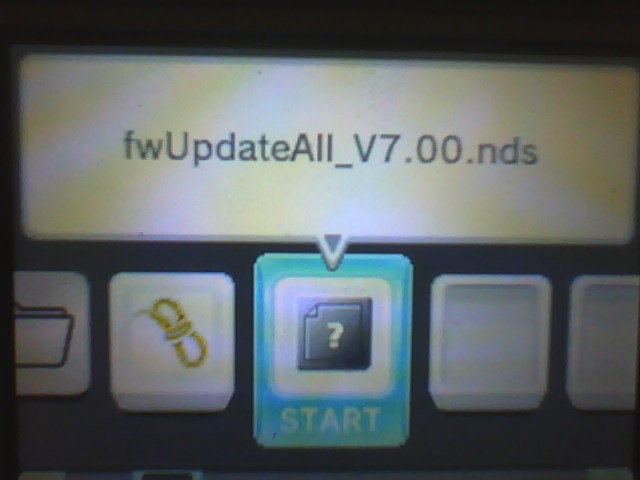

i lunch this file from the twinlight++
it tells me that my current version is v0.00, i continue with A

View attachment 353122i lunch this file from the twinlight++
The file was probably too large, so it didn't get indexed by Wayback Machine. At least the firmware link works. The usual site for getting kernels for DS flashcarts (linfoxdomain) doesn't have r4isdhc.hk listed at all.

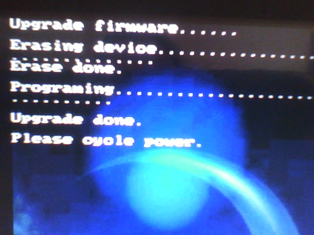

after that i get this screeni power off the 3ds but no things change and when i try it again the same happen your current version is v0.00 puch a wait but no thing??? so please help

View attachment 353125after that i get this screeni power off the 3ds but no things change and when i try it again the same happen your current version is v0.00 puch a wait but no thing??? so please help
I've read some other info suggesting these carts can't be unbricked once bricked. Well, at least they're cheap.
If you get a new flashcart, you can try if you are able to unbrick the old one with it. And if not, at least you are left with 1 working flashcart.
