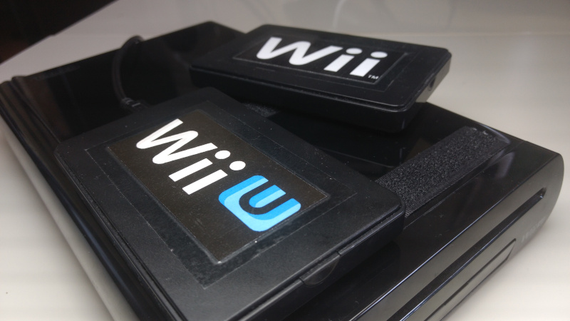

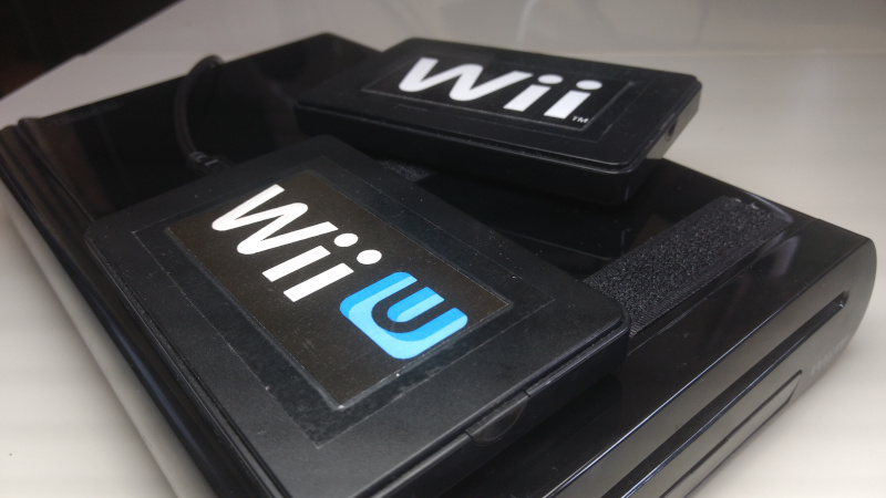

Why don't you try your "good" HDD on the wiiU and put a label on it to mark it wiiu or vwii ?
hook-and-loop fastener to attach/detach the HDDs to the console's case:
Reactions: toxic9 and pin
