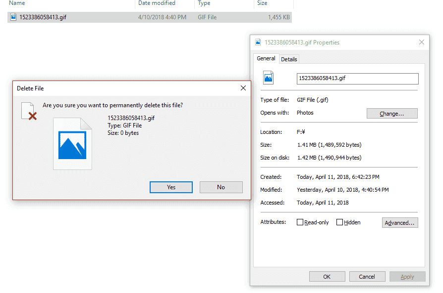

Any ways I can diagnose the problem? I'm able to read and write from it just fine, however when I try to delete files from it, everything deletes and reads just fine, but they show up as 0 kb in the dialog box. Nowhere else, just the dialog box.
Something wrong with the file allocation table?
Right click the flashdrive icon on your pc then go to format.Does it say fat32?
D
Deleted User
Guest
I've done that. I've formatted it as Fat32 twice already, and it's still Fat32. I know it's fat32, too, because the PS3 is able to read from it, and recognize it, as well as write to it. It just isn't writing my Act or IDPS.
