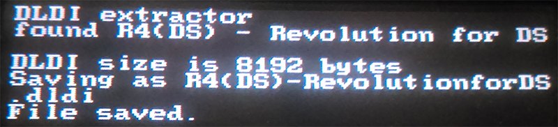

Found a really bad R4 clone that is giving me trouble
Yeah I'm not telling where I found that thing but that does look like a stamped fingerprint in the isolating blob
Anyway... I'm trying loading YSmenu from the .nds file after booting the native kernel, YSmenu actually loads but when I try launching a game it ends up in an infinite loading after creating the .sav file
Maybe if someone takes a look at the kernel files Here could help figuring out what I'm doing wrong or if it's possible to get YSmenu working on that thing at all.

Have a look for dldiextract.nds. It might not be easy to find but I can't post links. It will dump your DLDI file (obviously run it with the stock kernel) to the root of your MicroSD. You should be able to identify what it is actually a clone of, and from that and find the right files for your card. Mine is a TT clone, not that you'd have any idea from looking at the file names in the stock kernel.

Thanks dude that's gonna be a really useful way to identify clones in the future
sadly it confirmed that this one it's a really crappy R4 clone... don't think I can even get wood running on this thing let alone playing pokemon black/white 2
