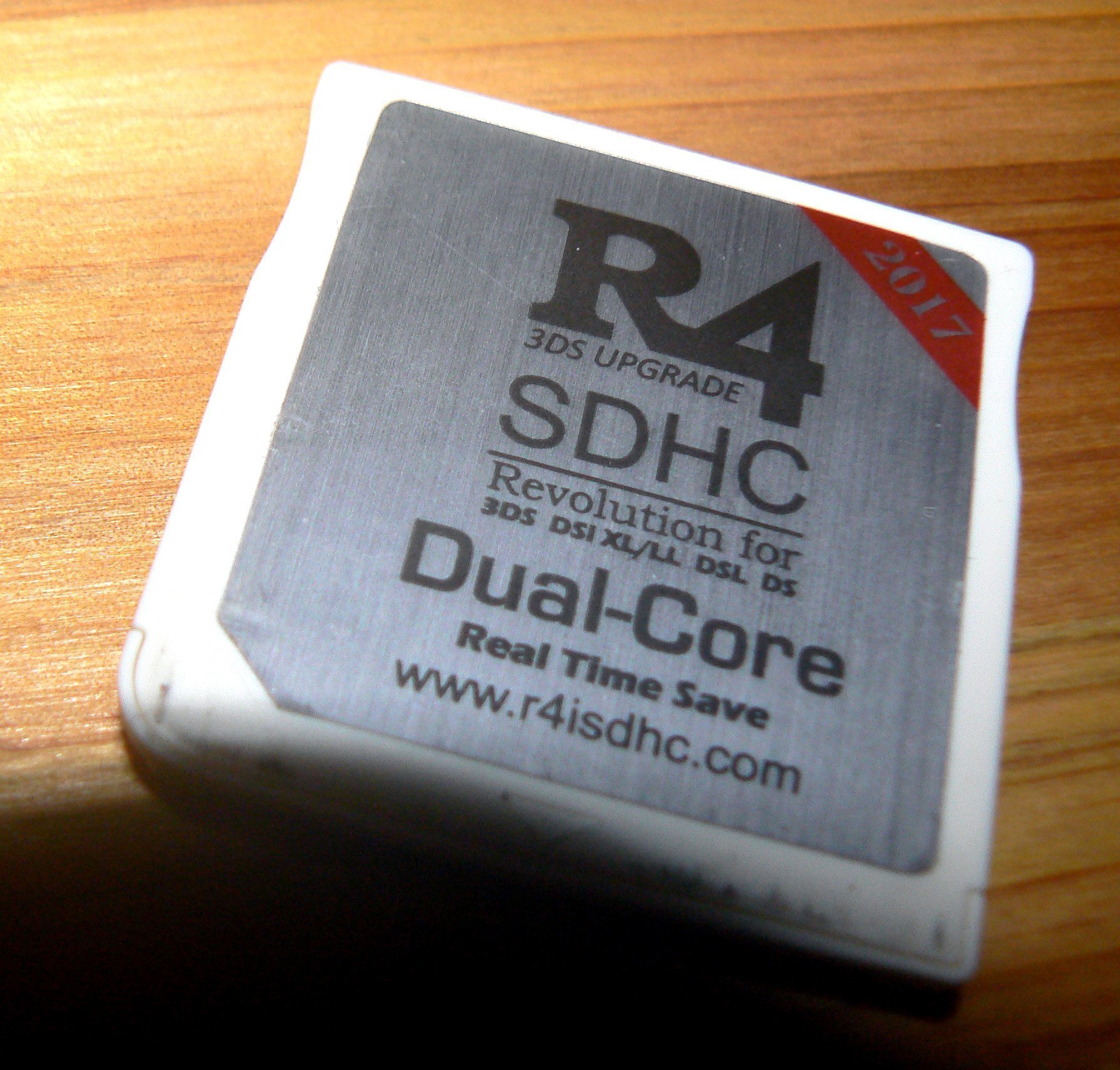

The Cart: R4 Clone from http://r4isdhc.com/
I´ve updated from 7.04 to 7.05 (backup and delete the TTMenu Folder and copied over all files from the RetroGameFan Multi Cart Update v7.05 to the R4 Clone Folder).The Menu works fine,Games boots/working better than before (a lot of Games now running:)).
