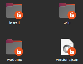

I've tried to put the micro SD card without the adapter in my computer and there's locked icons on all the files and folders and then I try to make a new folder it says that it's read only.
Does this mean the micro SD card is dead/read-only forever?
Well flash media does have a limited number of writes. It's unlikely to reach this however unless data was constantly being written to it. Since you are on linux I would check it out using sudo fschk
