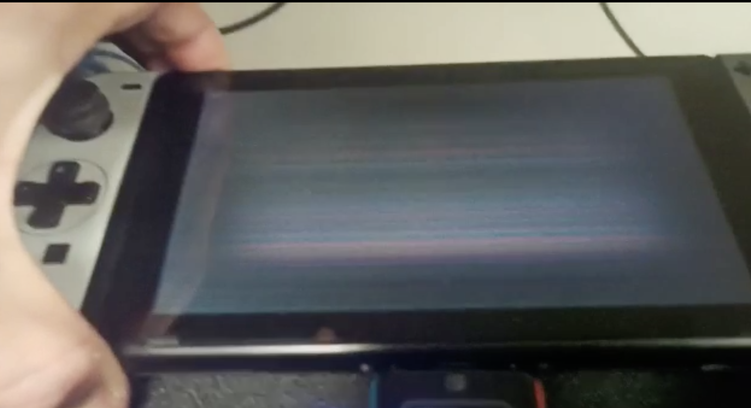

Posting here since it's more appropriate.
After updating CFW with daybreak, atmosphere, hekate and whatever was in the rentry guide, my switch boots up fine using Tegra rcm, I updated my hekate file in the rcm loader and made sure AUTORCM is on, the blue light goes on indicating that its injecting, the console turns on but the screen is showing weird lines like it's corrupt or something.
I tried resetting the loader multiple times, made sure the Hekate file is the latest, tried using an older Hekate, but nothing seems to work.
FYI, when using green or red mode, the screen shows correctly that there is no payload in either, the usual message I remember getting before, also, before updating, the rcm loader worked fine.

Is there any file or log I can post to direct for problem solving?View attachment 344922
Didn’t you do some work replacing your screen a while back? I’d venture your odd screen issues are more closely related to that than they are related to a boring CFW upgrade that has nothing to do w/ screen artifacts.
Yes I did, but it worked fine up until I updated the firmware.

I would look into you screen connections. Software isn’t going to make scan lines on your screen. Something has come loose.
Everything other than injecting an hekate payload ONLY through the rcm loader, works completely fine, how could this be a screen issue? Could it be that the rcm loader is defected?

Was basing it off this “but the screen is showing weird lines like it's corrupt or something.”
Let me get off mobile and watch your video…I might be misunderstanding what you meant.
e: Unfortunately, I didn't misunderstand. It looks kinda like I imagined a hardware issue would look.
Anybody else want to chime in and tell me they've seen Atomosphere, Hekate or Firmware cause an interference pattern like this?
IMO this looks like something is loose or fried in the hardware layer.
Change my mind...
I 100% agree that this looks like hardware failure, however, how is this explained when everything else works, even other payload modes through the rcm loader!, on top of the fact that up until the update, it worked fine!
I tried resetting the RCM loader with a pin, i felt like it pushed something in too far so it might be that, at the same time though, payload 2/3 (green, red), show a normal readable image.
