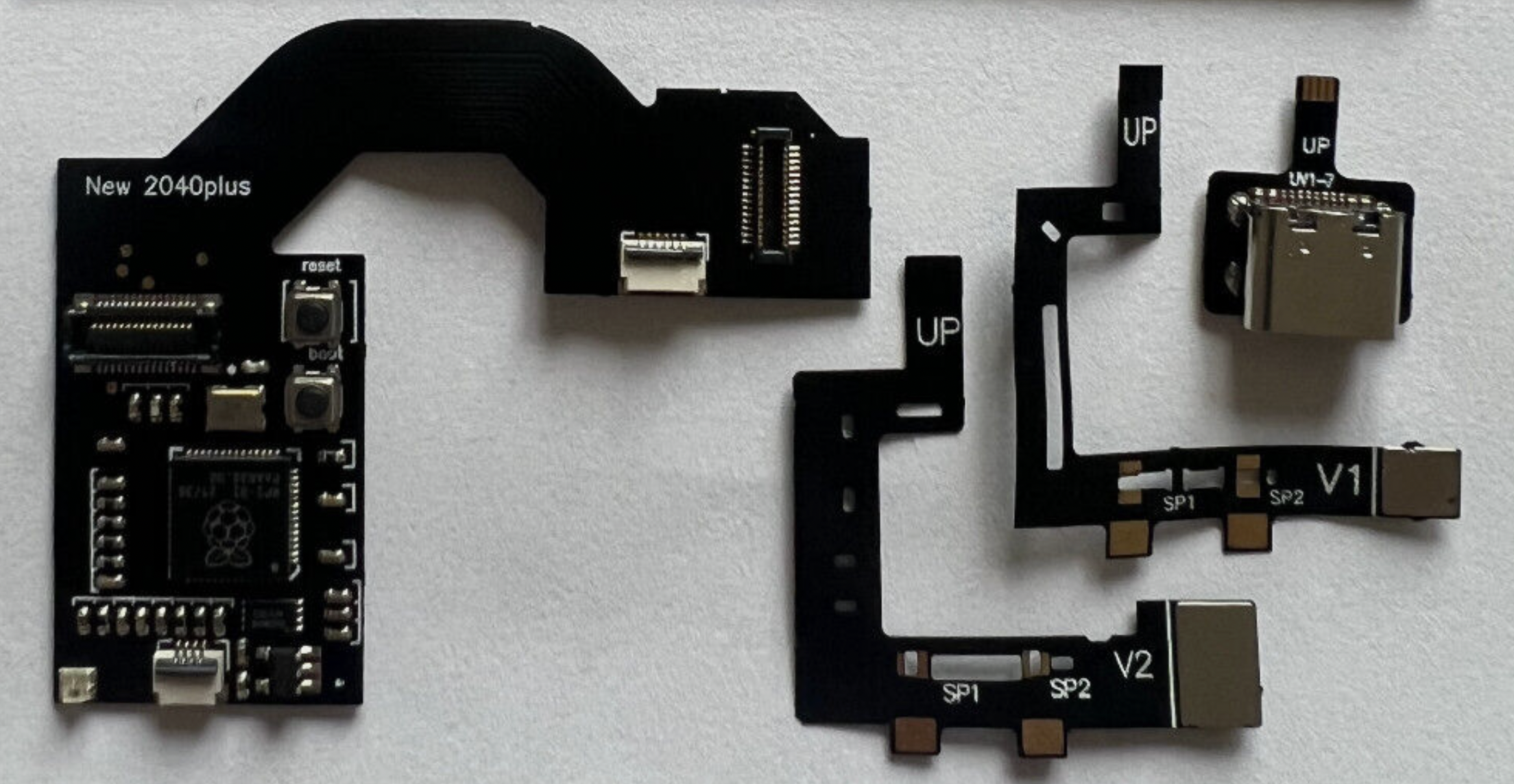

mhortet
Jan 24, 2021
4
34
36
Netherlands
Hey guys. I am struggling to identify if this specific modchip will work with my machine. Mainly because of that "New 2040plus" legend, which is different from the chips I see in tutorials. Is it just because this is a cheaper clone?
Also, the machine is a V2 on firmware 17.0.0. Should I expect any problems if trying this modchip?
Thanks :)

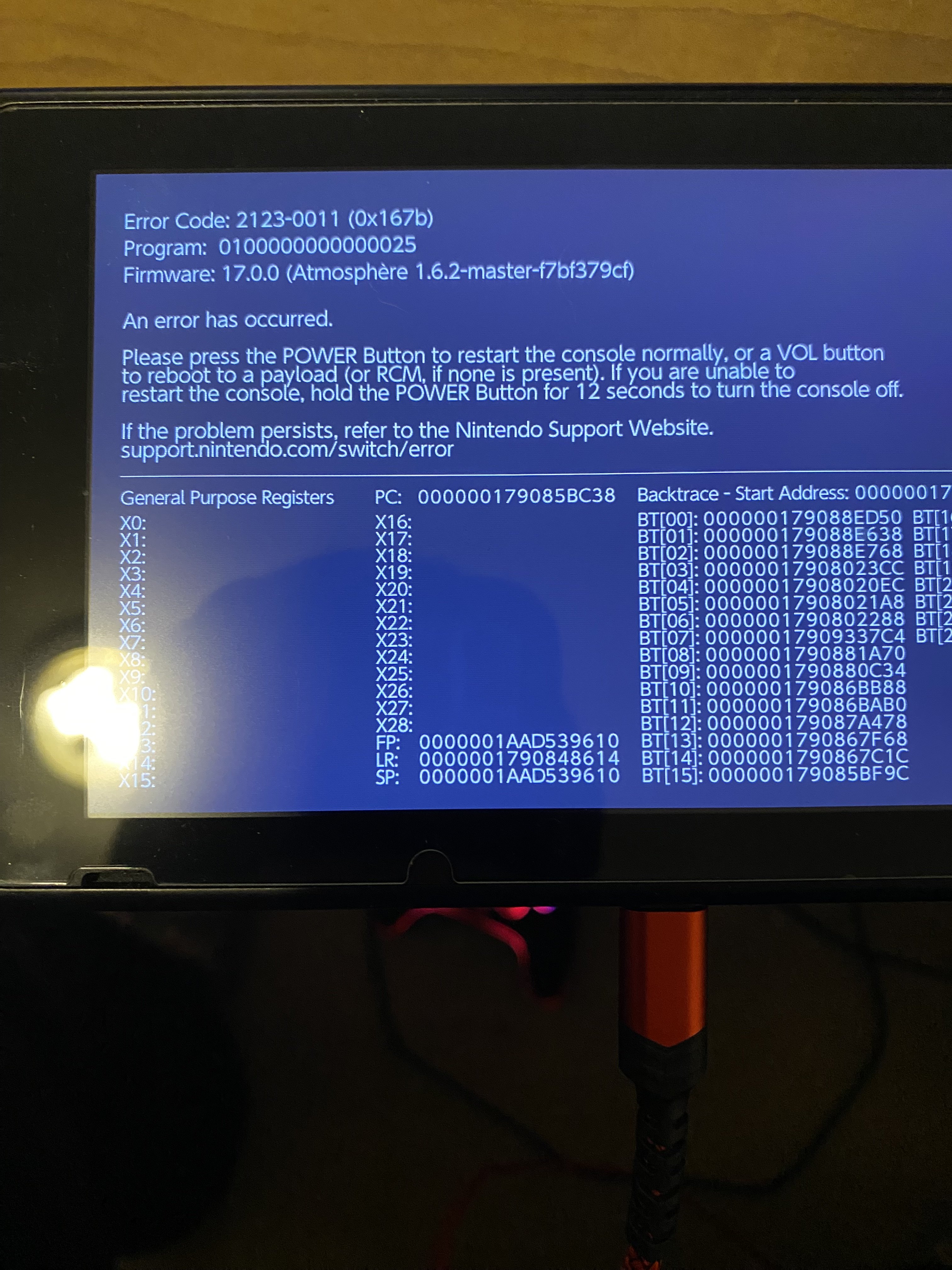

codezer0
Gaming keeps me sane
Jul 14, 2009
3,580
The Magic School Bus
4,550
I always had airplane mode on before. I only use a usb ethernet to get online for the AIO updater and the hb app store thing.
As I posted earlier, I was updating other stuff and then was updating to 17.0.0 on the emucfw. I don't even get a blink of the switch logo splash screen before it crashes to the same error.
Now I can't do any of that, because it won't effing turn on when I power cycle. And when I do manage to turn it on, it just gives me that atmosphere error screen.
Okay this is making no freaking sense to me.
Finally able to make time to try and tinker with the switch more. Still kept the 256gb sd card how I had it before I upgraded to a 1tb one. Didnt finish booting, but the fact it would at least boot shows promise.
Redownload and re extract atmosphere to the sd card. Plug in rcmloader again. AS I HOLD IT IN MY HANDS it is booting again, and able to reach the switch os with the updated atmosphere and firmware.
But literally the moment I put it back on tbe dock to charge, it ABSOLUTELY WONT! All I get is this effing error.
Dust2dust
Jun 17, 2010
2,427
4,399
Your error is literally the same as shown in this thread. Try to apply the same fix he did (don't blank your serial number).

I'm sorry, what is exosphere?
If you have a file named exosphere.ini in your atmosphere folder, open it with a text editor, and check if blank_prodinfo is set to 1. If it is, set it back to 0 and reboot Atmosphere. Or you could just delete the file altogether. Your serial will be unblanked. Don't get yourself banned. Use an alternative method of blocking Nintendo servers.
