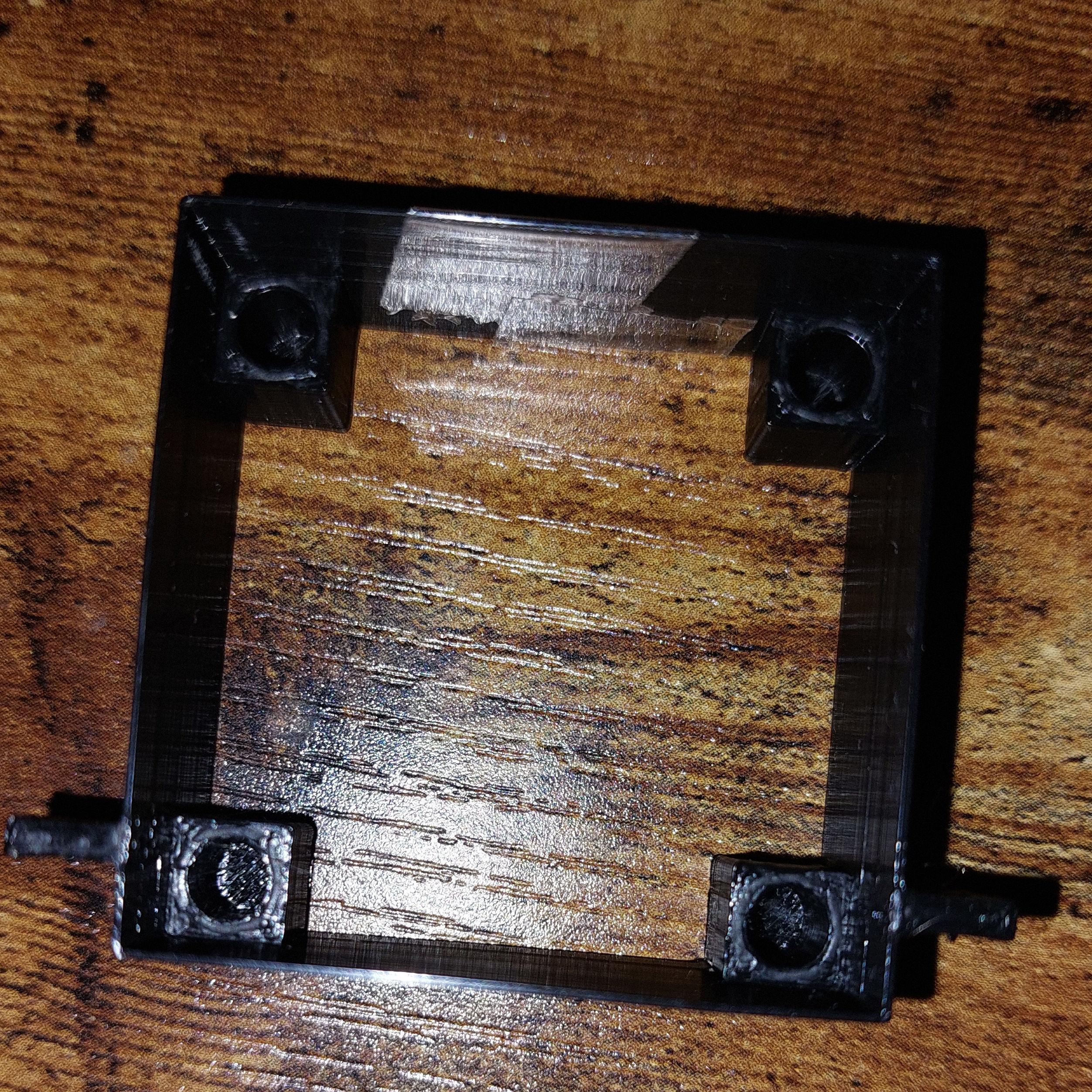

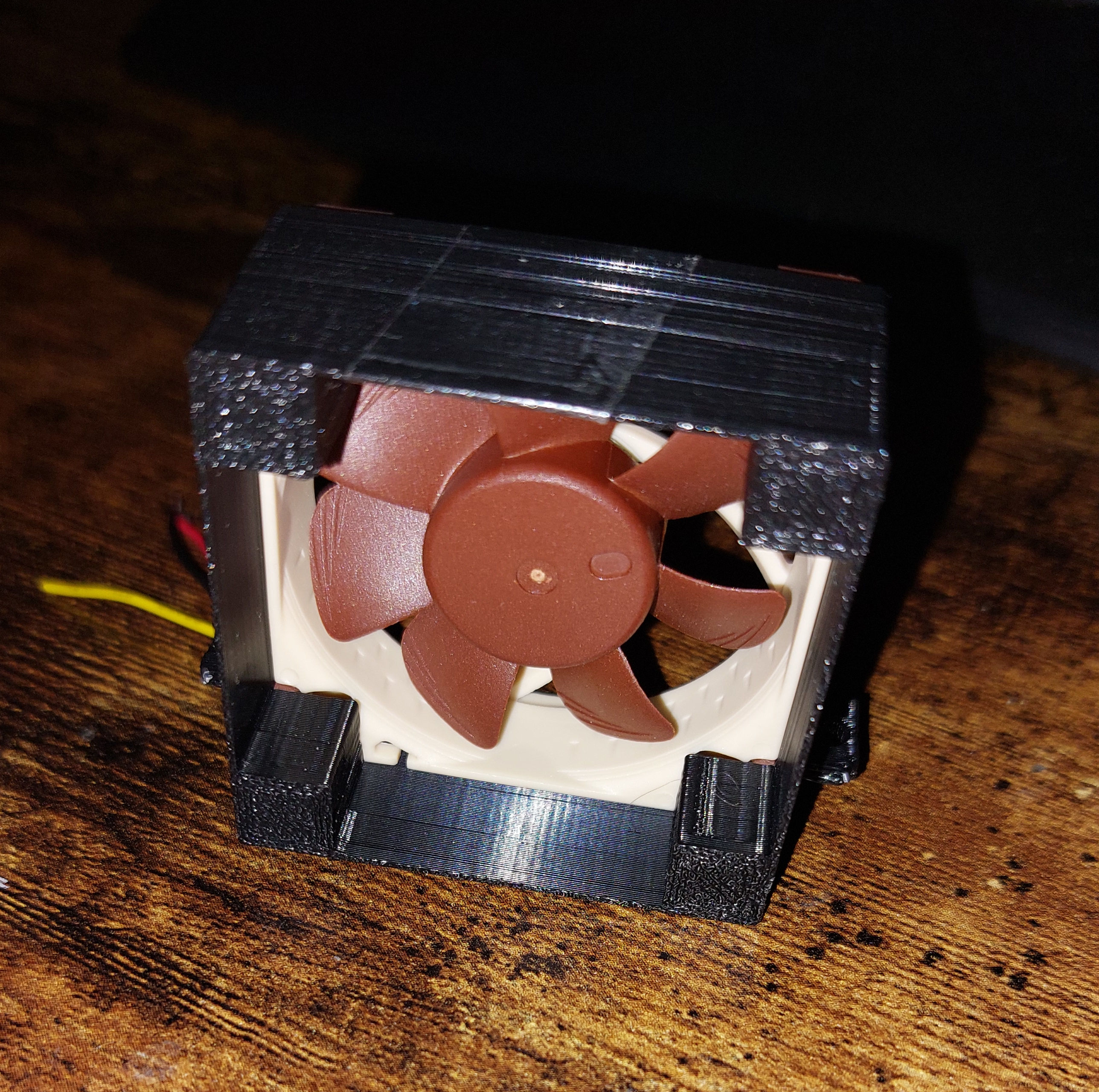

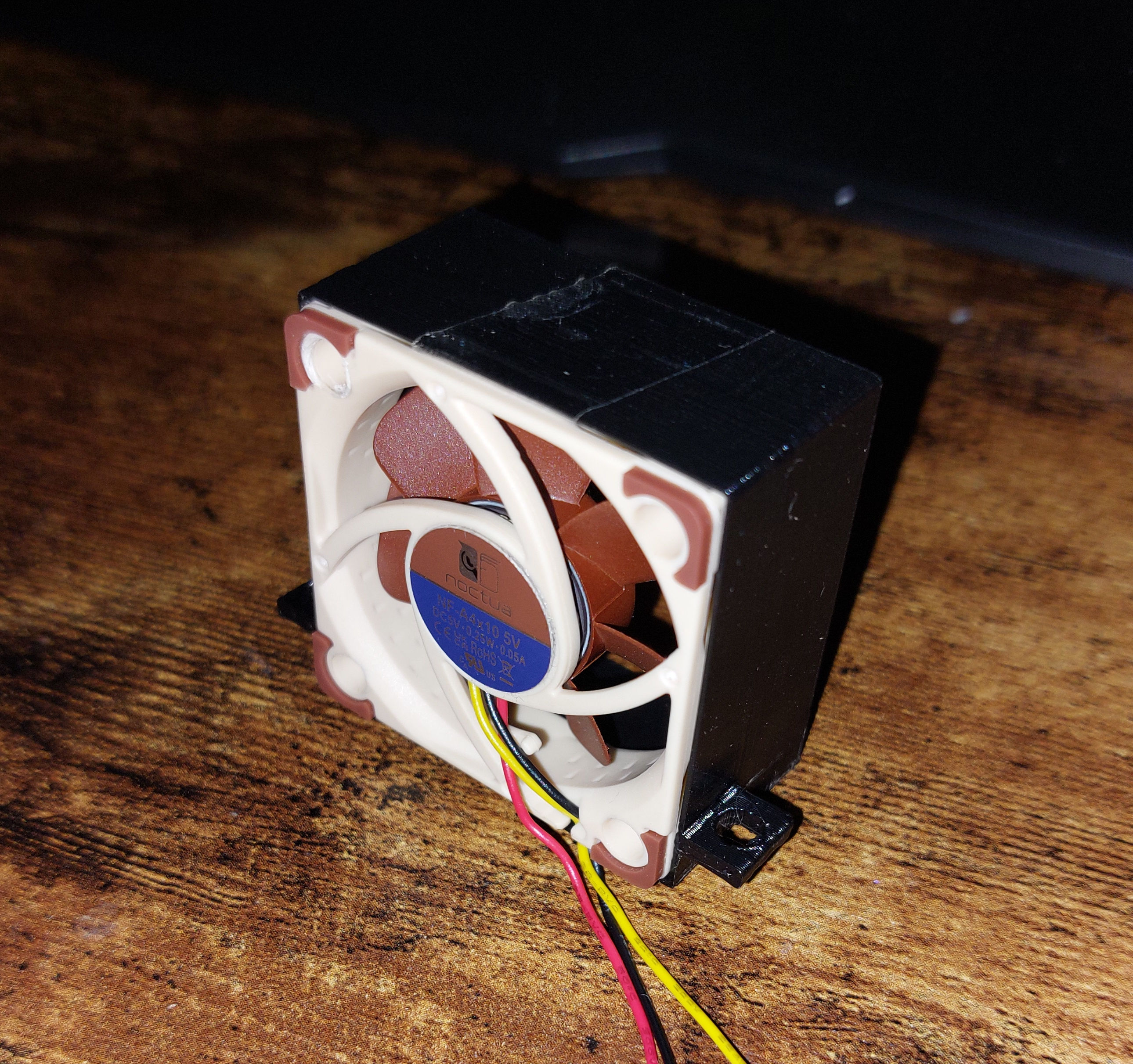

Well, I finally got my hands on a somewhat reasonably priced broken Wii U to further test the Noctua fan situation so here's that update I promised:
Adding a diode to the +5v wire of the fan did stop current flowing back into the system after a shutdown. That much was to be expected from it, that's what diodes are for anyway.
I turned the console on and off about 20 times now just to see if anything breaks - thankfully it does not. As one is able to tell by looking at one of my previous posts the Noctua fan is smaller than the stock fan, so I created a little mounting bracket that can be 3D printed, I'll attach the STL file for it here.
It's probably not worth mentioning since it probably didn't have an impact on the last Wii U dying but I didn't connect the RPM control wire of the fan this time, only +5v and ground. With all that said I guess the fan mod can be considered safeish to perform, just add a diode to be extra sure of it. Now let's see how long it'll take me to find a used Wii U in working condition for an ok price, I'll be having a working Wii U with a Noctua fan no matter what.
