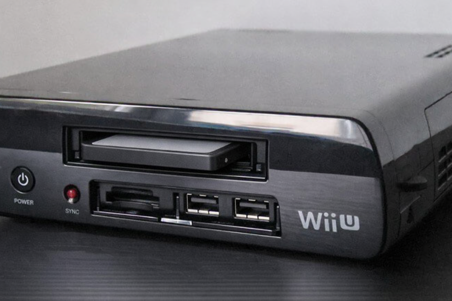

Can I have have internal ssd mod (256Go) and hdd in the same time on rear ports ?
I am testing right now but it seems that my ssd M.2 SATA don't want to get power (if my joints are ok)...

So up picture is for rear ports and down picture is for front ports ?
Yes.
but have 1A on one port availible, which is more than the USB3.0 Standard wants
There are confirmed cases where 1 A wasn't enough for a HDD.
Also you forgot that your solution would still share these 1 A between the two ports. So you couldn't use two HDDs, one for Wii U and one for vWii, for example.
So you still have the OCP
A lot of people did the mod now and all Wii Us are still alive.
