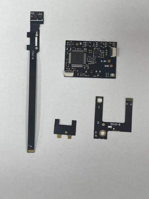

Hi there, I ended up ordering this particular HWFLY OLED modchip, in retrospect it was probably a mistake as it doesn't seem to have as much documentation as the other OLED modchip revision that I am sure a lot of you would have seen. I've got a few questions:
1. does this chip have the 0.2 spacecraft-nx firmware that resolves the issue with it sending incorrect voltages?
2. Would I be able to verify the firmware version via dumping boot0? I have purchased an st-link programmer, what would be the best way to hook it up to this chip.
3. is it possible to flash this with Mena custom firmware.
I've heard that this chip is particularly "bad", in terms of quality, although I ordered a separate dat0 emmc adaptor as there have been stories where people have used that particular OLED dat0 adaptor and its caused issues with the emmc, possibly its broken off and shorted something. I would very much appreciate an answer to this as I am new to this. Thanks.

1) yes, although the issue might not even be an issue at all
2) yes. dump boot0 through hekate. no stlink involved.
3) probably not, at least not right now. more research needed.
