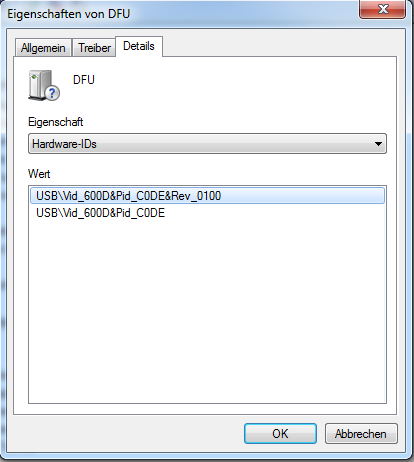

yes, update the driver for the DFU entry.
not sure if it's a win7 thing. shouldn't be.
Windows can't find any drivers on it's own.
Do you which I need?
Vid: 600D and Pid: c0de - as in Good Code?
This seems to be something custom, I can't find any driver online when I look for the VID/PID - that's probably also why Windows can't find them.
FR0ZN
Nov 2, 2013
1,393
37
3,914
None of these work - probably because non the drivers have the Vid: 600D and Pid: c0de in their inf files.
So Windows will never find it as a compatible driver.

I don't think Windows 10 will change anything here, because Vid: 600D and Pid: c0de is not a valid vendor ID and probably not a valid product ID).
Someone (probably the seller) modified the software on the chip to report itself as Vid: 600D and Pid: c0de - as in "Good Code".
So I need someone who can tell me which driver is installed on his PC for this device and modify it myself to include Vid: 600D and Pid: c0de

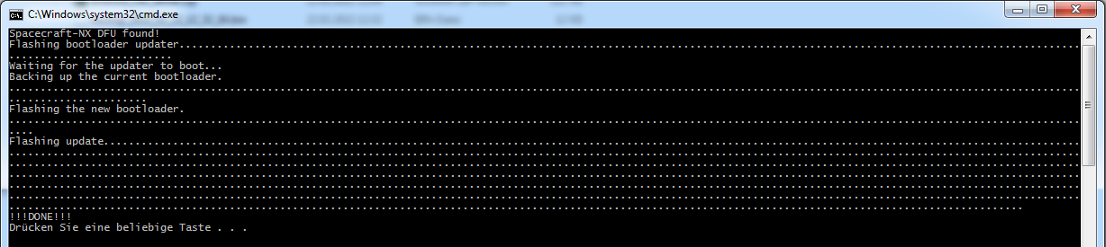

I modified the Android CDC driver and installed it - the modchip reported itself as "
MediaTek USB VCOM (Android)(COM5)" in the device manager afterwards:
So I ran flash.bat and it got this far:
After it said Timed out, Windows recognized a new DFU device with the following VID / PID: Vid_BAAD Pid_C0DE
So I modified the driver again, disconnected and reconnected the USB cable again - installed the modified drivers again and reran the flash.bat:
Looks good to me no?
doom95
Aug 12, 2019
303
24
785
Netherlands
yep. it uses a different pair of pid/vid for bootloader mode where we can rewrite firmware, and bootloader mode where even the bootloader can be overwritten.
nice work
